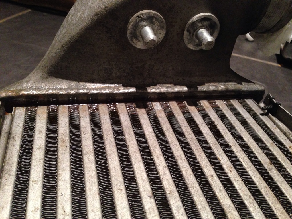

Is it specifically JB Weld or are there other brands I can use? I see they do a steel reinforced weld too, assuming from your pics you used the standard JB weld?

You need it too flow so it gets into where you want it too be and seal the cracks . I overflowed my tank ends with resin because I wasn't convinced I had got the leak totally .

I'm sure there are plenty other epoxy resins that you could use, but for me JB Weld does the job perfectly and remains ever so slightly flexible after curing, so it make it just right for this type of work. Other resins can set rock hard and brittle.

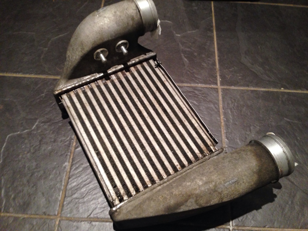

Both leaking, OS intercooler had a huge leak from the bottom right and was literally leaking with as little as 8psi running through it. The NS intercooler Again was leaking however this seemed more of a pinhole leak and it took over 20 psi to make it leak. Next step is to clean up/degrease both intercoolers and follow the guide to hopefully making them airtight.

This is the part you don't want too rush . They need to be spotless or the epoxy won't stick . Paint brush or tooth brush is ideal with a good solvent cleaner too shift all the crap out on there . Plus you can get high from the fumes which is a plus
