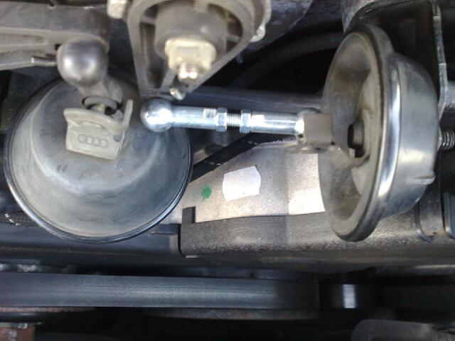

Also when my S8 felt slow ( and I hear this is a common problem), 0-60 was around the 8 sec mark. The con rod on the actuator valve had snapped. Once I replaced it (£140 from Audi) they don't sell the rod separately and you have to buy the valve with it, it transformed the car, now does it in 6.3. It could be this? You can check it by taking off the engine cover. I will post a pic in a minute.
P.S I managed to get a metal rod from America quite cheap so if anyone needs one I will check my old e-mails for the invoice and company web address. £35 Delivered and made out of metal not plastic like OEM so should last longer.

This is the valve, it is located by the radiator end of the engine. I know the C5 S6 has them and my 2001 S8 has these so I am assuming the RS 6 will too.
Pic 1 shows broken arm.
Pic 2 shows new arm.

i think that rod is to control the variable length inlet manifold. i'm pretty sure the RS6 doesn't have this due to forced induction.
