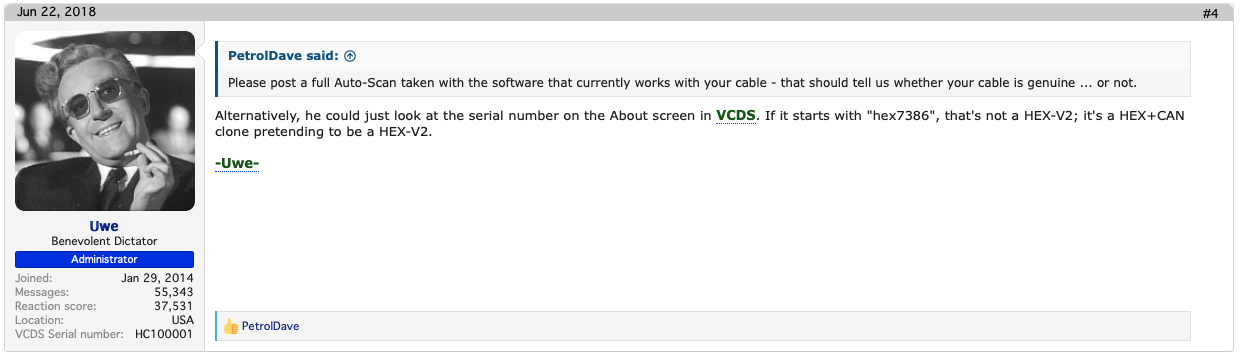

This is a most excellent outcome and I am happy to hear all is resolved regarding the authenticity of the cable - that comment from Uwe Ross, 'Chief Cook & Bottle Washer' at Ross-Tech really didn't help. As founder of VAG-COM you would have thought he would know betterandy28 wrote: ↑Mon May 05, 2025 10:03 pmGood evening all
I just wanted to provide an update as I have now heard from Ross-Tech and they have confirmed that it is a genuine cable.
My confusion was that I had spotted the negative clone comments about serial codes starting hex7386 (like mine) but the one I have is a genuine hex-usb cable and has a valid serial number.
I still have my error but I will get the cable transferred on their system so I can access their support.
Steve - apologies for messing you around this weekend. Once again, I really appreciate you doing everything you could to help me out and I’m glad you were right.

I agree Topman, it was those comments like the one in your screenshot that made me doubt myself. Uwe should probably say it could be a clone or a genuine legacy cable! I’m glad it’s sorted.
