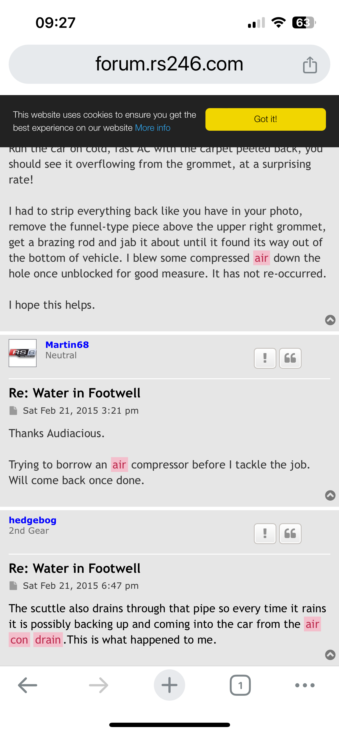

Can anyone confirm (or otherwise) that the a/c drain is in the passenger footwell on a right hand drive car.
Re: Carpet soaked.
THere was a thread recently with photos. I'll try to find it.

Many thanks for that Ben
I thought I had two leaks. Air con drain plus pollen filter housing wet.
I still don’t get it. How water gets into the pollen filter housing.
But apparently they both share the same drain ? So with a bit of luck sorting the a/c drain will sort it out.

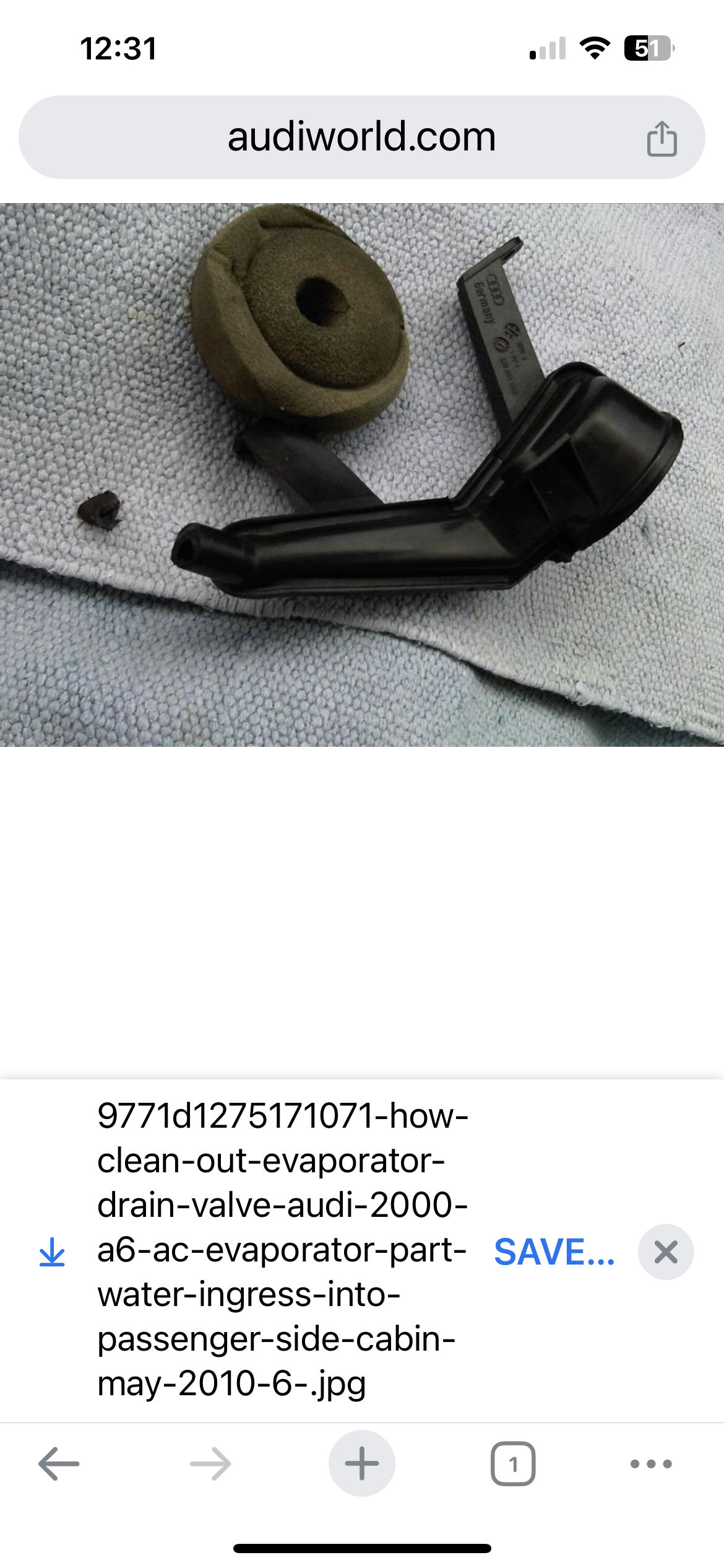

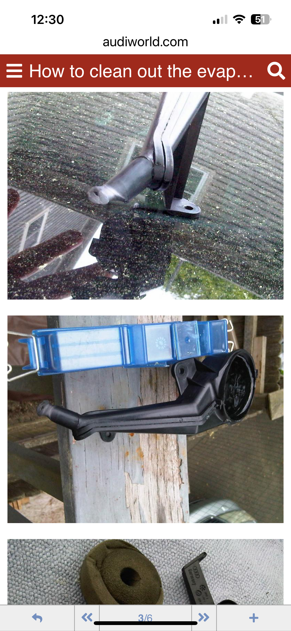

Just found another example of what can happen.
