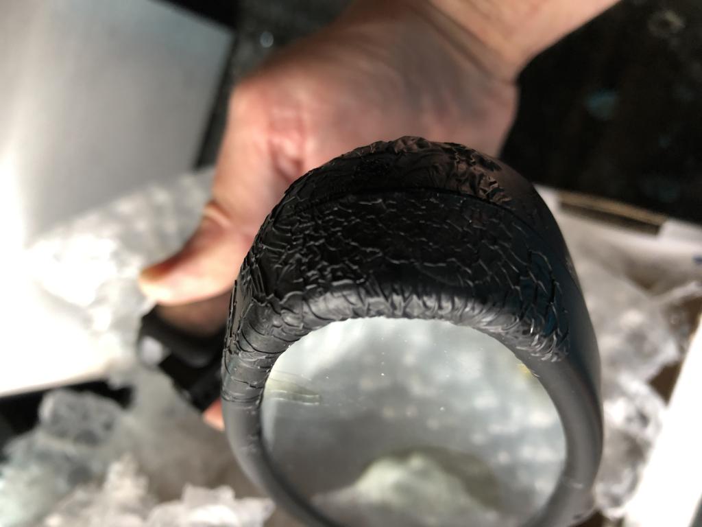

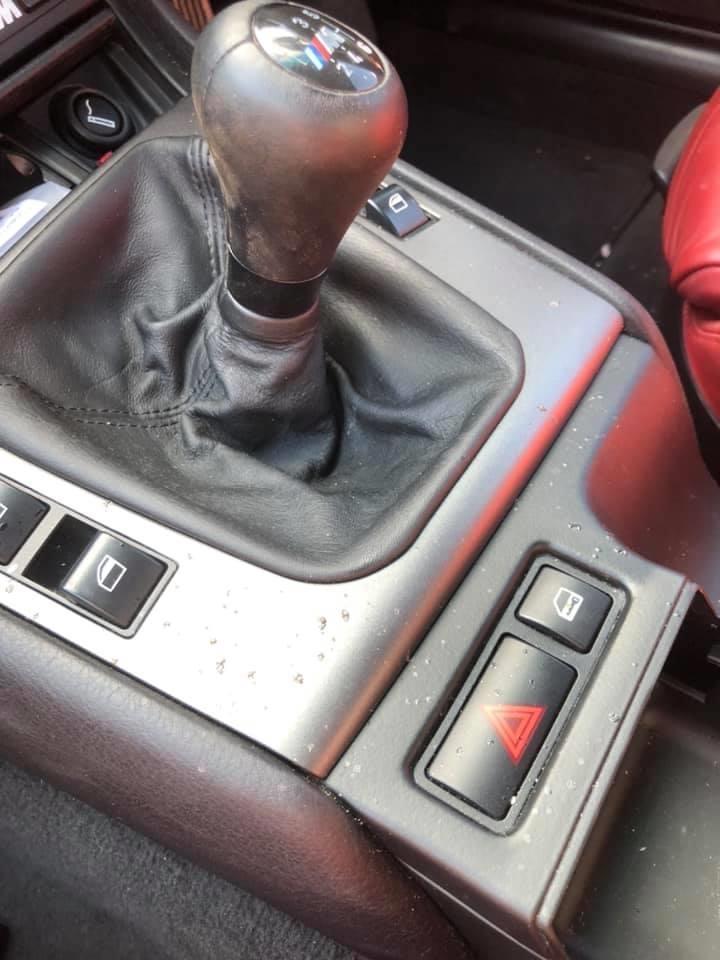

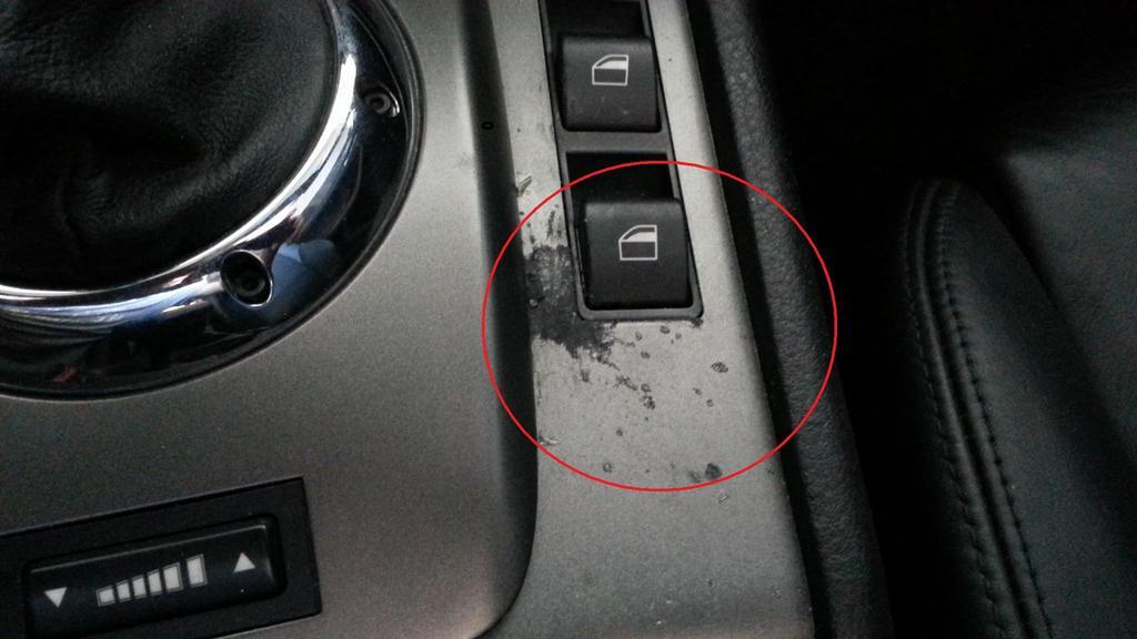

A customer's M3. You can see the spots where the fluid landed on the gear surround/buttons:
After getting his gear surround re-painted, the paint reacted badly and it needed to be thrown away and he purchased new. Costly experience for him!

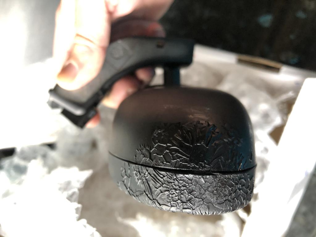

Even scarier. I received this M3 mirror in the post and it had leaked out on the way to me. The plastics were fine before it was posted. Look at the mess that the fluid made of the mirror casing when it leaked out:
That went in to the bin!

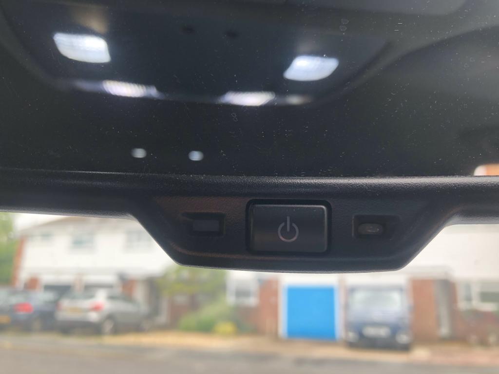

I’m new to this site and will have to double check on the rules but what I’m thinking about doing is setting up a full group buy open to other models rather than just keeping it in the C5 RS6 forum.
With that in mind do you know what other Audi models use the same shape auto dim glass as our car?
Can you please provide prices for units sold, eg 1-5=£x, 6-10=£x, 11-15=£x.
Just to confirm our rear view mirror doesn’t have the on/off button. The auto dim glass is still the same shape regardless?
