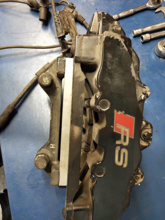

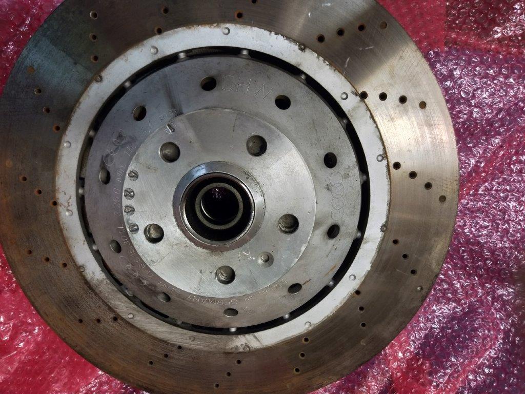

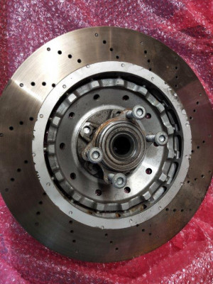

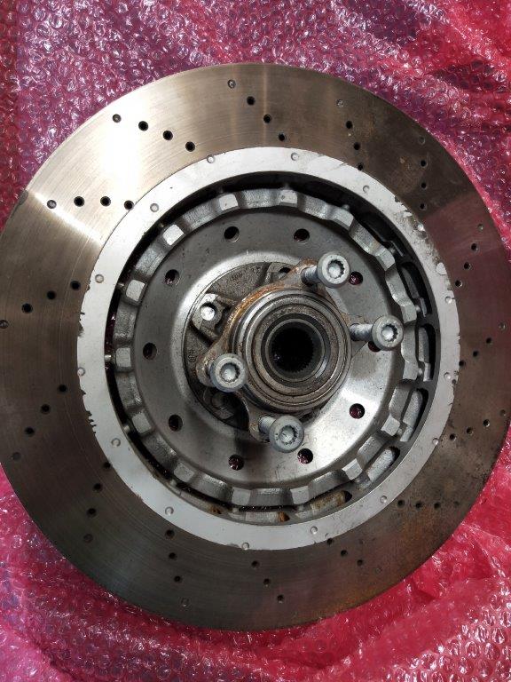

The spares car came with C6 front rotors. It has spacer blocks under the calipers to move them out. They are like new. Any feed back on what these are like on the C5?
Re: RS6 in pieces.
Move them out radially? Or axially? Are they C6 callipers? Not sure I have understood the question.
Re: RS6 in pieces.
The C6 rotors are a larger diameter.
Re: RS6 in pieces.
I know. I have them. They also have a different hat depth. So you have to move the callipers out axially but not necessarily radially.
Re: RS6 in pieces.

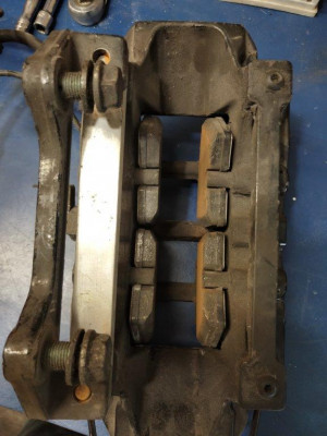

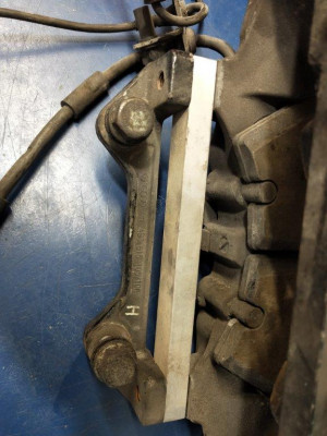

I will get some pictures of what I have and post them.
Re: RS6 in pieces.
I think you’ll find that there’s also a spacer between the hub spigot and the bearing housing to push the disk further out. I’m guessing about 6mm.
My OCD doesn’t like the pads only wiping a fraction of the disk surface. I personally would put it back to original. Or put C6 callipers on.
IIRC the C6 disks are 390mm. Maybe 395. My memory is fuzzy.
I think the thinking at the time was that the C6 disks were cheaper than the C5 ones hence the mod. I can’t see it bringing much performance increase without the bigger pads. These days with nice cheap Zimmermanns and Pagids it seems like more effort than it’s worth.
The C6 pads are a bit cheaper, but the callipers are pricey.
