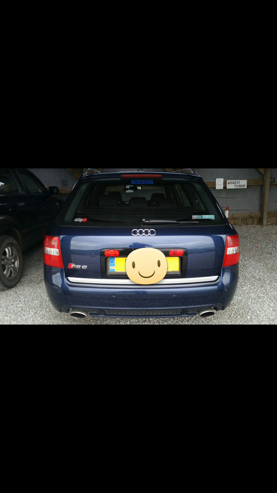

Just an update. I ended up getting a VW Transporter as a courtesy as I am moving house so thought it would save me renting one. I'm happy with the paint job but they left one parking sensor not repainted but they said they will do it in a couple of weeks when paint is settled. That's fine as I will probably get another one done on the front. I keep looking at the badge on the back and maybe it's my OCD but it may not be exactly right. I guess there are measurements somewhere for the exact spot if anyone can help?

The rings look too high are they not ? .

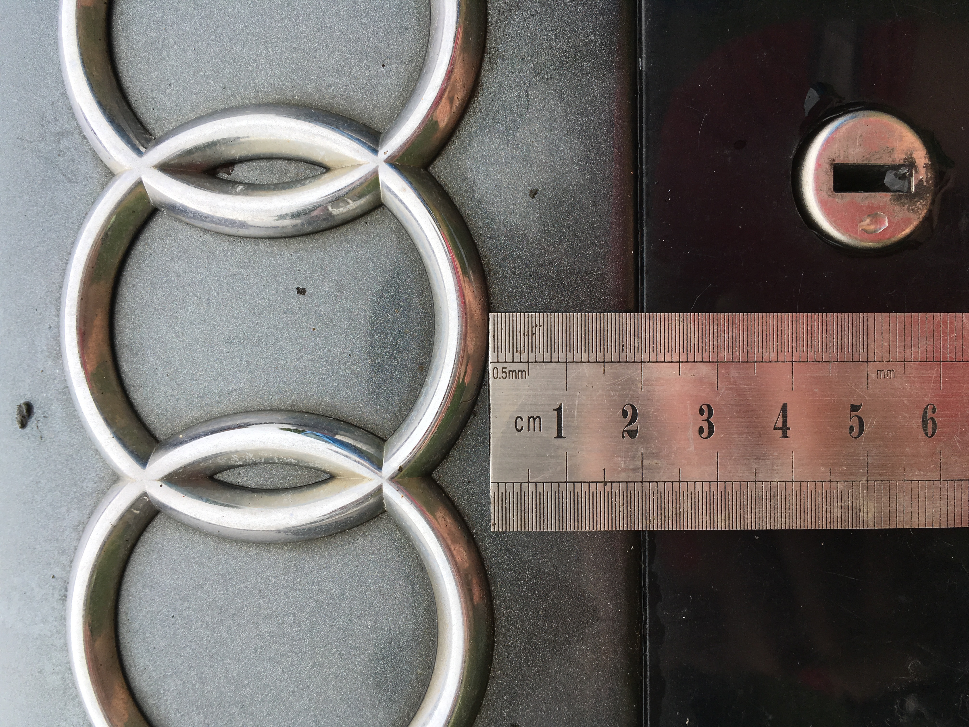

Just had a measure of mine - looks like the Audi rings are 20mm from the bottom of the ring to the non metal bit!

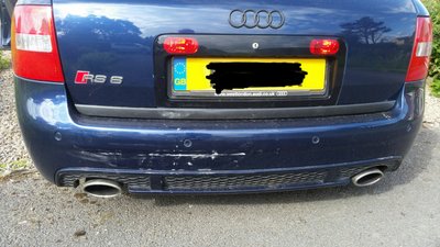

Bloody hell I was on about the RS badge but now it's glaringly obvious it's the rings! Def too high, would it be easy to move them or ask the bodyshop to? Check out the before..

They're stuck on with double sided tape and the rings don't flex at all so you're more than likely to snap them if you're not very careful.

Try waxed dental floss to remove it.

The position of those rings is a bit of a shocker.
