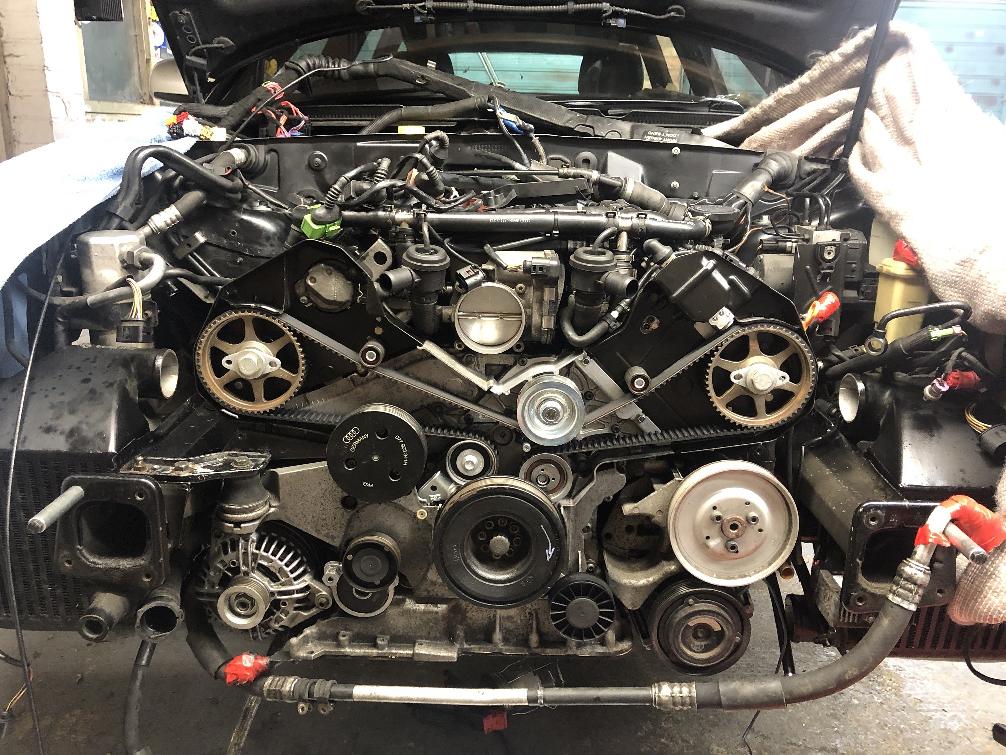

Re: RS6 Timing belt replacement DIY
Nice photo.
Out of interest, what do you do about the AC gas?
Just take it to a local place that's got the correct rig to vacuum, recharge, and add the correct thimbleful of oil.

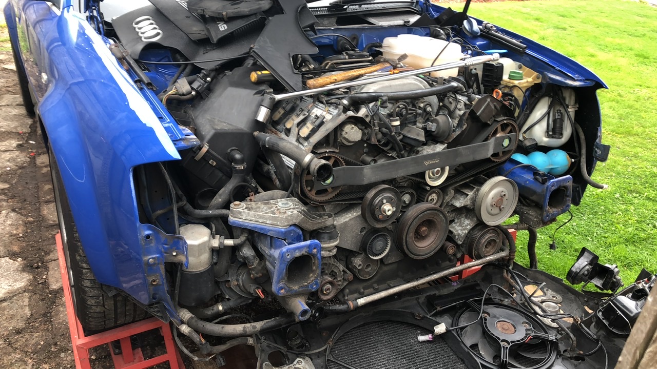

I know mines just an S but I’m pretty sure you can do the same and just lay the carrier down on a milk crate or something similar, keeping the A/C and oil cooler lines connected.
I didn’t know about the second tensioner requiring the VAG tool, which for reference is very cheap from the dealers or TPS if you can get someone to order it, so with the car in bits I tried to guess it which didn’t go very well, timing ran but it was miles out 14 degrees iirc, I got the tool and used it with the carrier in place as on a S6 its a lot easier, I used a 5mm Allen key to measure the gap, but it was still a faff.
I found the easiest solution third time round and it was to set both tensioners at the right point, then nip the cam sprockets up and turn the engine over a good few times until the belt has settled, double check your 5mm gap and leave both tensioners still and don’t disturb the belt, I used the locking bar to hold the cam still and undo the bolts then hold the puller still whilst popping the sprockets off the cams, then reset the cam timing with the bar using it to turn the cams if necessary then slot the bar in and tighten the bolts back up.
I got it bang on “0” this time and it was a lot less faff.
Why they used the two tensioners is a pain as the 2.7tt engine is practically the same layout with only 1 tensioner and it’s a lot easier to get it first time round.
Yeah. I did the same. Set it all up, spin it over a couple of times and then retweak the sprockets so the bar is super slick with the TDC bung in position.
