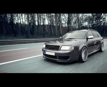

Doubt it makes 600+ hp, but its probably going towards it...

That's the baby...mavada wrote:Doubt it makes 600+ hp, but its probably going towards it...

Looking at that .gif that Mav posted, it seems the answer to speed is............... no fog lights
