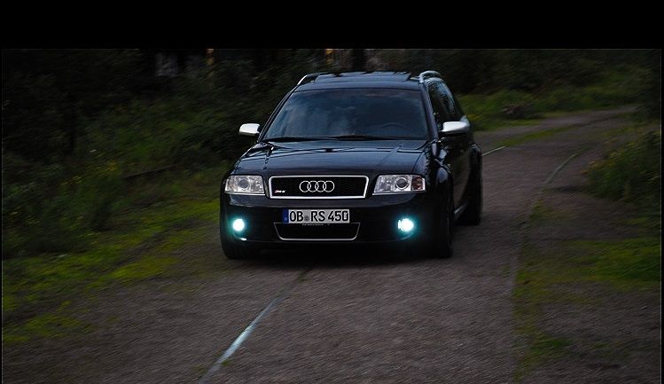

Thanks Mav ... exactly the look I'm after - though in Misano of course!!
