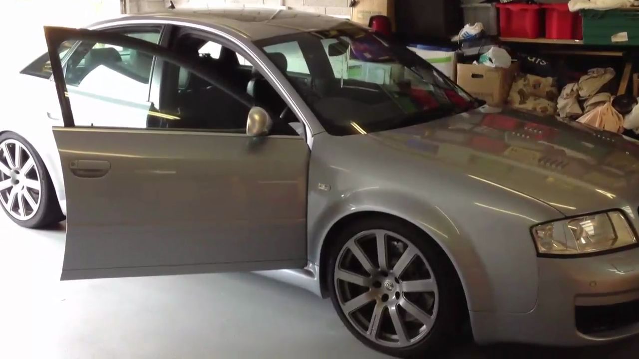

Have a view of this quick video below which hopefully shows my problem a bit better. I will try activating limp mode later (by revving a while) and see if I can pull the car back with my other car. Im on my own at the mo so I cant do it right now.

Re: Gearbox locked in gear
Have you been able to move the car forward? Even a little bit? I'm thinking of the binding brakes...
Checking out your vid now.
OK, the revs go up to 1500. Is that you who stops there or do you feel resistance? I'm still thinking of binding brakes...
If you jack both rear wheels off the ground, can you turn one by hand?
No, the issue isnt the brakes, its the gearbox. I will make another video now, showing me rev right up to 7,000RPM, with the same result. If it goes into Limp mode, I will try to push it back. I havent tried jacking the car up. I know there is about 5 mm movement between the brakes and the discs as I rock the car back and forward. But then its like hitting a brick wall and it will not move any further (gearbox locked in gear methinks).
