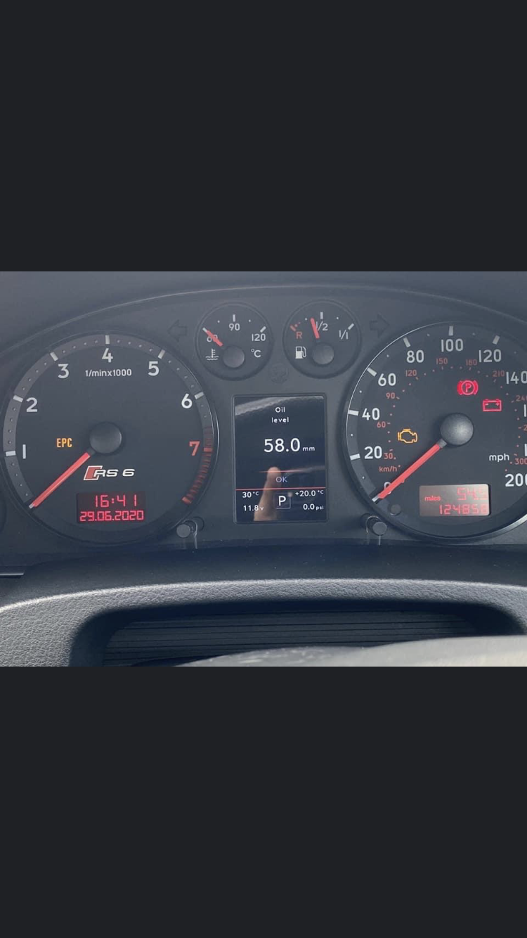

- Posts: 2955
Re: Instrument Cluster
Shop. Wiring checked out ok. Noticed that no backlight illumination on the switch as well.
Also the thumbwheel light adjuster works on the dis display. Can fade or increase the intensity

- Posts: 2955
Hi Chris. I did see a fellow member on here had a “coloured” uprated screen fitted. Don’t know what type. Yes looks good in the photo.
Pleased you don’t have to do this very often. It’s a pain. But pleased I no longer have to look at faded/missing pixels.
Hopefully get backlighting sorted this week.
Love VCDS but today showed me how much a novice I am with it.

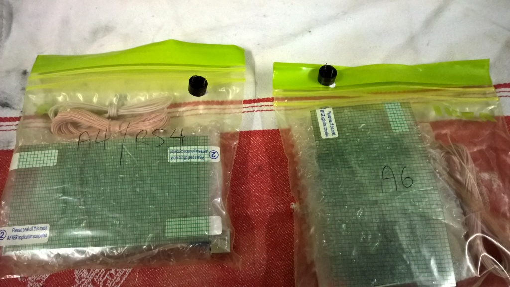

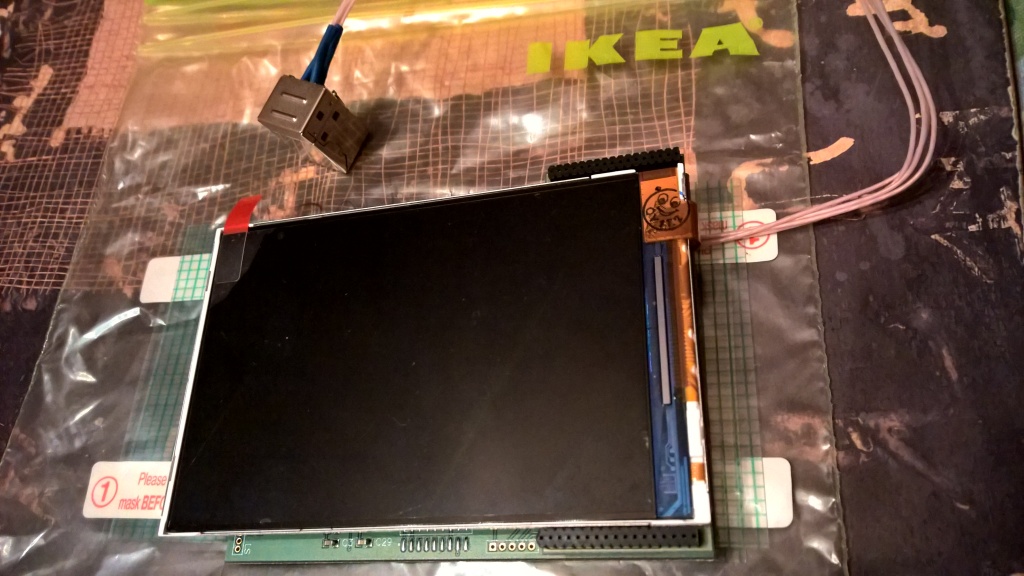

- IchBautAuto
- Posts: 618
- Joined: Thu Feb 20, 2014 11:23 pm
- Location: Australia
Got two of those, one for the RS4 and one originally for the allroad. I understand that the allroad one is a slot in for the RS6. Just that I have new DIS on both cars and have been waiting for the DIS to start playing up before changing them out. Memory is a bit dodgy but I remember them coming from Russia. The ones that I have seen fitted have looked fantastic.
