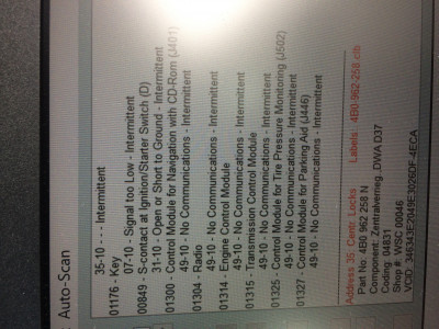

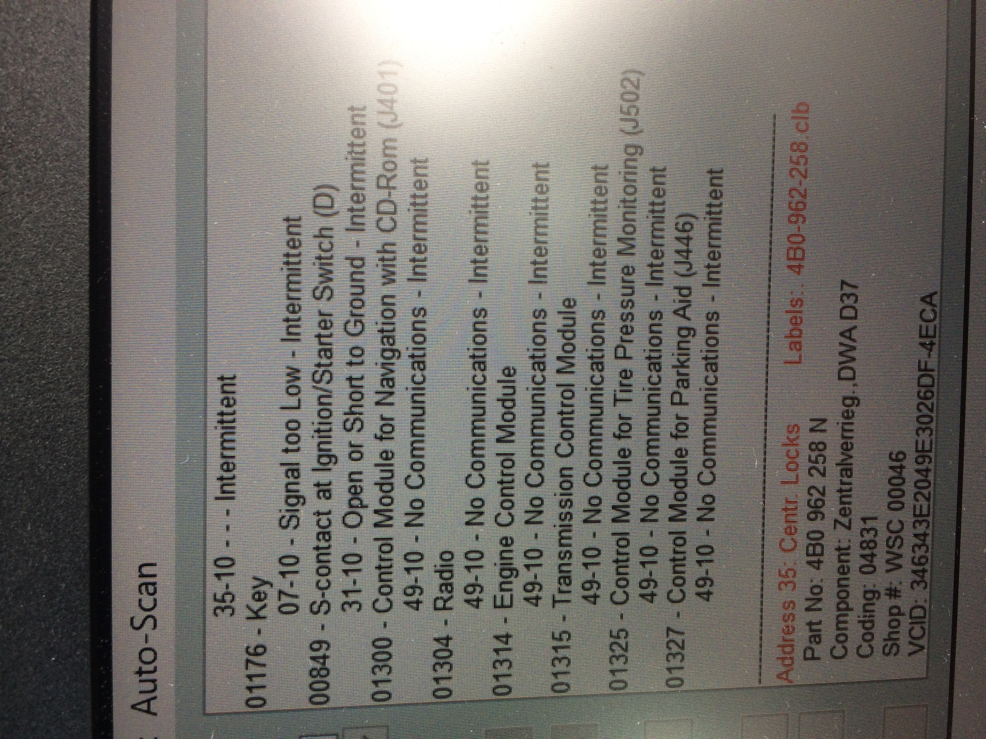

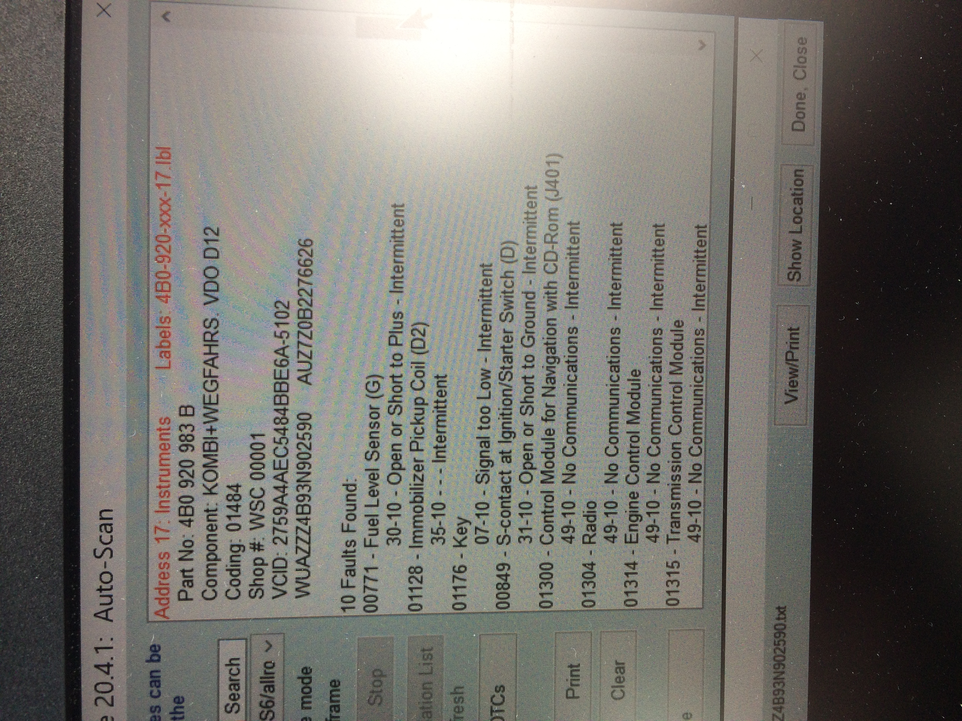

This is a new error since replacing the original cluster with new dis screen.
Re: Instrument Cluster
They’re all intermittent and probably due to unplugging the cluster. Clear them and see if any come back.

Hi Shop. You were right again. Ran autoscan and all previous faults disappeared. Didn’t need to delete them. They were not there and no faults found was recorded.
