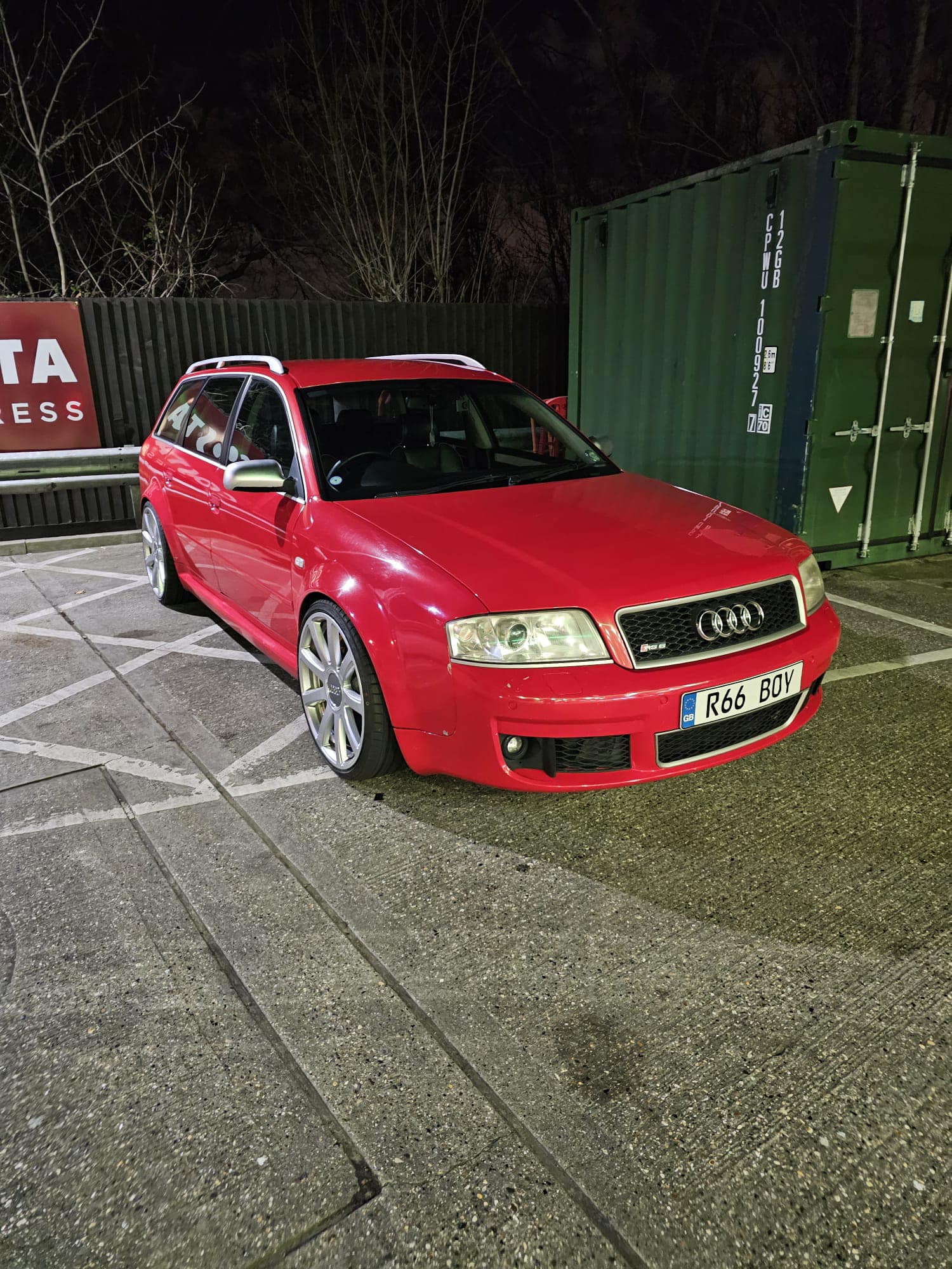

looks like i forgot about this topic but anyway shes alive and doing well,mapped to 530bhp and 800nm with dyno print,did like nearly 20k so far and had not much issues,put some h@r collies,then last summer fitted kw3 then switch back to h@r which i prefer,too much time to set kw3 and im dont doing any track days etc so decided i dont need them,had interior swap for black ones,flat steering wheel fitted,2 years ago i did convert headlight to biled projectors,last summer while we went to poland rear bearing failed on one side so replaced both,2x abs sensors and both cv joints and thats it really,using car few days a week and enjoying driving it.

as Simon said its 3d colour,had this fitted to my rs6 and also to my rs4 b5,not cheap but make it look modern,also you can read and delete fault codes

thanks Steve.Had rs6 c7 wheels for over 2 years and was bit bored with them,a8 multispoke suit era of car and they looks very oem,but i think c7 wheels worked very well in c5,also had b8 rs4 wheels for a day,didnt like them and sold them next day

yes sir,1st one was c7 rs6 9,5x20et21 fitted with conti6 245/30 and a8 multispokes are 9x20et46 with nankang as-2+ tyres 245/30 also.Fitted with 30mm spacers then dropped to 20mm front and 25mm rear.Went to north london on saturday to pick up some audi cantonas 8,5x20 but in England 98% tyre fitter cant do low profile tyres,in the end wasted day and back home with nothing
