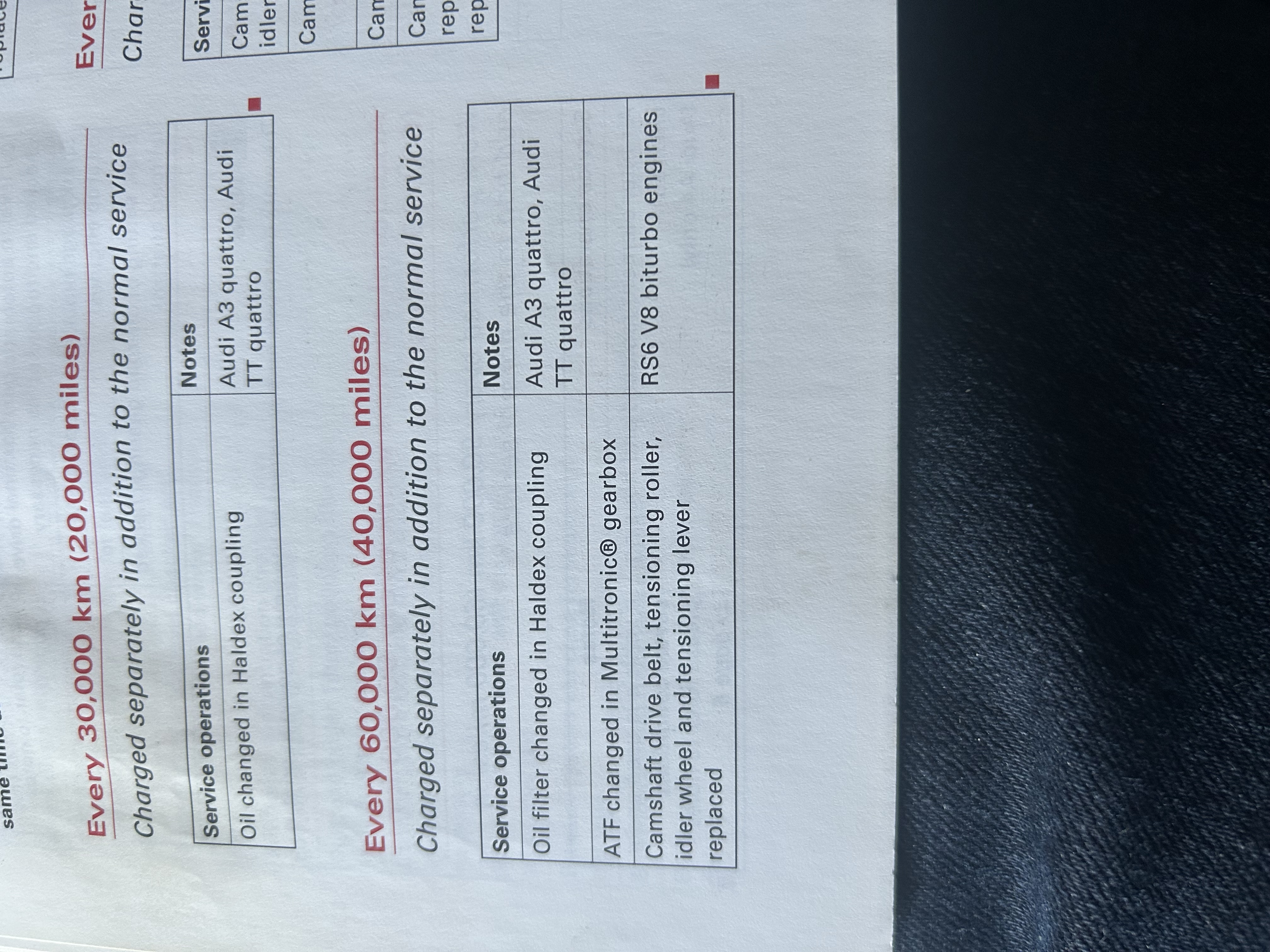

Post by steve2003rs6 » Fri Jun 13, 2025 10:09 pm
Hi Suz.
I would just add. I also do the thermostat and extra roller that’s not included in the kit every time I do the timing belt.
Good point on water pump. To date I have not removed a pump with the plastic impeller. Mine have all been metal.
Unit 20 have done my Cambelts and water pumps.
Hi allroadadi
I wish it was 10 yearly or 80000 miles. I stick to what it says in the service manual, 4 years or 40000 miles.
So yes mate. My car has had 5 Cambelt/water pump changes over the past 20 years.
If you are doing yours 10 yearly on a RS6 C5 I recommend you change it pretty damn quick.
As to what juice I am on
12 year old Macallan
allroadadi
Posts: 47
Joined: Thu Sep 05, 2024 1:25 am
Re: Looking at buying a 2003 RS6 - a couple questions
Post by allroadadi » Sat Jun 14, 2025 3:33 pm
I have 3 service manuals, one on paper and 2 different online versions. The smallest timing belt interval I can find on a 4.2l is 75 kmiles on 2004 models. They don’t specifically mention BCY or rs6, so maybe in UK/Europe is different.
Up to year 2003 on the 4.2 L and the majority of engines sold here: varies from 80 to 105 kmiles.

It’s your car Adi. If you want to do the Cambelt and water pump at 10-11 year interval that’s up to you. Surprised there hasn’t been a bang and a fooked engine after 10 years.
I will stick to the recommended 4 yearly or 40000 miles interval.
I would hate myself if I ruined the engine because of a failed Cambelt
I do know some members with low annual mileage push the interval to 5 years. That would be my absolute max.
