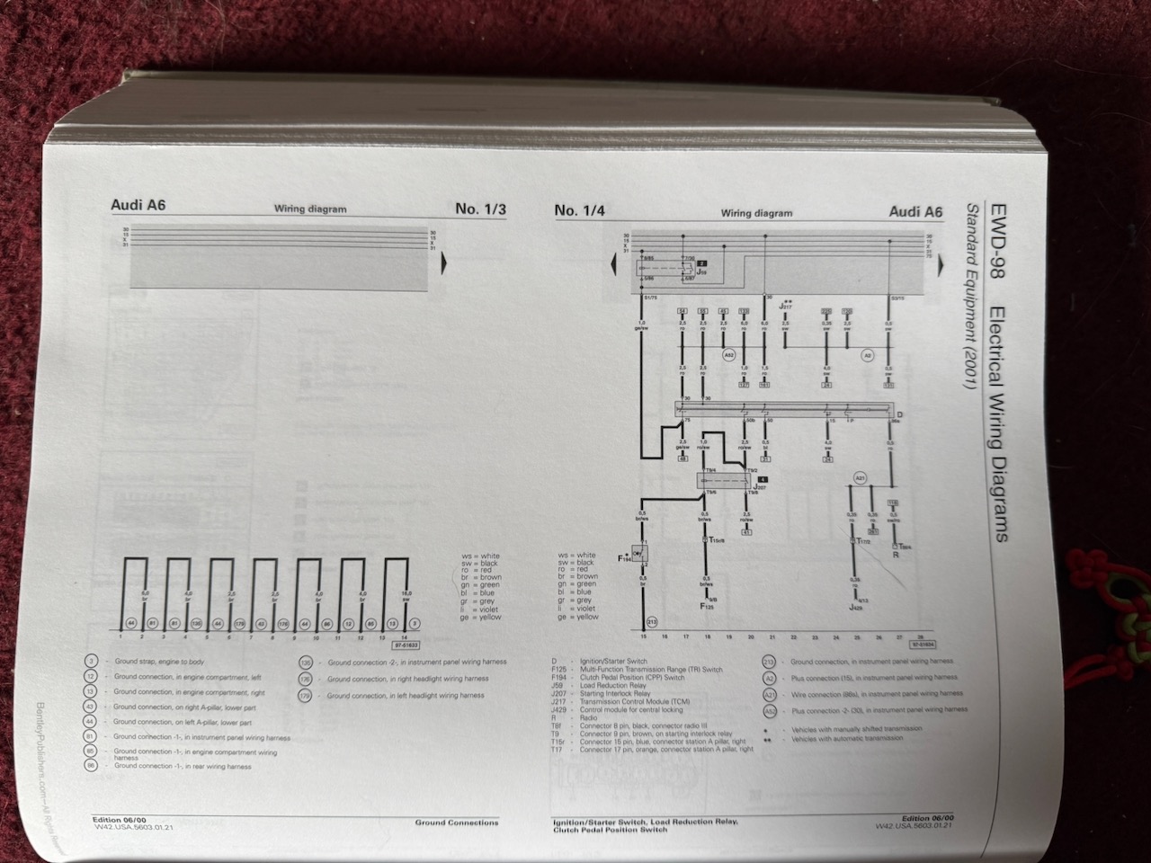

Couple of wiring diagrams in the Bentley manual that might help. Looks like there are a lot of earth points to check.

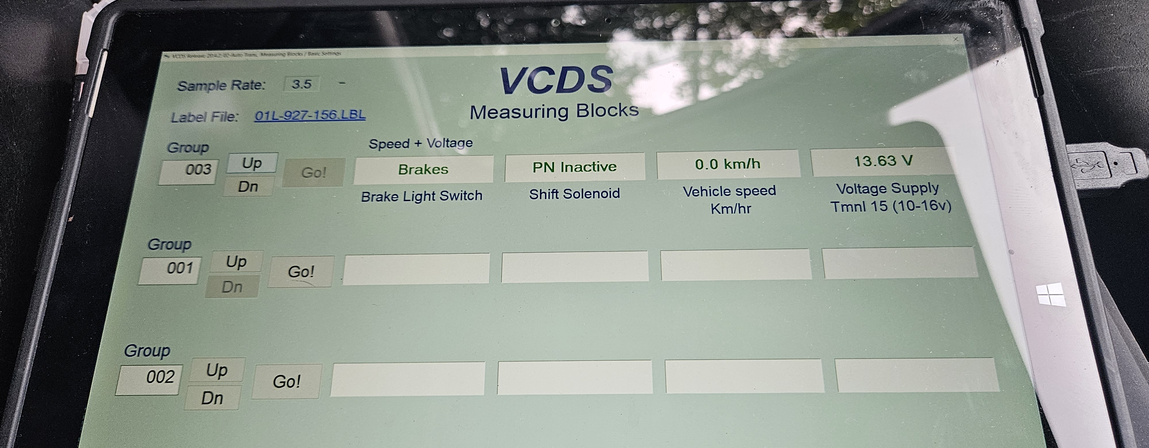

This fault code is to do with the power supply to the solenoids so I'd check that the TCU is getting the right voltage first since they get their power from there. Measuring block 003 will tell you the supply voltage. If that looks OK, I would check the 16pin connector to the valve body for corrosion / damage.

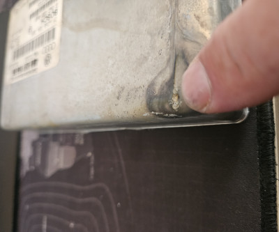

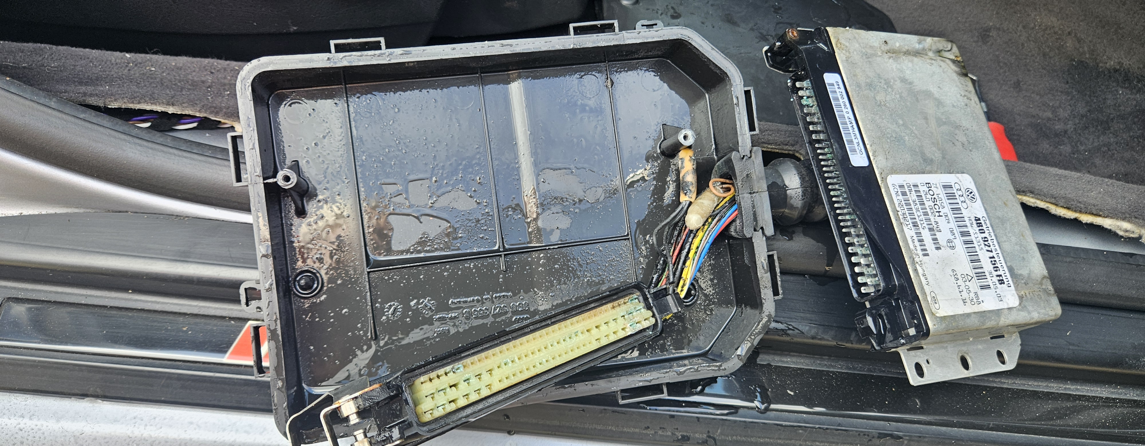

Wouldn't be surprised if you find water ingress to the TCU under the carpet. My money is on that or corrosion on the 16 pin connector.
Audi and their positioning of delicate electronics in the dumbest of places...
Re: 18155 - transmission solenoid power relay

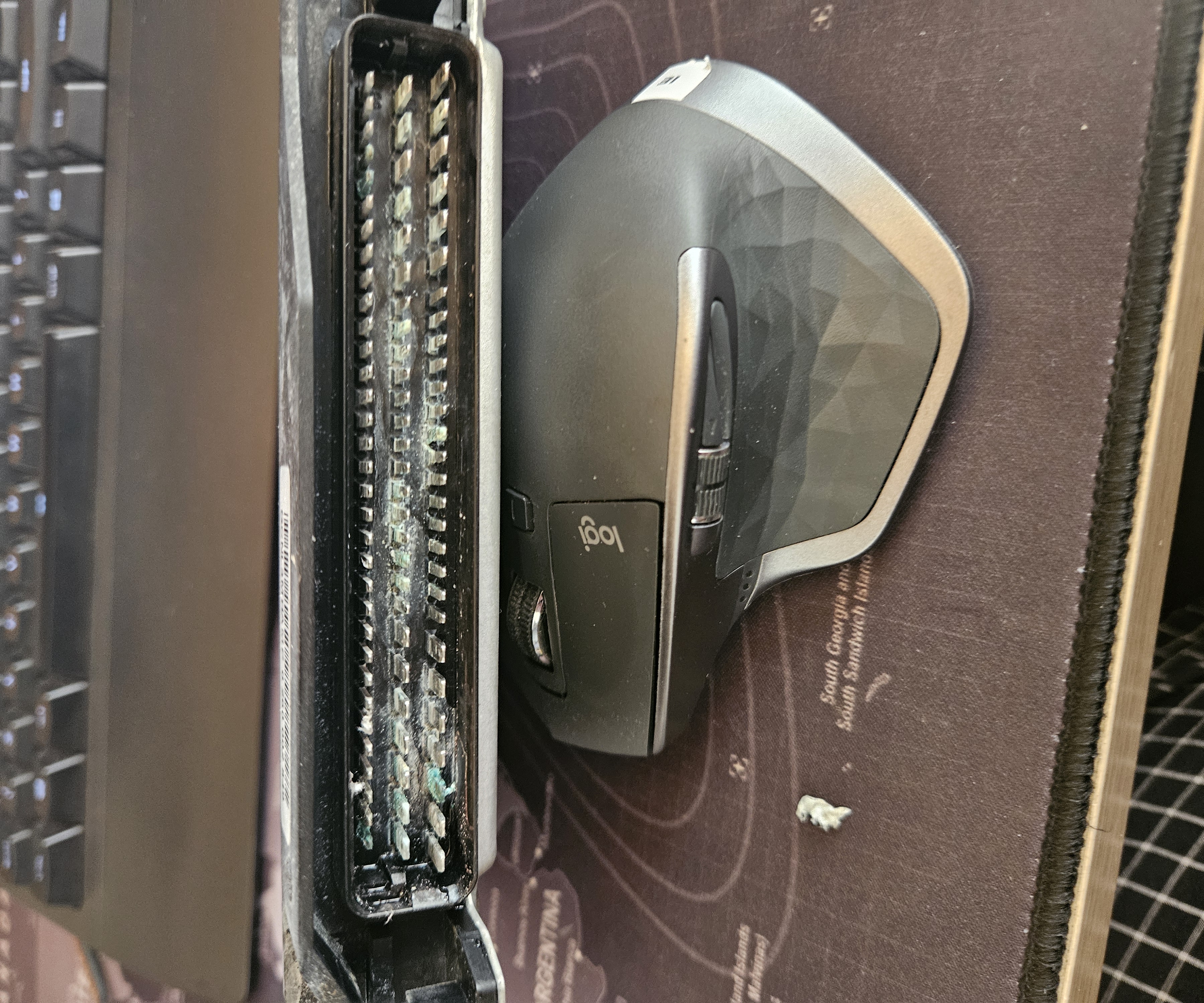

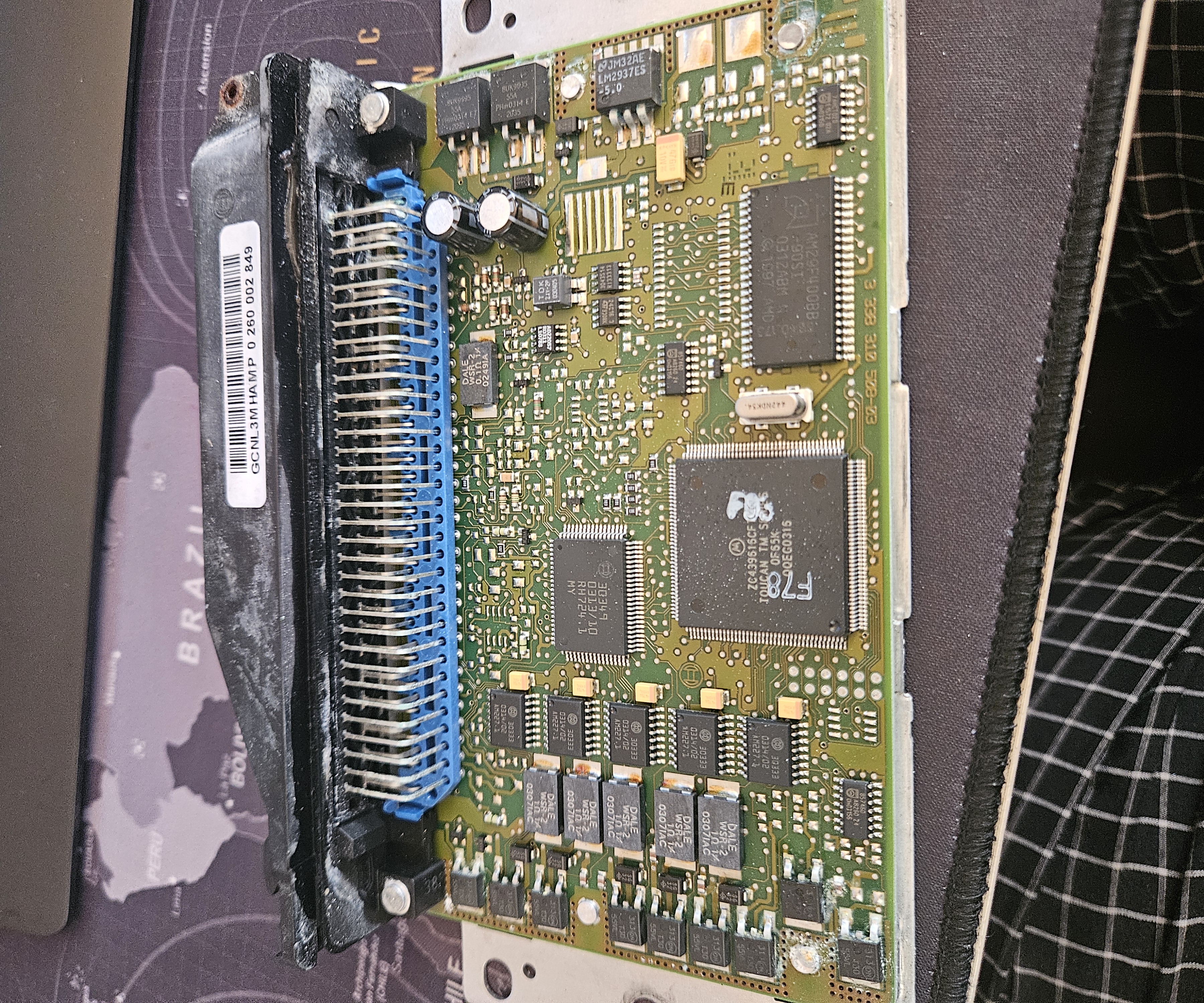

Inside of TCM is dry .just some green corrosion on connector pins but internals look fine
Will clean everything ,dry out foot well ,refit and test and will report back
What do I win?
If it were me, I would wash the lot with isopropanol to get the water out and let it dry thoroughly. And clean those contacts as well as possible with a tooth brush and isopropanol. Same for the mating connector.

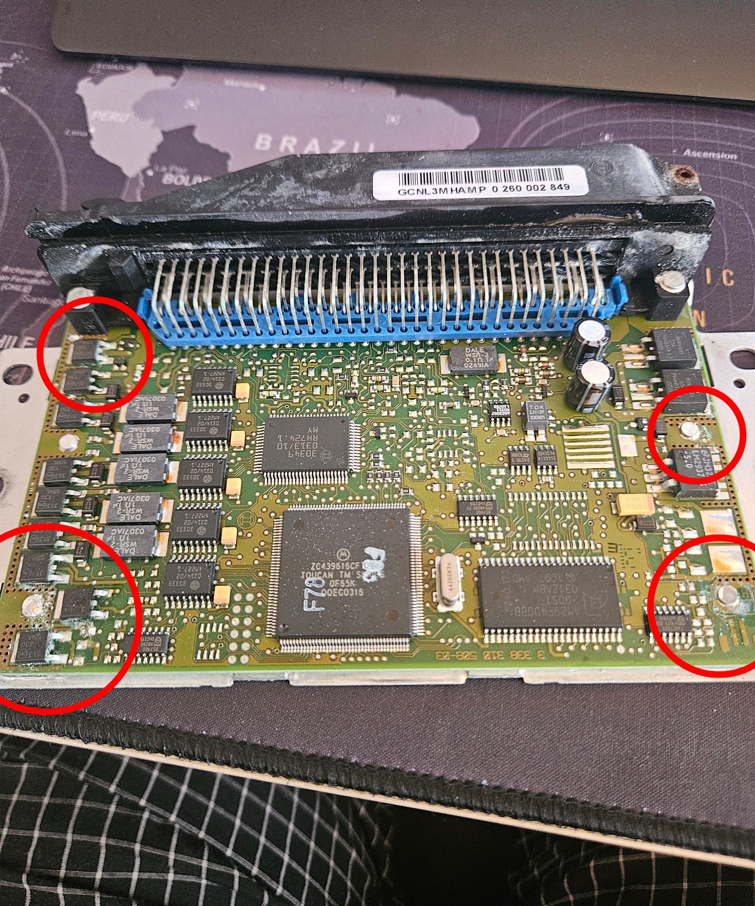

I'm seeing a lot of corrosion on the PCB. You *definitely * want to clean that off and hope that it hasn't weakened the solder joints.

Cleaned the TCU PCB and the connector pins with my graphite pencil
Even depinned any connectors from the plug that had corrosion and cleaned them Refitted the TCU nad went for a drive
Gearbox was faultless , before this reverse would be very temprementle and would work 1 in 5 times , all gears were selected no problem and the gear box performed flawlessly

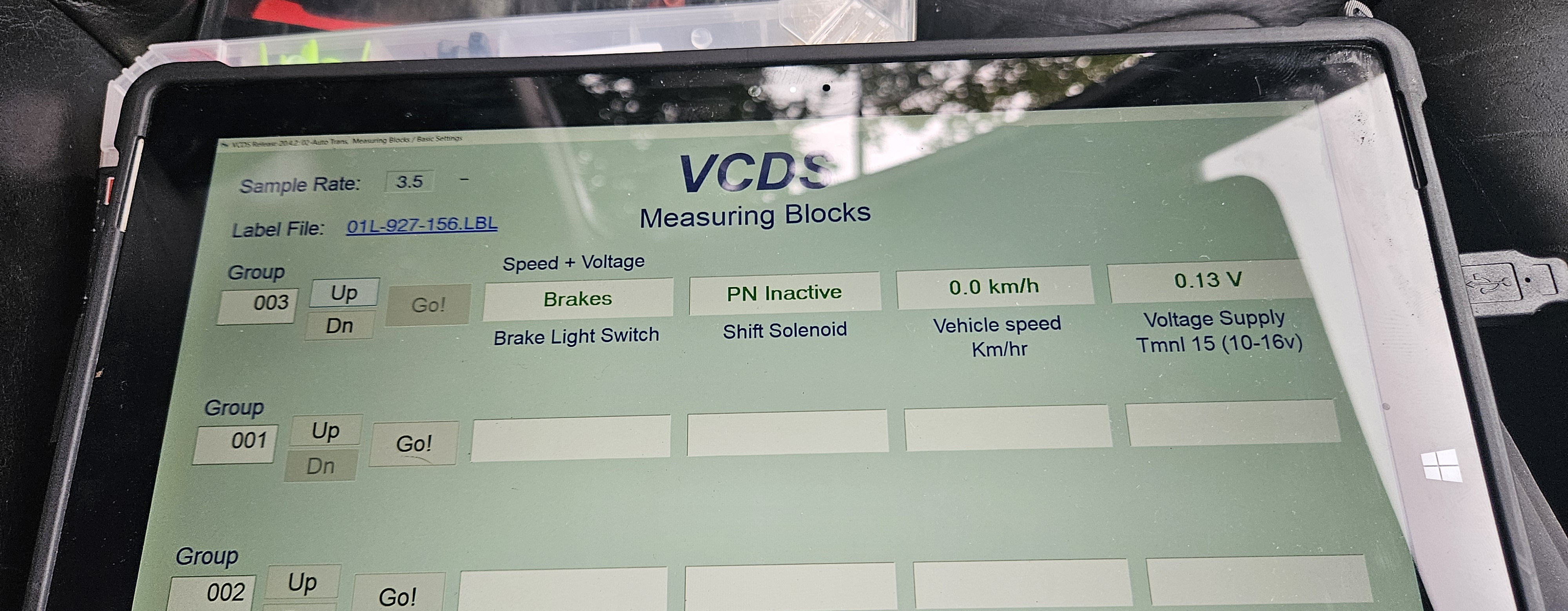

Block 3 was showing 13v Testig some other voltages while on the drive However after about 20mins the Gear display turned red and the same code appeared , power to solenoid relay

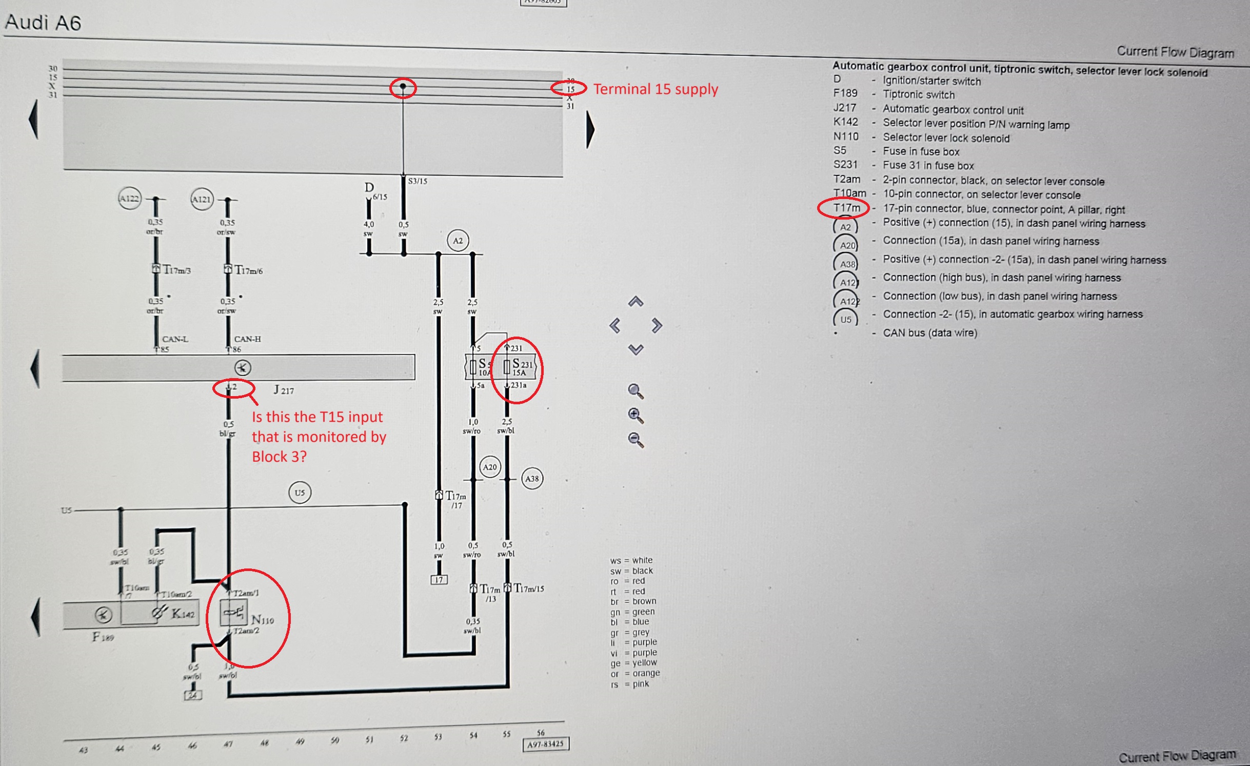

Now block 3 showing 0v So I need to find whatever block 3 is referncing which it looks like its supplied by Terminl 15 under the dash on the drivers side ,i have found Terminal 30 but not 15 yet , I have found another wiring diagram this afternoon so I now something else to look for , need to look at possibly pin 2 on the TCU which may be the feed from Terminal 15? Does anyone know what supply Measuring Block 3 is referencing??

What you've highlighted is the output to activate the gear lever locking solenoid. The power for that comes from S231 via T17m, pin 15. The TCU then allows the current to go to ground to activate the solenoid. I think you want to be looking at the one next to that, coming from T17m pin 17. That goes to pins 54 and 55 on the TCU. I suspect this is what is being measured in group 003.
You definitely want to check the T17m connector. It's probably had a bath, too.
I'd definitely clean the 16pin connector to the valve body, too. And the one to the F125 for good measure.

It was the T17m connector I was trying to identify , do I just follow the TCU lom to under the dash?
im getting back on it tonight ,I have seen the two black wires going to pins 55+54 , they are joined together just before the TCU conector with another 2 black wires with a metal crimp with a rubber cover , I may break the joint and use another good 12v fused temp supply to supply pins 54+55 to see what Block 3 reports back. will report back

Yeah, I think it goes up the A-pillar, so remove that bit of trim and you should see a bunch of connectors. It's a blue one.
Start here. Wouldn't surprise me if they are "joined" in the Audi, under-carpet special style, i.e. twisted together and held with chewing gum and all corroded to nothing.
One of those wires goes to the F125
