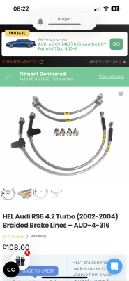

Looked at
Hel
Ebc
Forge motorsport
They all look good
I have opted for HEL stainless steel in carbon fibre look on the outer sleeve. Lifetime warranty.

I did email HEL to check on compatibility. They confirmed they are suitable for the RS6 C5. They also confirmed that the avant and sedan are the same
Like you I have gone for front and rear flexible hoses. Ordered them today. 2-3 days delivery.

Update. Flexi hoses arrived 13/06/25.
Really pleased with them.
