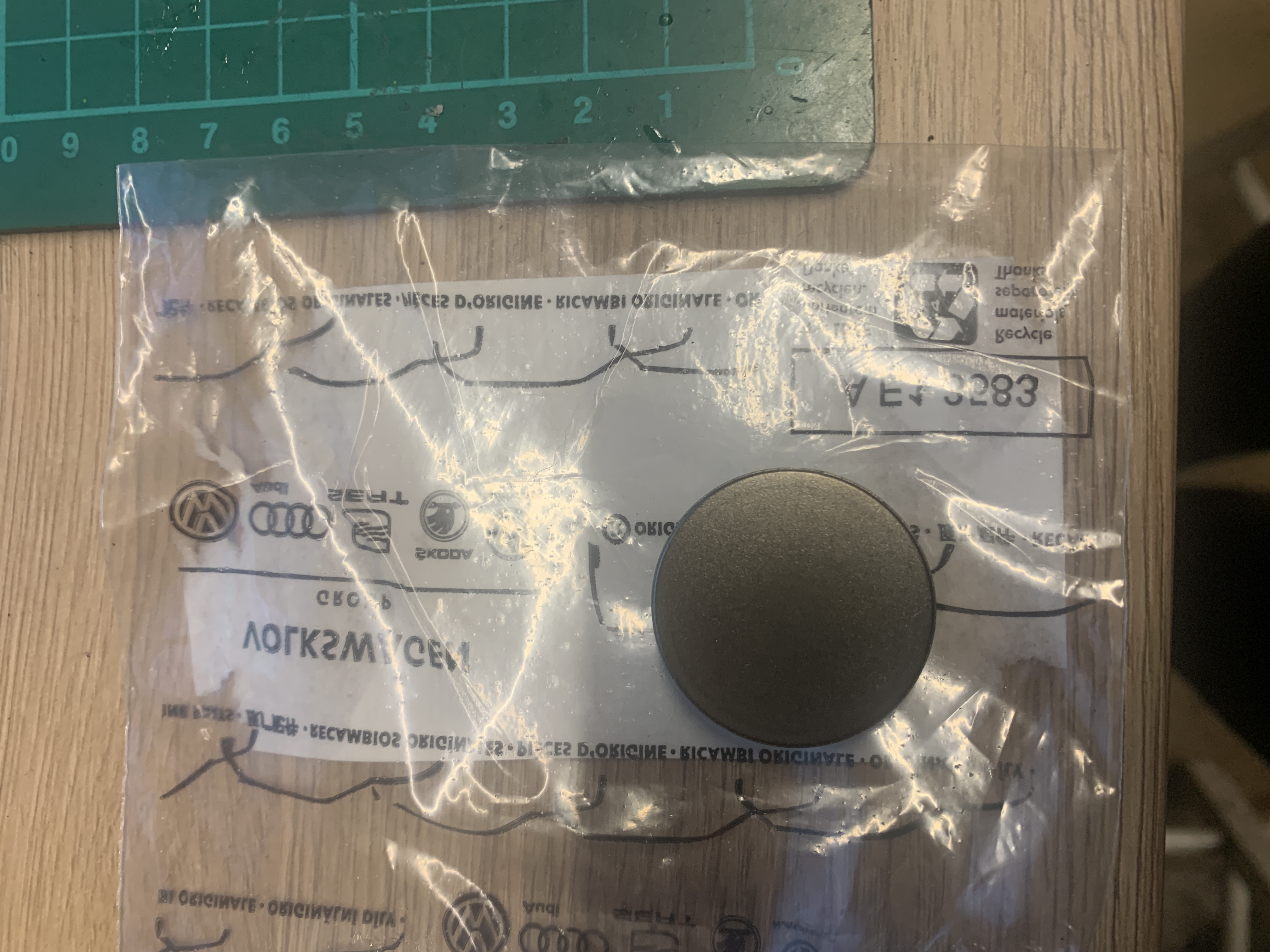

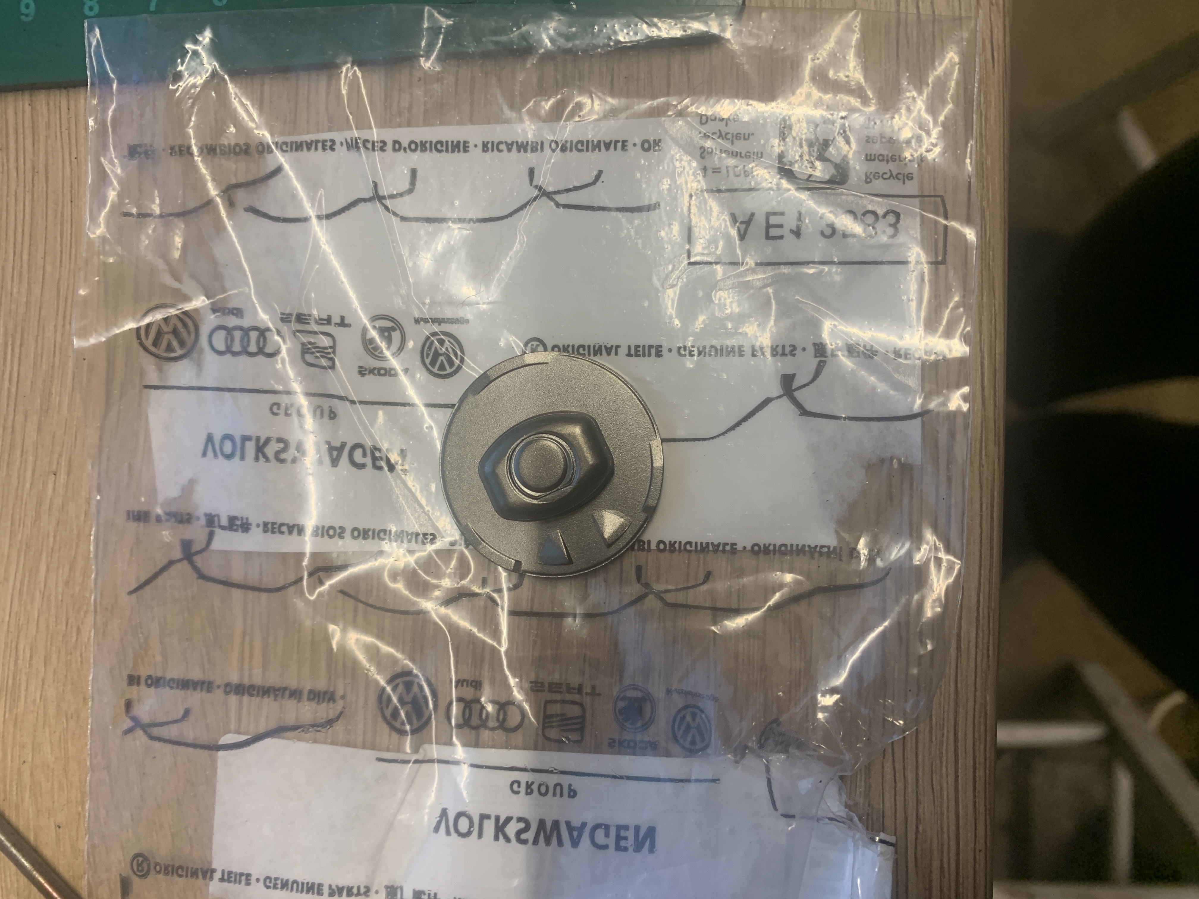

Does anyone know where I can get the sticky pad for the rear view mirror please? I bought a new mount from Audi but it does not have the sticky pad on it. I have tried some from Halfords but they were useless also tried some expensive 3M double side tape but still wont hold the mirror to the screen.

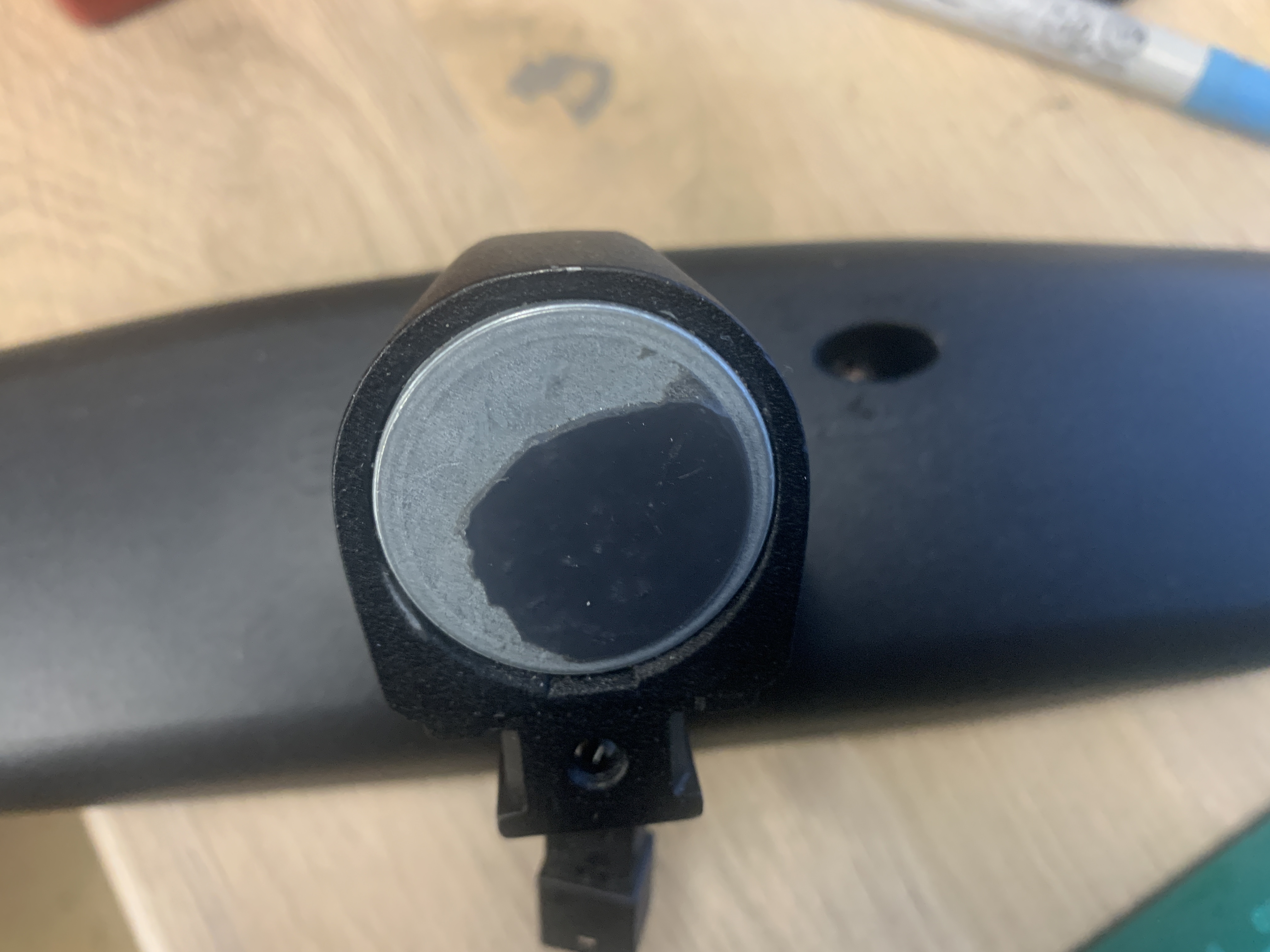

I know what you guys mean as I've had a new screen myself. But looking at whats left on the mirror it is some sort of sticky pad. Maybe I'll have to accidentally crack the windscreen and claim on the insurance

Paul from memory. To remove the mirror you turn the mirror approx 45 degrees acw.
With the mirror removed the post remains on the windscreen.
From your photo is that the post that has come away from the screen ?
It should by bonded to the screen. Which is very secure. Double sided tape etc is not strong enough mate.
I have known of owners that have broken their windscreen trying to remove the mirror.
The bonded post is that secure.

I've ordered Permatex 81840 Extreme Rearview Mirror Professional Strength Adhesive to try. If this dosen't work a new screen will be sorted.

Yes, glued the button on with the Permatex 81840 Extreme Rearview Mirror Professional Strength Adhesive, First attempt didn't work so I did it again and dared to use 2 drops and it has worked. Brutus is pretty much all up together now just the tailgate water leak to sort out.
