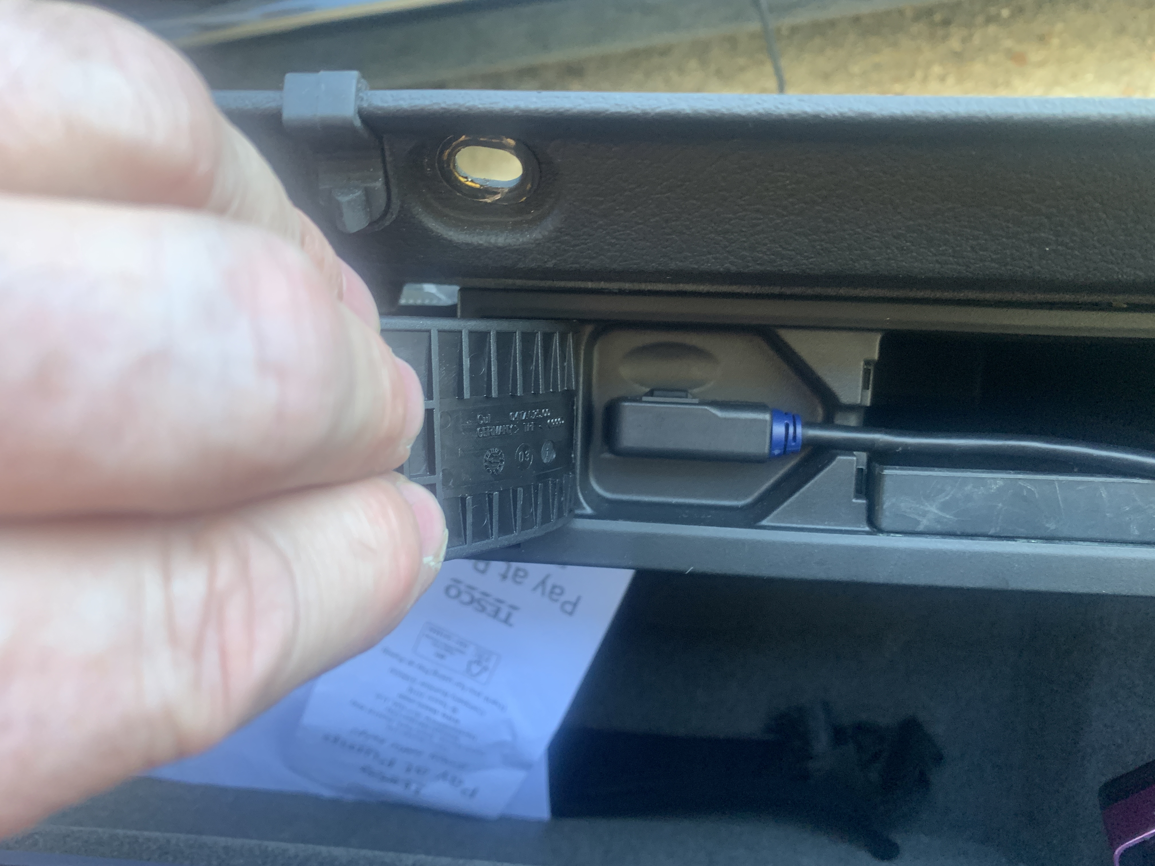

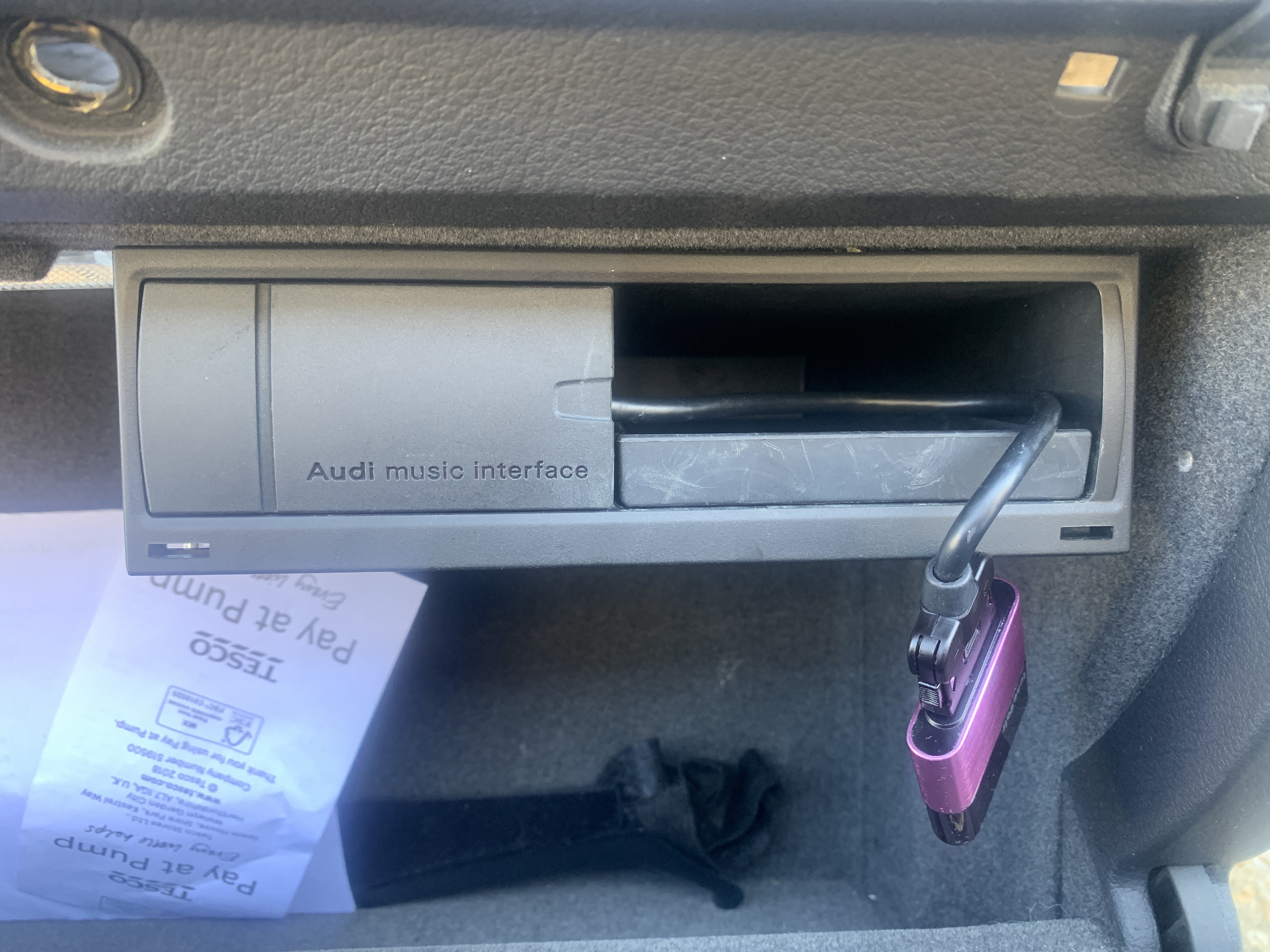

The plot thickens, just pulled glove box out and found this lot. Haven't got a scooby what it is yet but has an old Ipod connector on it. I know the big silver box is the bluetooth module.

What on earth is that Frankenstein bulb holder circuit? :shock:

That's one of the many LED lights thats Footers fitted, guessing its canbus error free with the circuit board :bigblink: Think they came from Trups.
