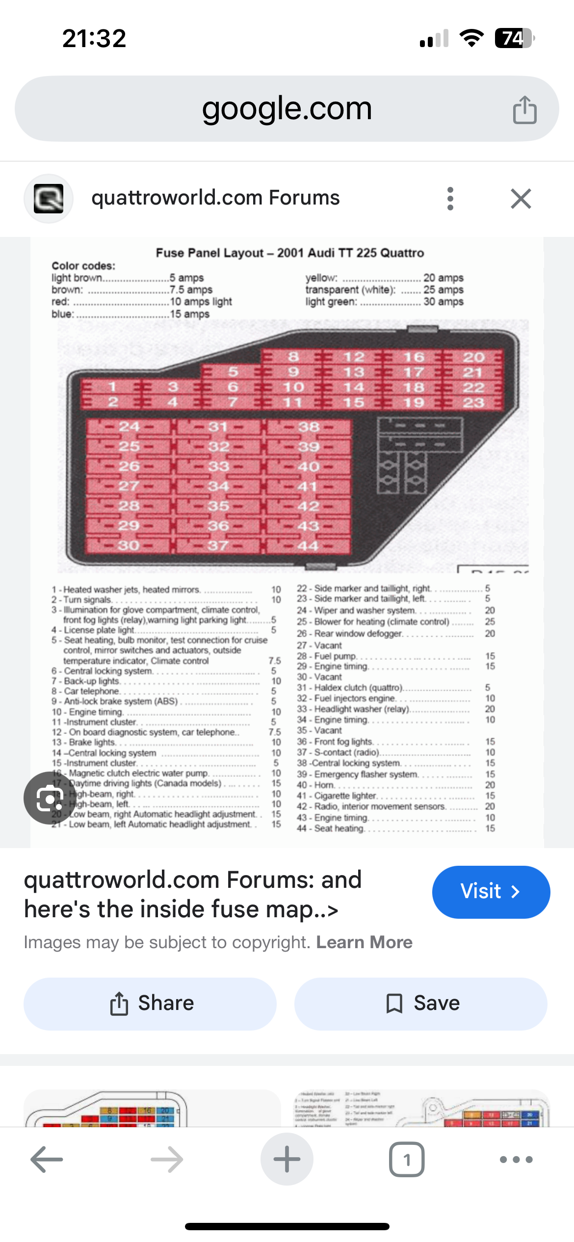

From the FAQ section
Oil pressurising the system
Pull fuse 29 and crank the engine over for 5 seconds to prime the pump.
Return fuse and start normally
Also on here to pull fuse 28 (fuel pump), if you intend to turn the car over a few times.

Thanks as always for your help Steve & Shop.
I'm happy to hear its an easier fix that I thought.
Anything else I should be thinking about if it's not moved for 9 months?
I'll sort the tax and take it for a long cruise to see what I need to fix.
