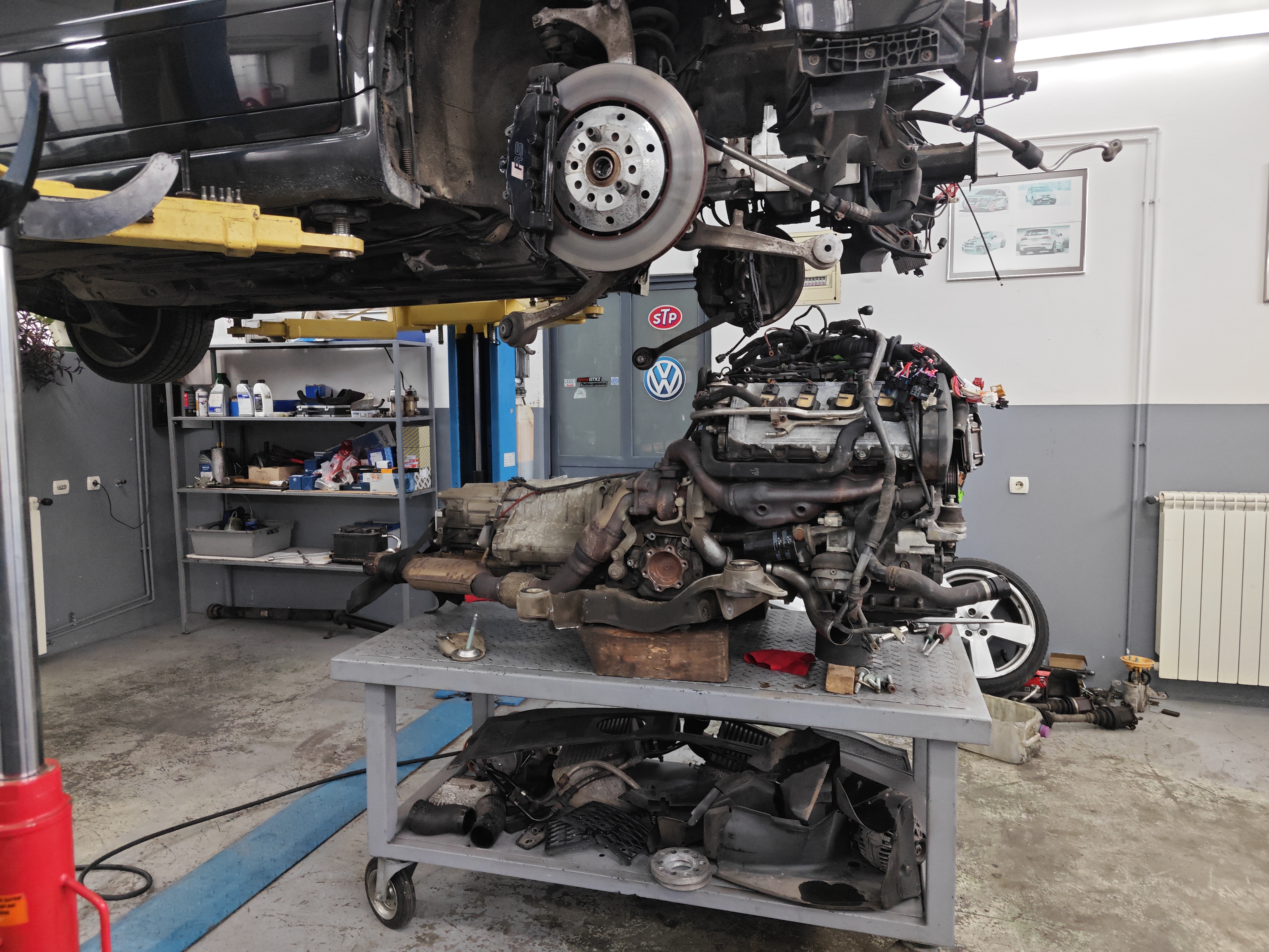

Seized bolts,pipes, everything old and fragile... I had to cut the oil cooler lines to remove them to avoid damaging thread on oil cooler, every bolt holding exhaust/turbo/manifold had to be heated up with flame.... Luckily, all O rings still can be ordered in Audi. Gearbox sent to repair, turbos, tomorow tooth belt and everything that goes with it, chain tensioner shoes, brake calipers refurbish....list goes on and on and on....
