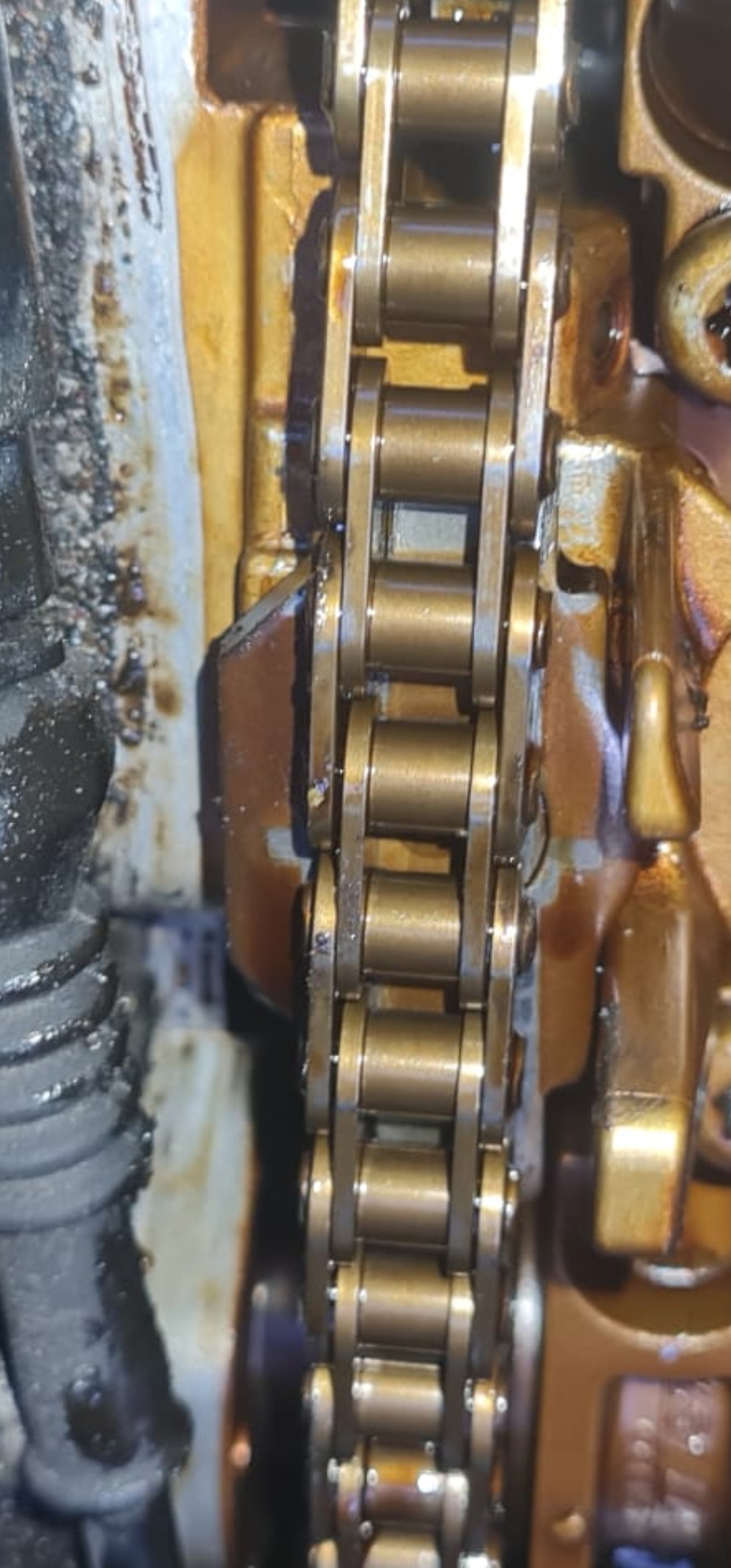

Reading this thread with interest, my top tensioner pad has completely disintegrated, chain now sitting on the metal piece that the plastic pad should sit on. Misfires on allcylinders in that bank. What is the likelihood of bent valves? The chain seems fine, and I caught it relatively early (not much damage to the metal plate on the adjuster). Logic would suggest that assuming the chain hasnt jumped any teeth the over timing of the inlet cam would only be a few degrees (the difference due to the thickness of a worn plastic tensioner pad). Just trying to workout how far to tear into the engine....

ChrisH2017 wrote:Reading this thread with interest, my top tensioner pad has completely disintegrated, chain now sitting on the metal piece that the plastic pad should sit on. Misfires on allcylinders in that bank. What is the likelihood of bent valves? The chain seems fine, and I caught it relatively early (not much damage to the metal plate on the adjuster). Logic would suggest that assuming the chain hasnt jumped any teeth the over timing of the inlet cam would only be a few degrees (the difference due to the thickness of a worn plastic tensioner pad). Just trying to workout how far to tear into the engine....
Does it look like this.
Been there done that.

Yes, similar.

No know valve issues, that engine ran quite fine. But it had other issues and was scrapped in the end.Image
