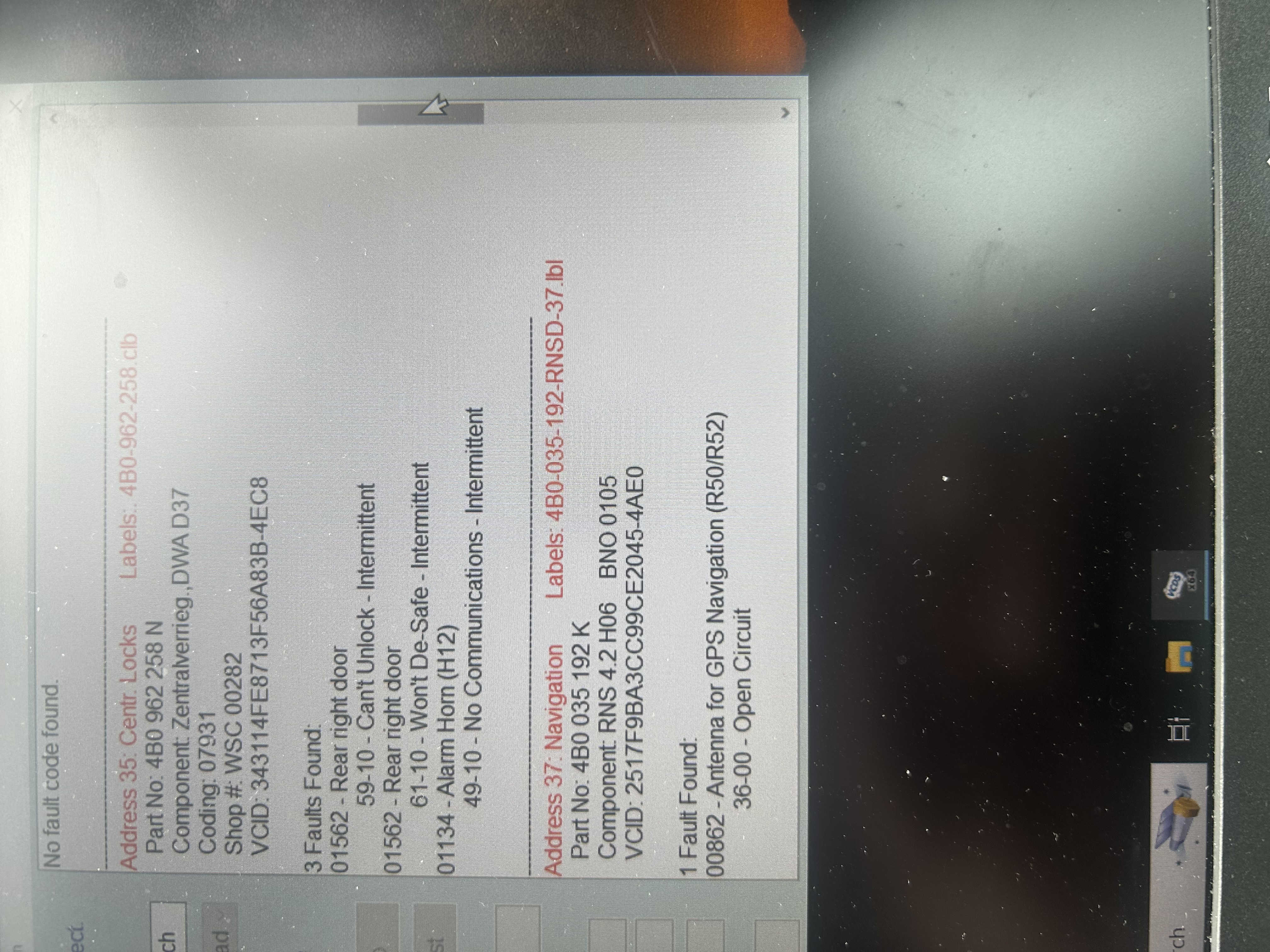

Just performed the first auto scan with the replacement CCM.
These were the only logged errors
Nothing to be concerned about.
Would be nice to have a clean scan though.
Performed a reset.
Will now wait a while and see if anything comes back.
