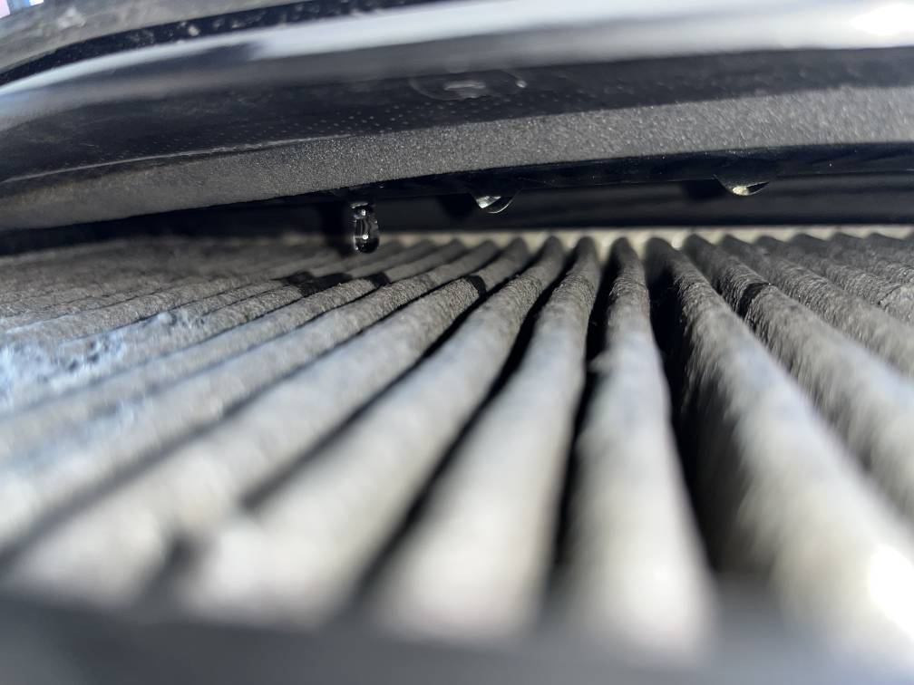

I had this in my Allroad, I'll bet it's the trim at the bottom of the windscreen is slightly detached and then any water that runs down the screen on the LHS runs straight into the pollen filter. I scoured a scrapyard and found a Passat pollen filter cover which fits perfectly over the pollen filter and moves any water away from the filter and down the drain holes. If not you could fashion a temporary cover and get a hose on the windscreen to check where the rain is running, I bet it's into the filter. Good luck.

Hi. Thank you for your feedback.
The windscreen and water deflector are not that old so I don’t think that’s my problem. The newish water deflector has a lip that goes up and behind the windscreen.
Since learning that the scuttle drain and a/c drain share the same drain pipe.
I am guessing that a blocked ac drain would result in a build up of water spilling into the pollen filter housing. Then overflowing into the footwells.
The scuttle was dry as was the actual pollen filter.
As I say I am best guessing at the moment.
I am interested in your Passat filter cover.

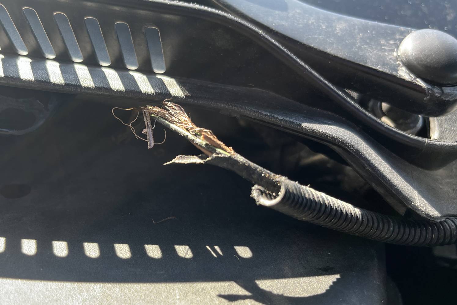

Jesus, the fun never stops:
Feckin mice.
Feckin mice.
Re: Carpet soaked.
Ouch. That's not good.

Worth it to stop the buggers eating the car and causing massive damage. I've already spent hours trying to get to those wires.
