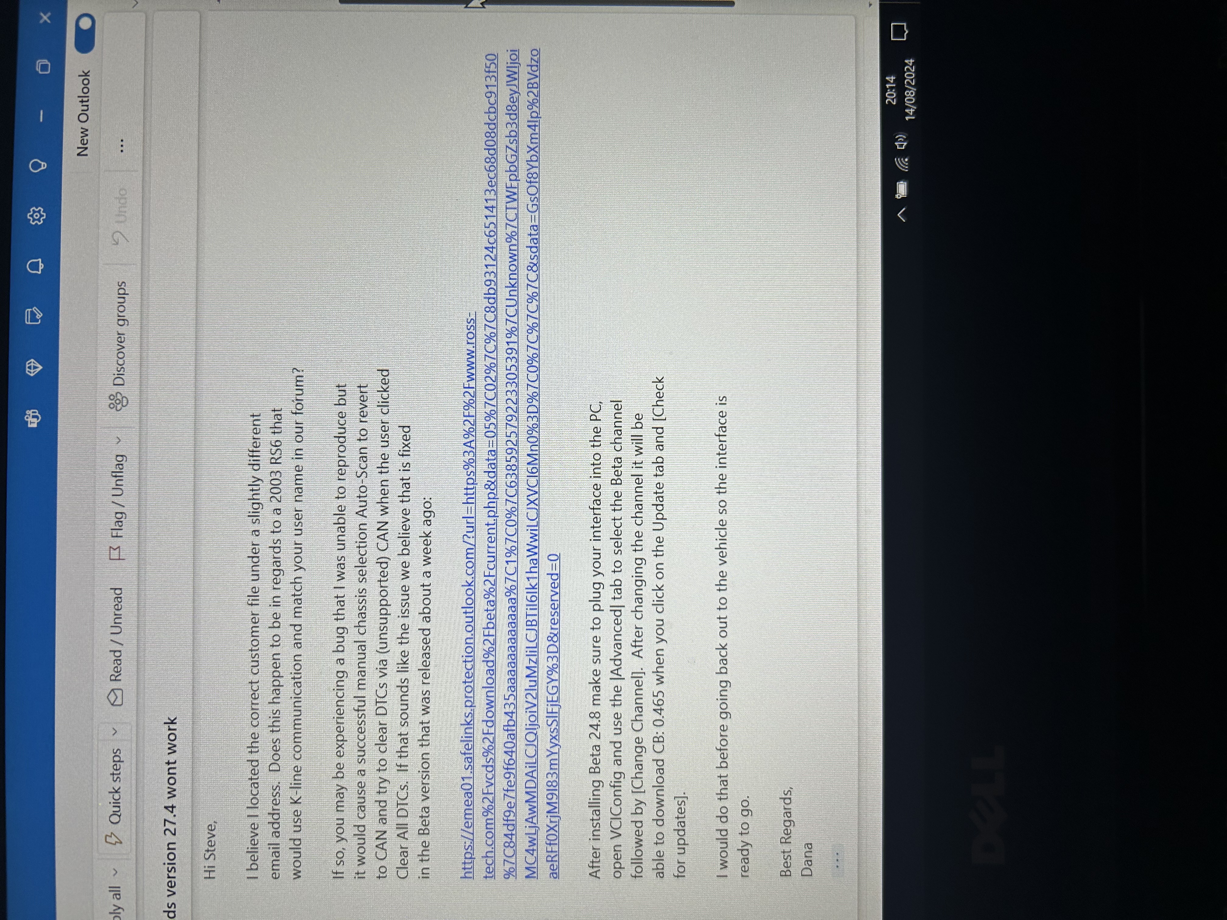

Hi Ben.
There is a known problem. And it is the exact problem I am experiencing.
Ross tech are advising me to download the beta version 24.8 and to make 1 or 2 setting adjustments in beta.
Have asked them for an idiots guide as I am not that good with computers.
Will report back when I get a response.
Last edited by steve2003rs6 on Sat Aug 17, 2024 10:50 am, edited 3 times in total.
- Posts: 2942
Re: VCDS problem.
I have downloaded beta 24.8 version.
Just the other config bits to sort out.
Ross tech have asked for an update to see if it resolves the immediate problem.

Re: VCDS problem.
Ross tech informed me they rectified a similar software fault on the beta version. That was rectified a week ago.
Hence why they have advised me to use beta.

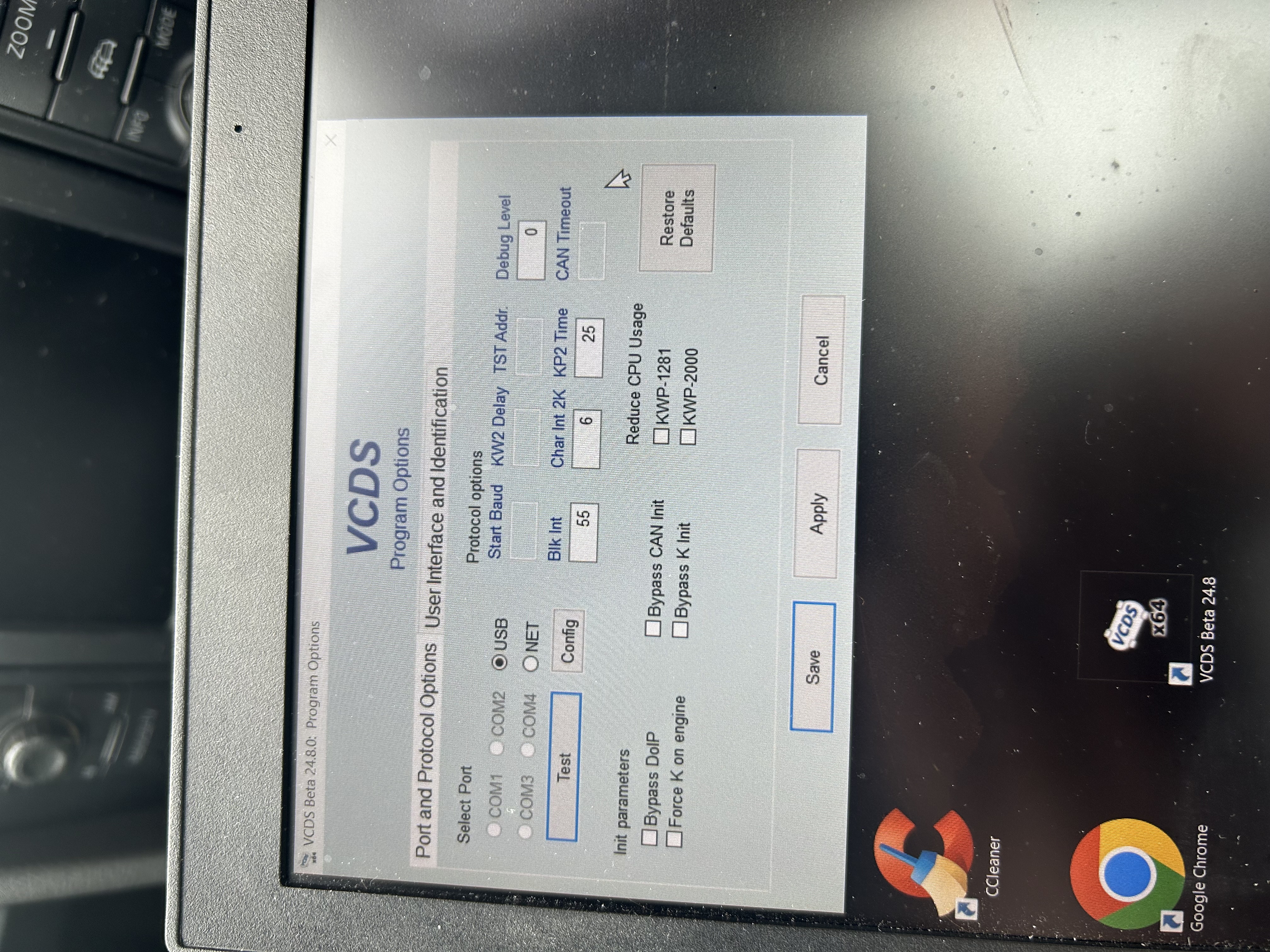

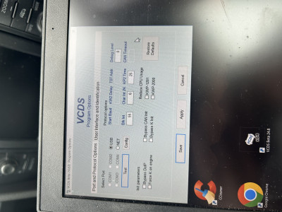

Did it revert to "Auto-detect (CAN only)" in the drop down after the scan?
Why don't you ask Rosstech for an older version. I'm using 21.9.0 and it appears to be fine (albeit you have to manually select the chassis).
For a long time I used Release 15.7.3 because I am always averse to updating unless I absolutely have to. Don't know if that version works on Win10 though.
There is nothing in the later versions (>15) that is useful for the RS6, but I needed to update it for more modern cars.

- Posts: 2942
Re: VCDS problem.
Cannot change CAN timeout. Not an option.
Re: VCDS problem.
Tick "Bypass CAN init" to see what happens.
