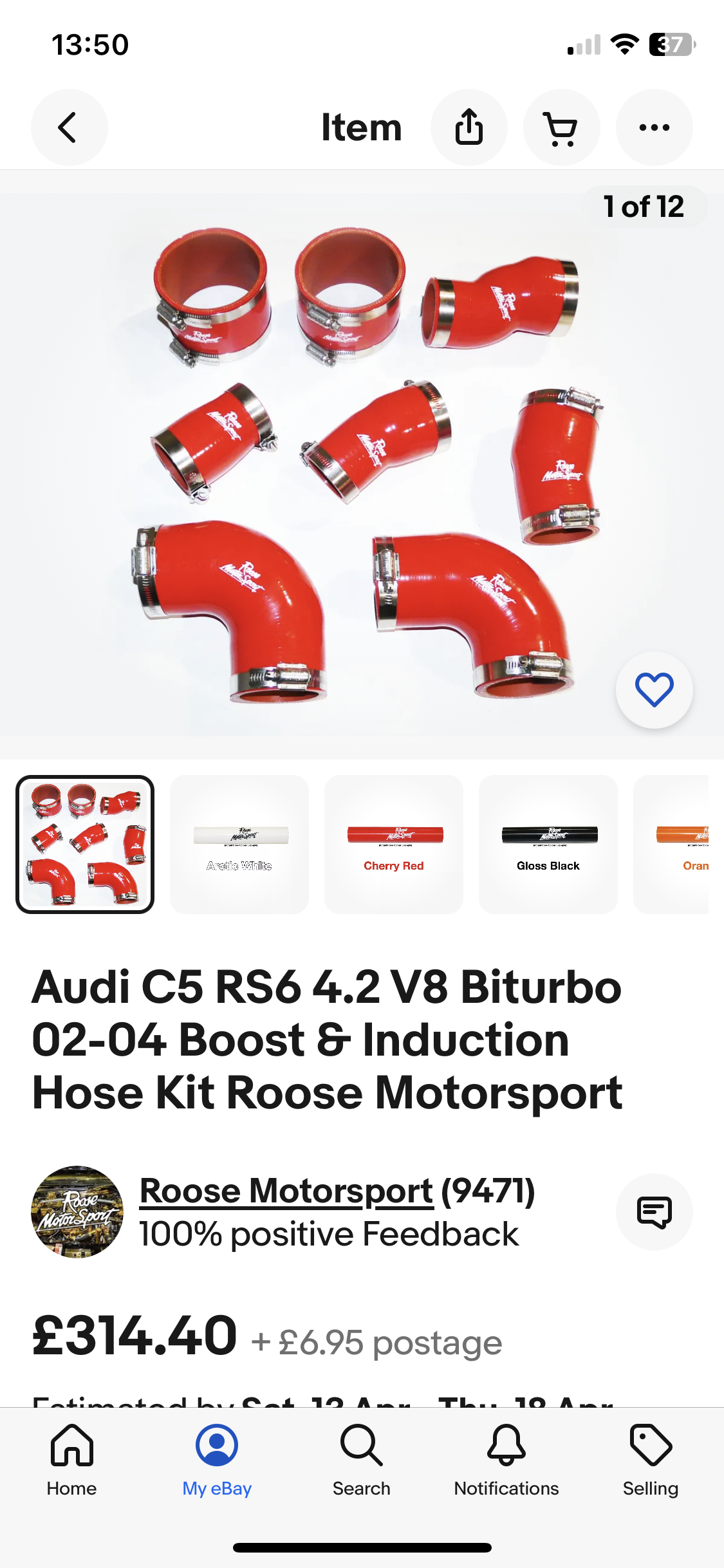

Silicon hoses approx £300 if you need them.

I have these. They are nice - good and solid. Only thing is if you have Wagner intercoolers, ask him to make the lower hoses slightly longer, the Wagners need a very slightly longer hose.

That’s a really good point as the Wagners are thicker and have a different end tank. I may need some bottom hoses soon, I was a bit too low for a while ImageImageImage

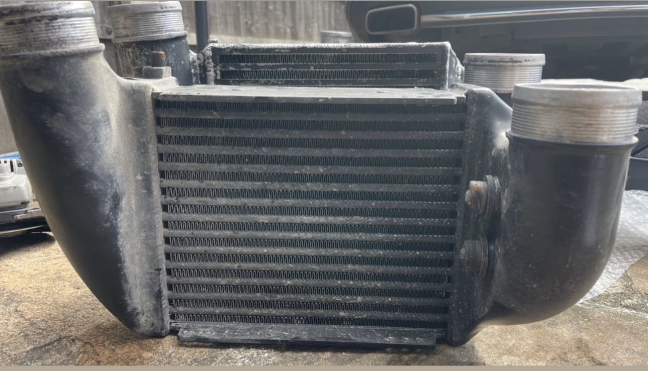

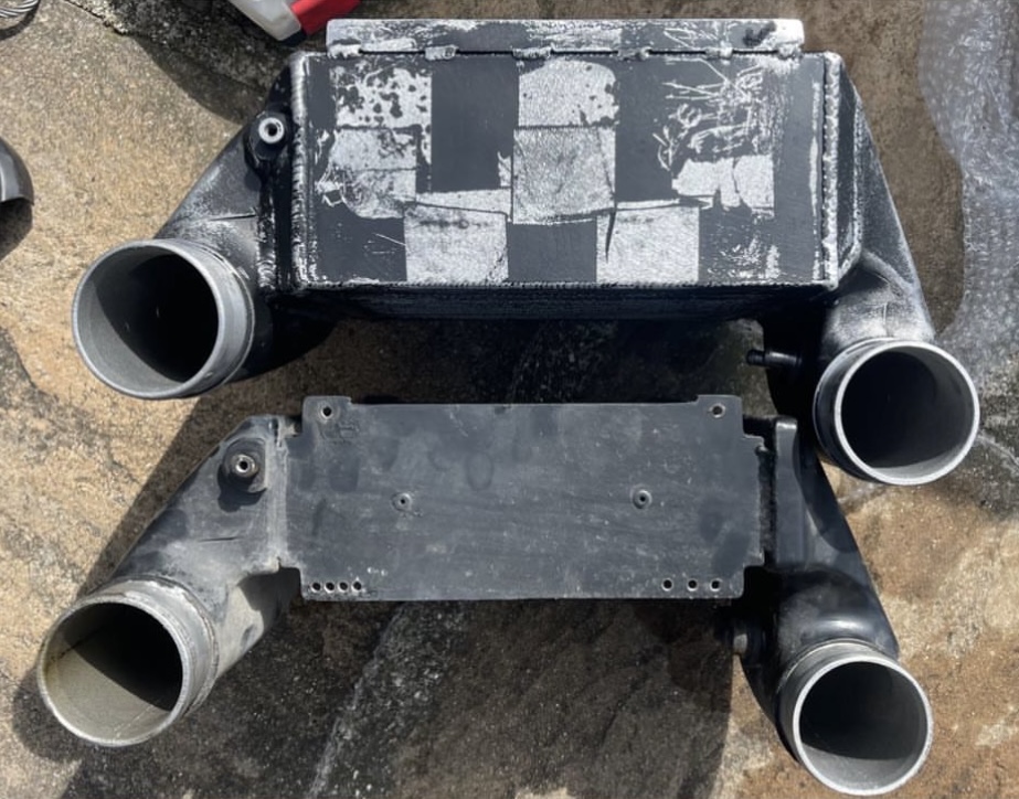

Wagners don’t have anything on my custom intercoolers :rocker:
These have bell cores and are rated upto around 1200hp-ish
They are thicker, taller & wider

Hi Wes Image What Wagner intercooler is that in your photo? It doesn’t look like a Gen.2 so maybe older Gen.1? Mine are Gen.2 Competition spec, so noticeably thicker and closer to what you have. You do realise we’ve turned this post into some kind of dick waving exercise Image ImageImage

You are right they were the gen 1’s although my new ones are still bigger than the Wagner comp intercoolers.
In all honesty though any intercooler (even record by airtec) will be noticeable better than the original standard ones. Just due to core development and progress over the years. From when they was made to no days.

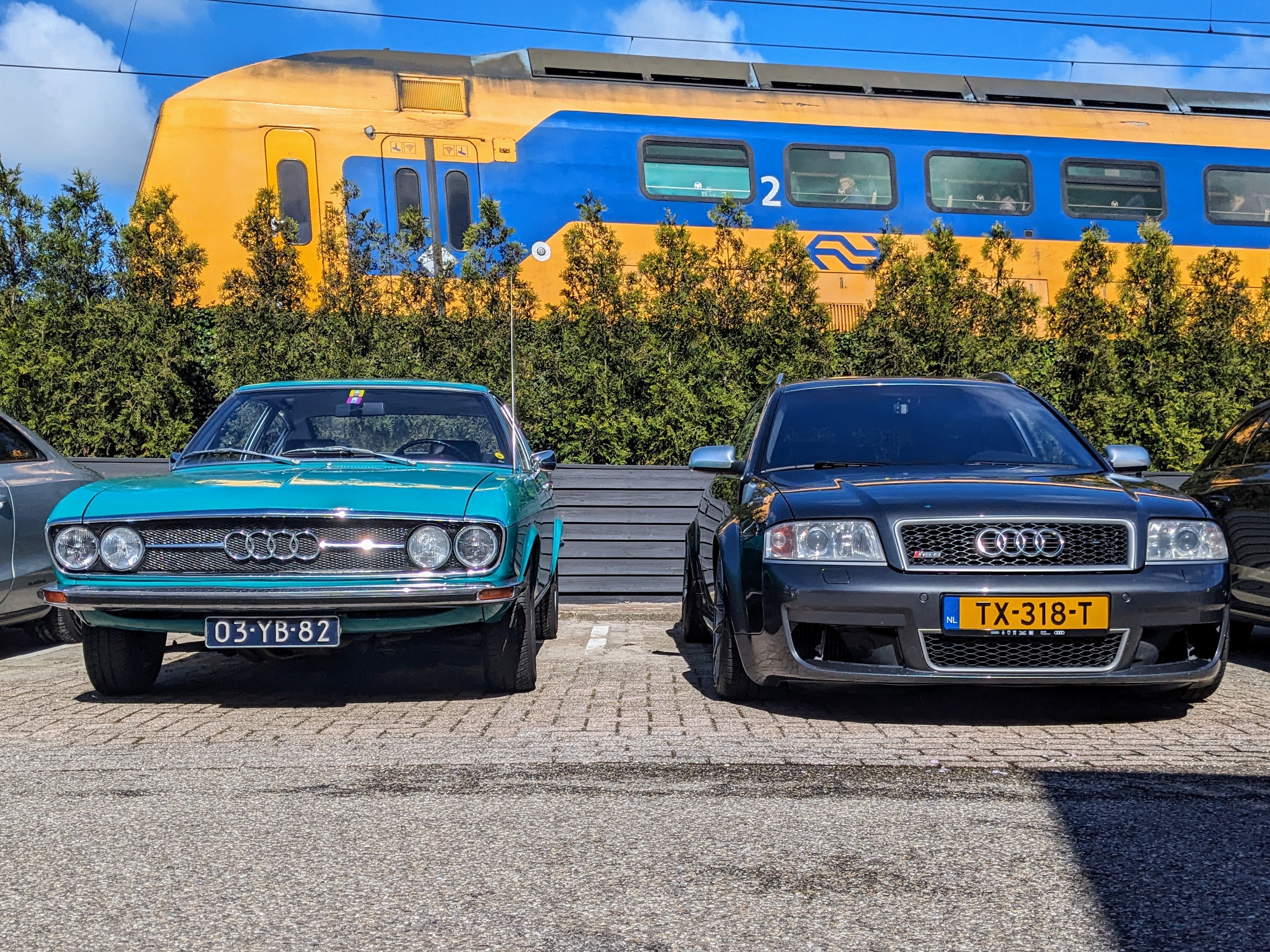

has anyone come up with a smart solution for the fog-delete larger grill?
the WE screw isn't something i could bring myself to do.
i was at a random dutch audi meet today. the other C5 had them and i can't come round the the installation.
i'm running the no-grill at the moment. not sure i like the look

Them grills just look like they haven’t been fitted right. As mine look nothing like that, fitted to my bumper.
