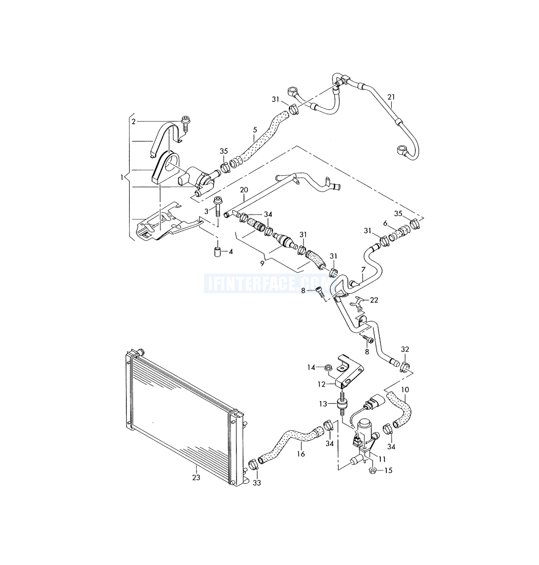

Possibly plugs in to part no. 11 on this diagram, which is mounted underneath the nearside chassis rail at the front?

Mɐʇʇ wrote:
Sat Mar 02, 2024 8:23 pm
Part No. 11 on the diagram is the coolant circulation valve. It could be that, but I'd expect that @markmark to be having overheating problems if the valve was not working due to it not being plugged in? Or maybe the valve works in re verse i.e. always open? I'm not sure...

Post by Mɐʇʇ » Sun Mar 03, 2024 7:04 pm
I would always wage that wire, on that side of the bay, is for that valve. It may not be, but it’s always the first thing to check since it’s so easy to miss.

It is for number 11 , coolant valve , the original picture in the first post was when i asked if anyone could identify the plug in my hand on passenger (uk) side engine wiring , and it was for the coolant valave under the pass side chassis leg.the wire that has been marked with the red arrow is the cable leading to the plug i am holding.

In my case as I had 2 extra plugs, so this wire was indeed for the coolant valve as mentioned above. It totally threw me because I don't have the HOT COUNTRY package on my car, so I don't have that valve either. When the engine was changed in my car from BCY to BRV, so was the wiring loom ;-) problem solved :-)
