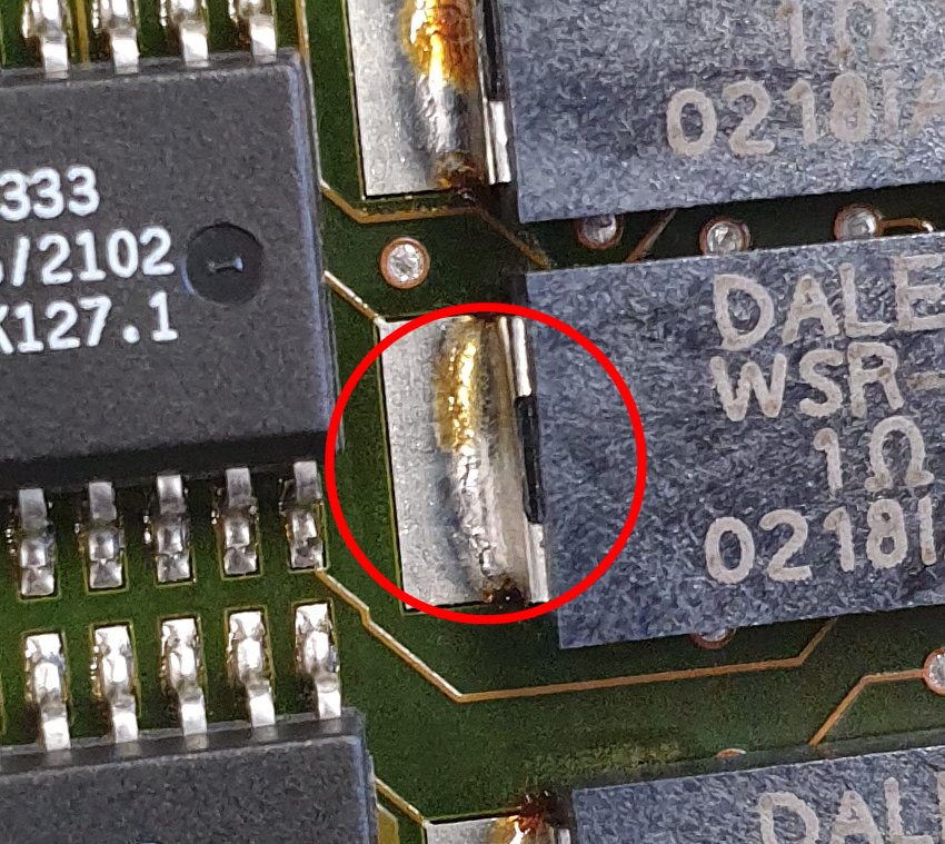

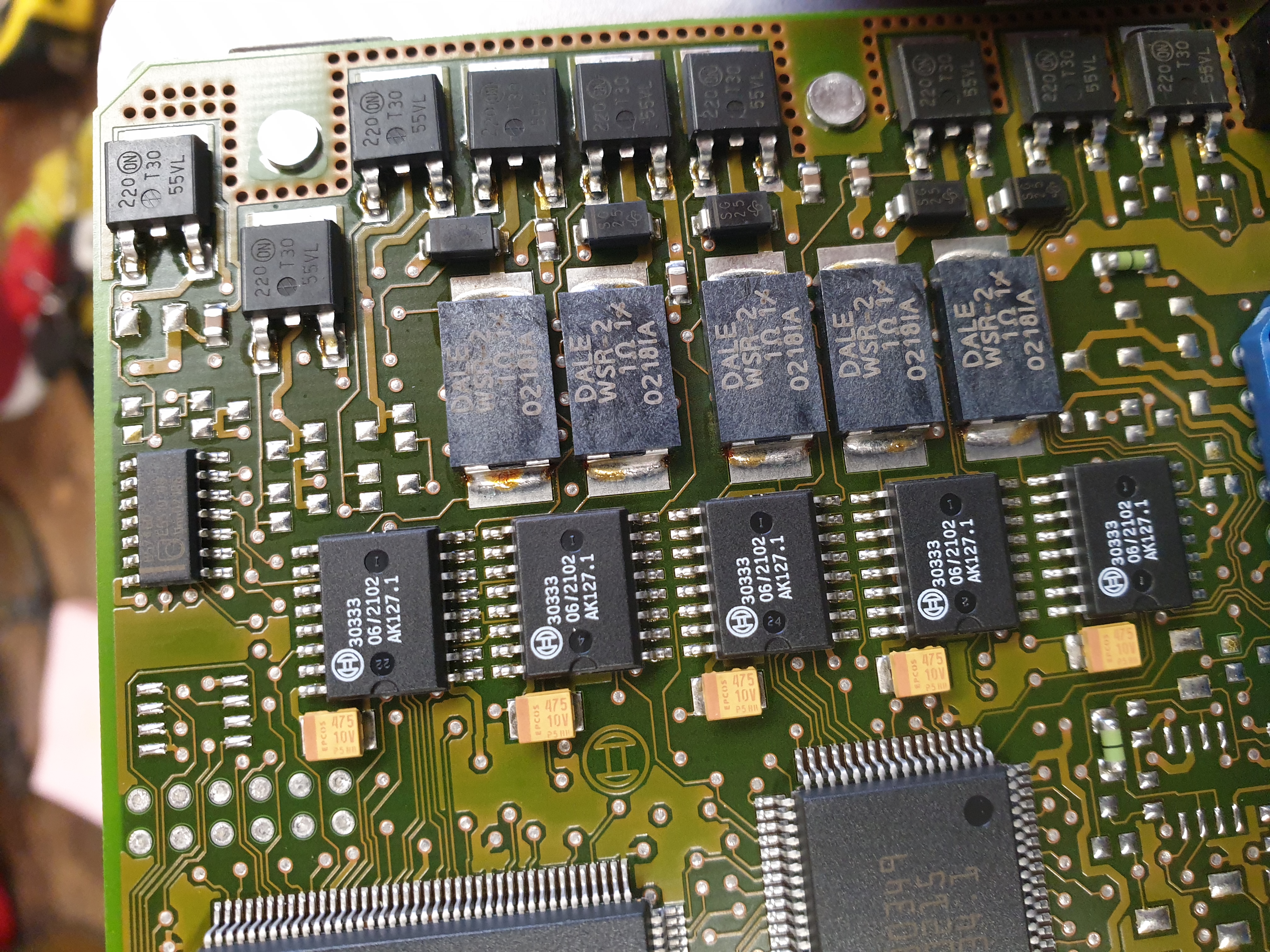

I ve taken the top of the TCU an looked inside and some of the solder joints are orange ish in colour so think this could be the issue as the faults codes that appeared are around the same time I had a water leak through the bonnet cable grommet.
I ve take some pics of the orange joints.
Re: Gearbox TCU
Yeah, looks a bit corroded. But more importantly, those joints are cracked. You can clearly see.

Don't think it's corrosion, on second thoughts. Just looks like localised build-up of conformal coating, but it could also be flux residue, which can be corrosive. Some factories are better than other at cleaning it off. Those big pads just look like radiators.
Get a 20x jeweller magnifier and check all the solder joints.

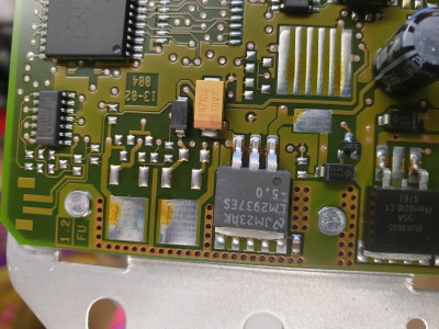

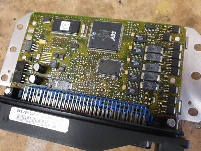

Reminds me of the issue found on my spare TCU... surprisingly, it still worked fine, though!
(Pic taken just before I soldered replacement capacitors in)
Re: Gearbox TCU
Mmm. Bulgy.
