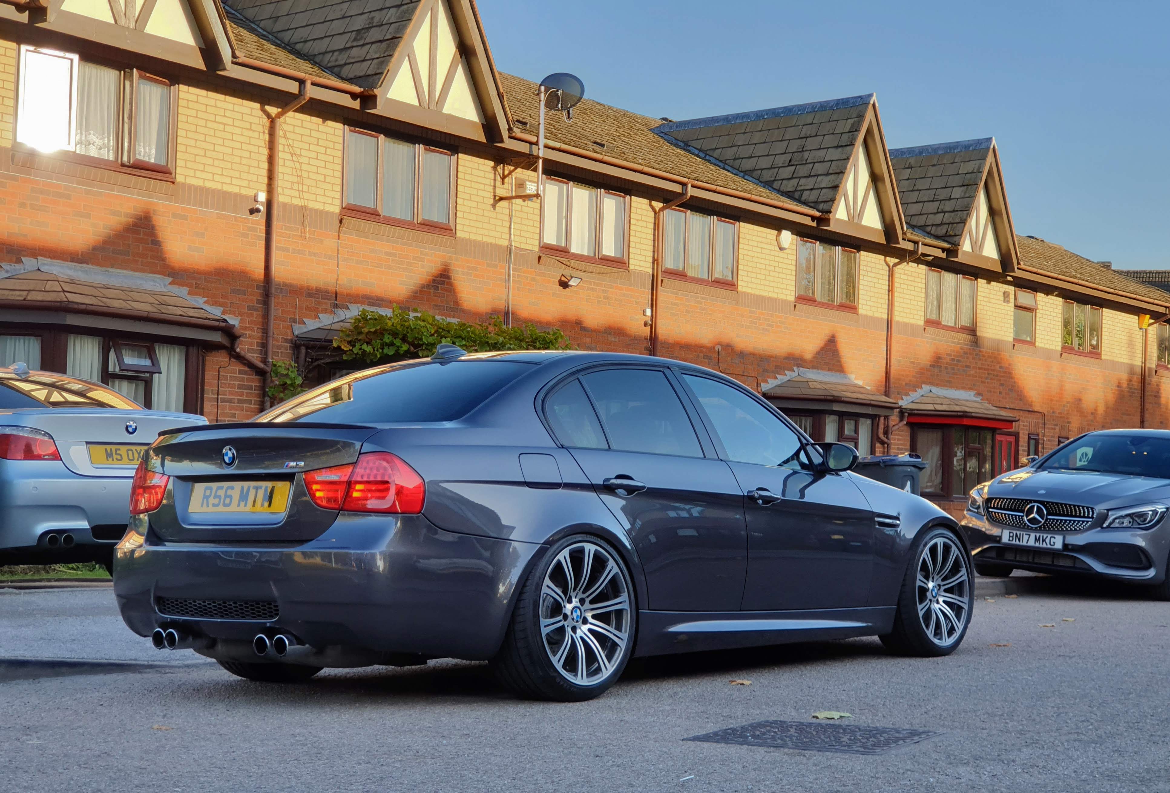

Had an E90 M3 myself. Was quite possibly the best all rounder I had. Not the fastest but in terms of a full package, performance, practicality, looks, reliability, cost etc it may just be the best car I've had. It literally did everything brilliantly and wasn't ridiculous money at the time.

They are fantastic. Might have to get one. I reckon they''ll be a future classic, too.

Yeah, 100%. Not paid much attention to the coupe but the saloons have risen since I had mine. Mine had high miles (around 130k i think) but it was backed up with full BMW dealer history. I sold mine for around 13k in around 2019 iirc. Prices have crept up since then.
