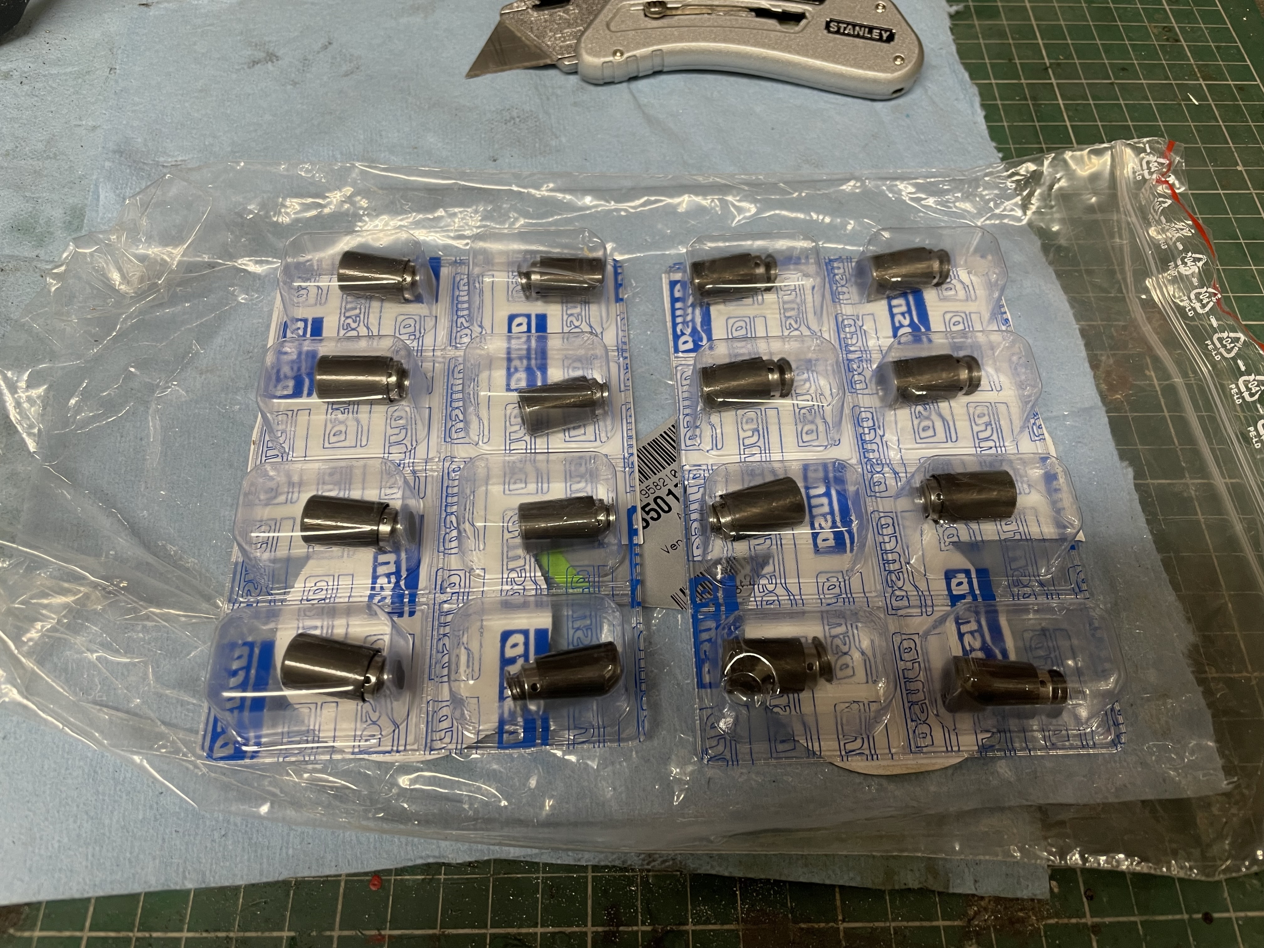

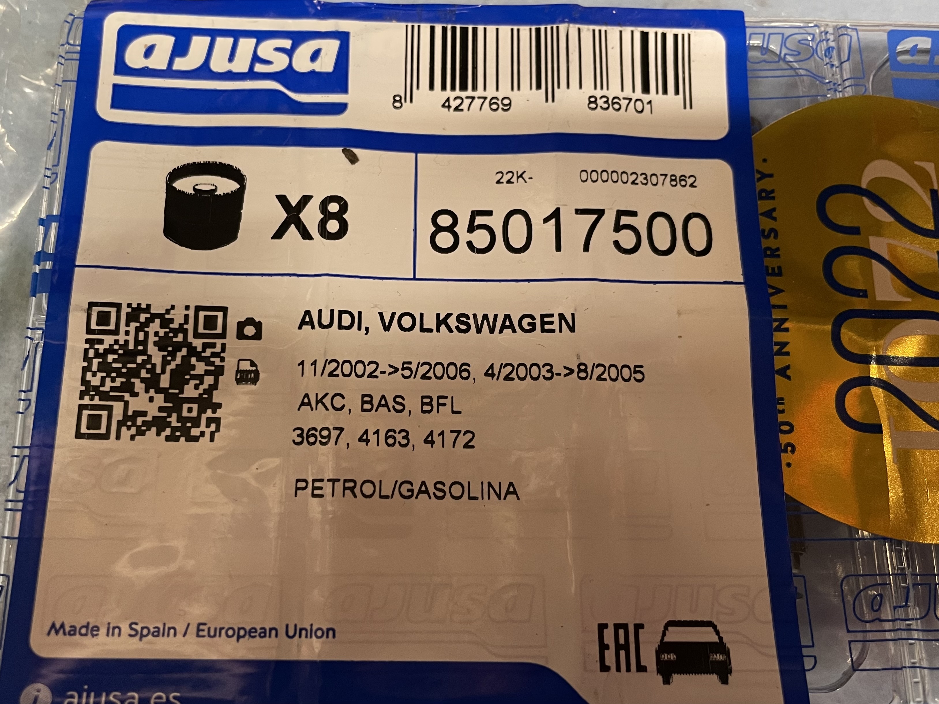

The large rockers only seem available from Audi. They are about £200 each and come with the lifters. We’d need 20 of them.
I’ve bought 20 new lifters and a spare rocker just to see how they work. I’ve also got an ultrasonic cleaner so was planning on doing my cambelt then swapping all the exhaust lifters for new, plus cleaning all the inlet ones.

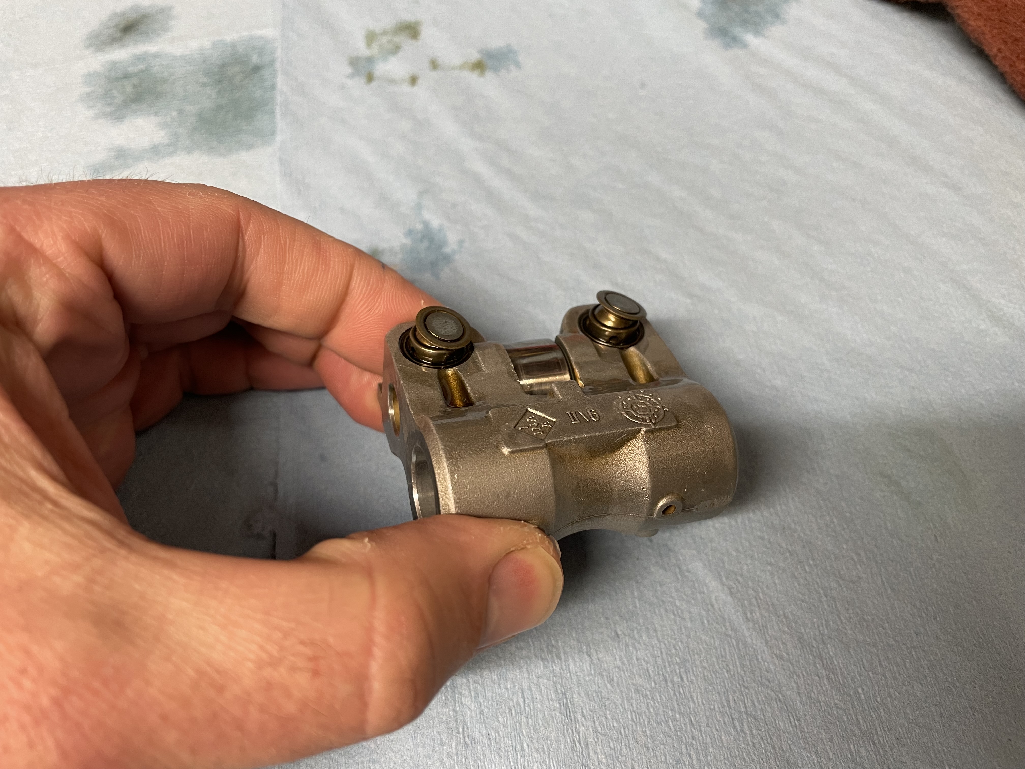

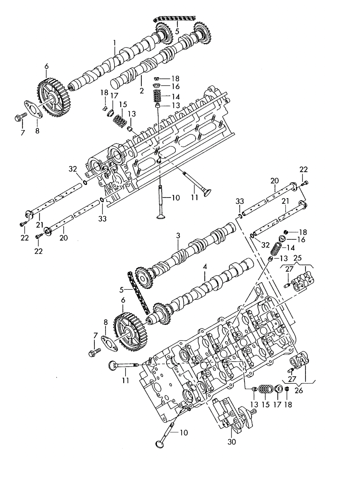

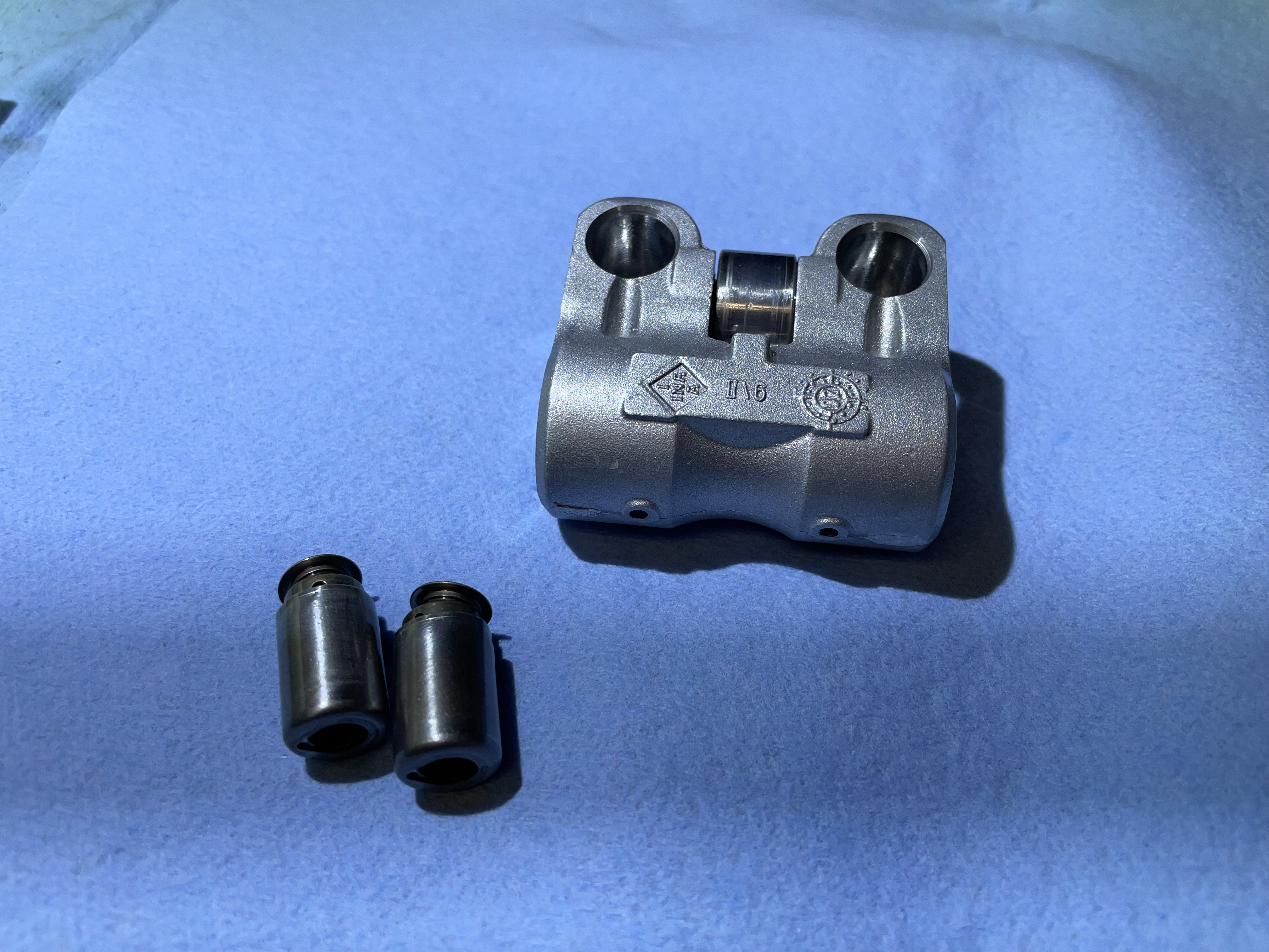

Here’s some photos. The rocker I have is for the exhaust valves which rides on one cam lobe and has is for 2 valves. (Diagram parts 26/27)
The inlet ones have 2 lobes and are for 3 valves. (Diagram part 25/27)
I’ve bought 16 new exhaust valves - plus have 2 second hand ones. I’ve already bought the seals so I could take the driver side rods out diagram 21/22.
Ideally I’d take them all out and give them a clean as they carry the oil feeds.
