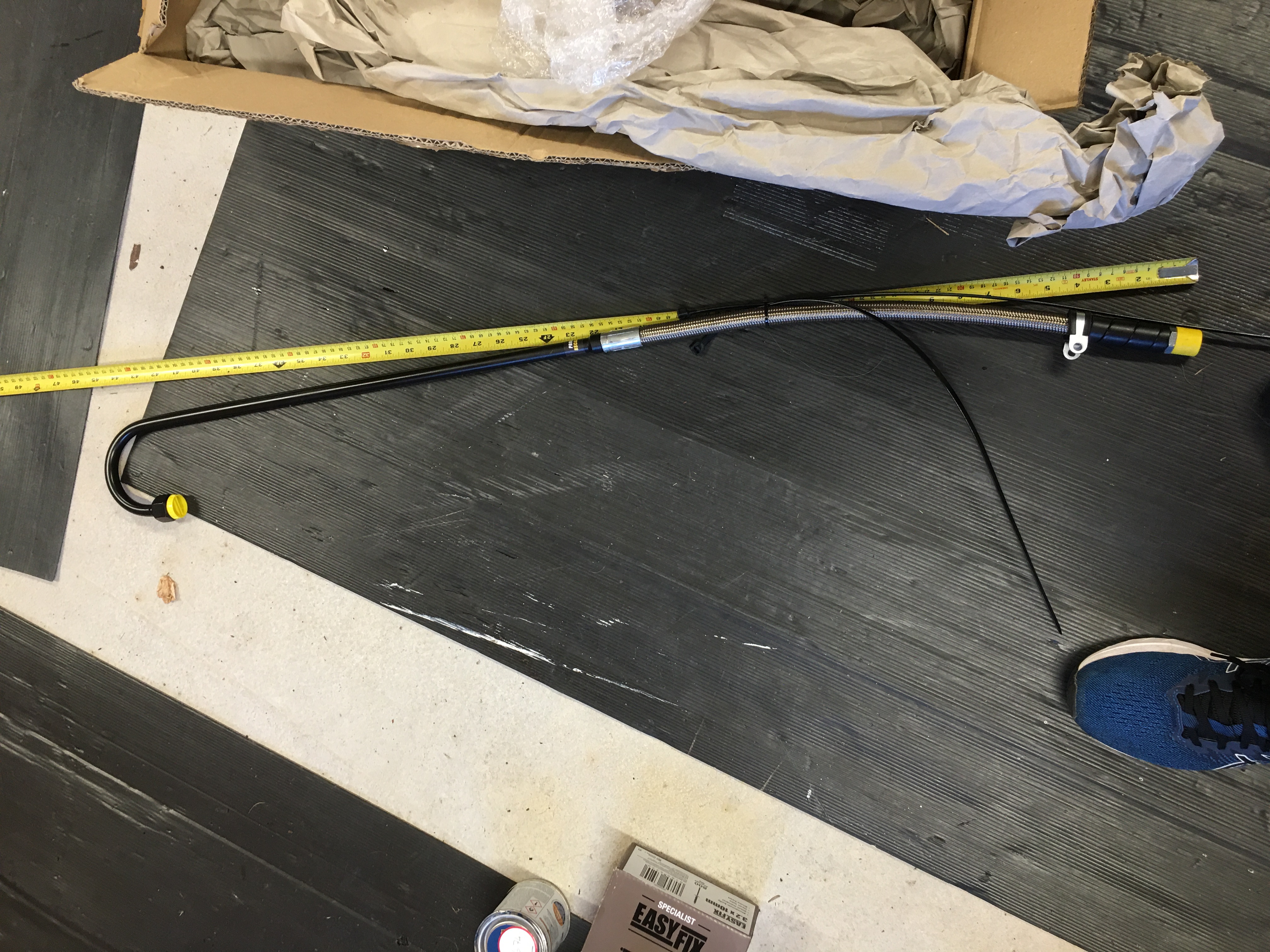

I plan to put all the replacement pipes out and measure the exact sizes and will post with pictures should anyone wish to have some made by a a hydraulic specialist which may help others in the future.

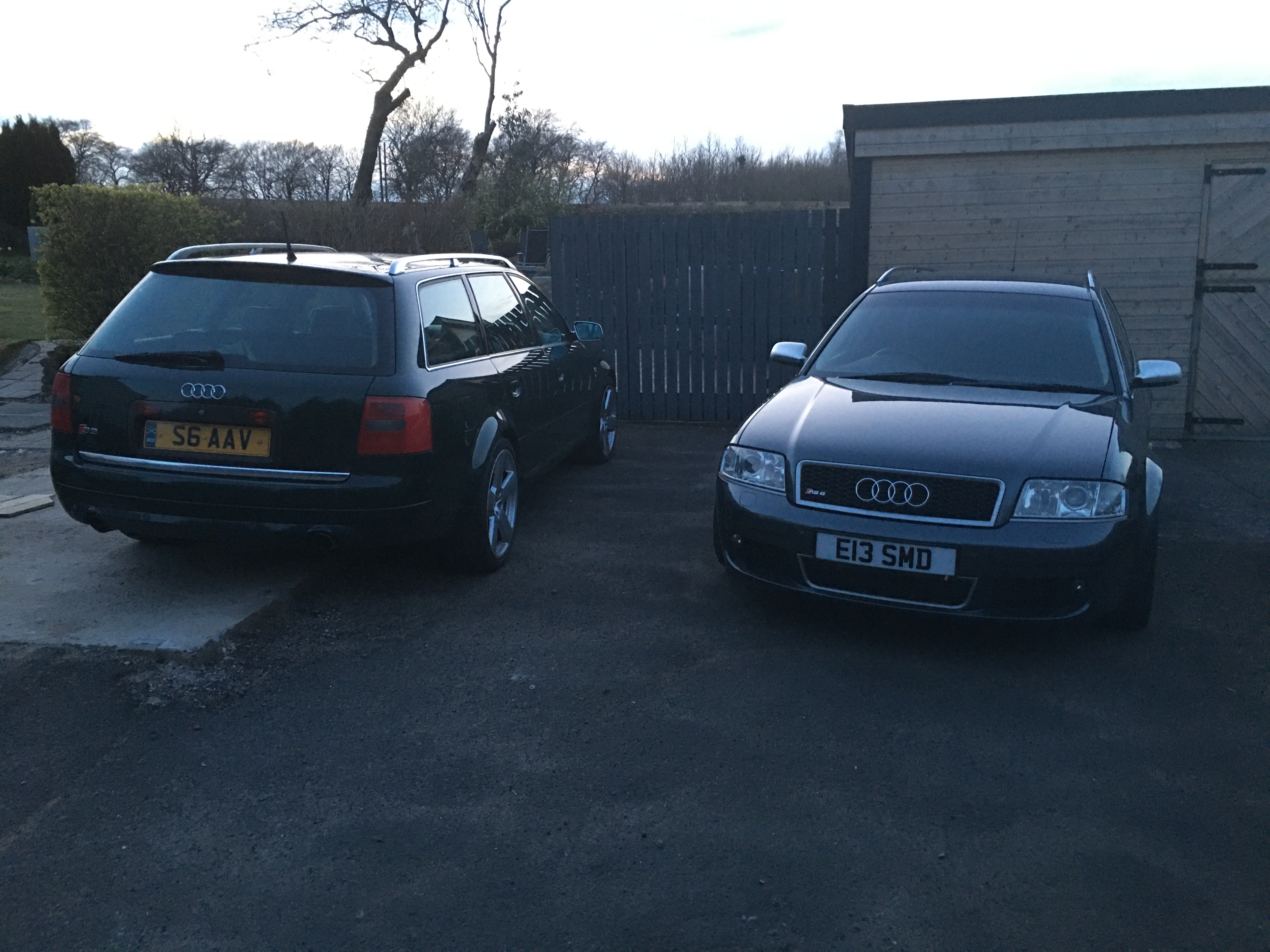

A wee picture of when i had the two old girls. Unfortunately due to a house extension i could not keep the maintenance up on the S6 and gave her away to a guy who had admired her in passing. He got her an MOT and fixed a few jobs and has kept her going thankfullyv!!. Made sure he would not break her.

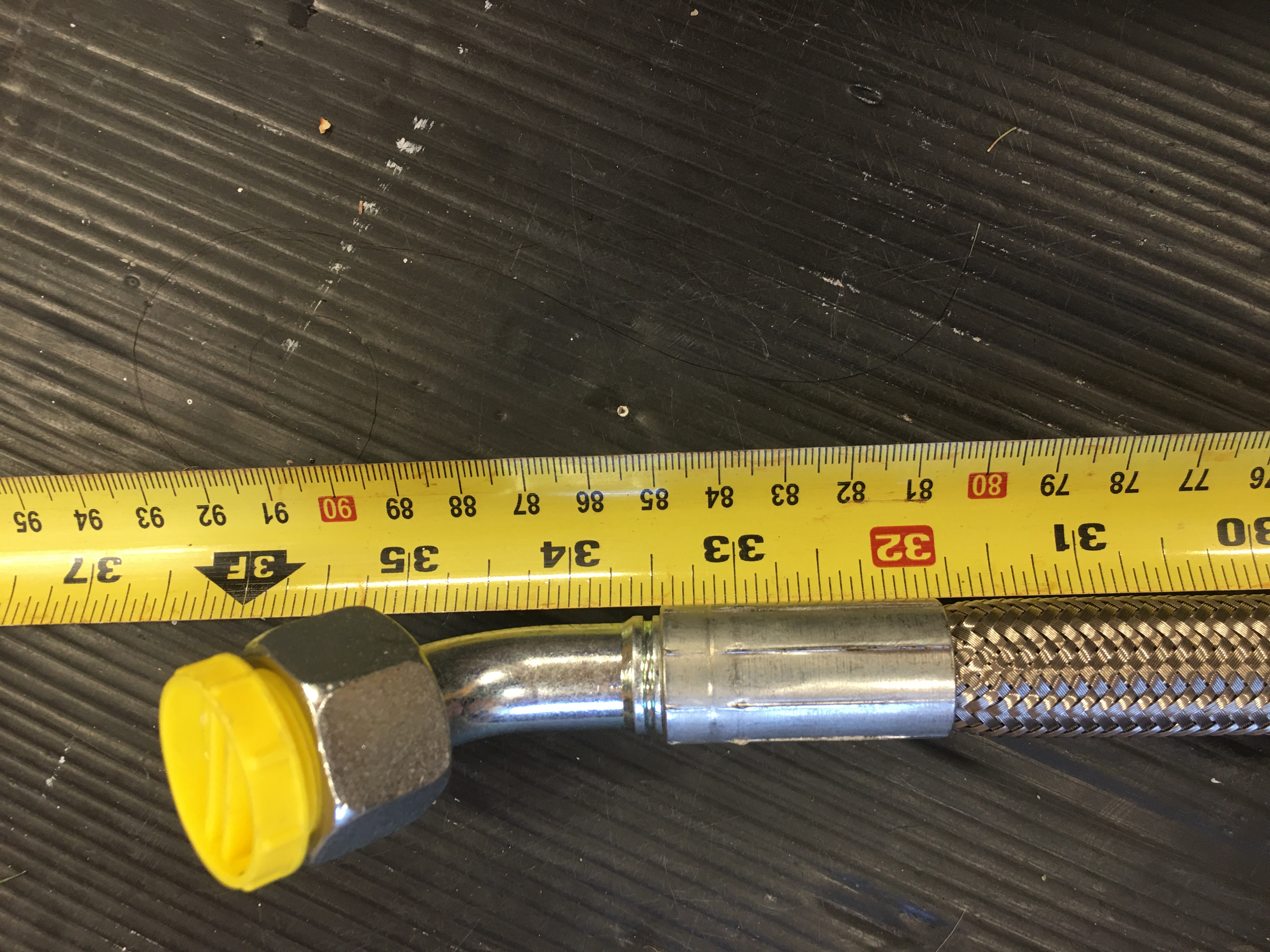

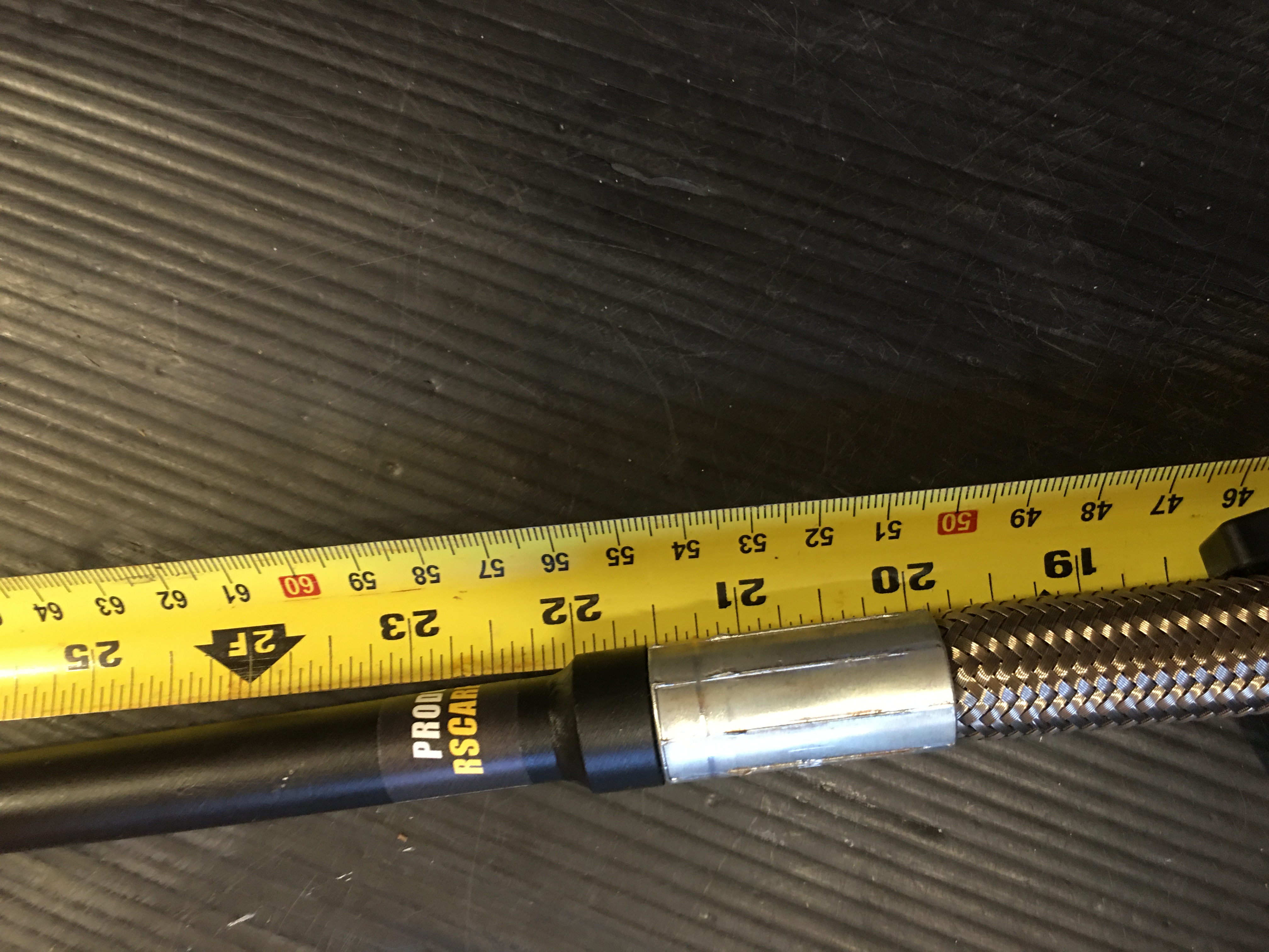

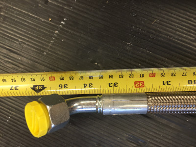

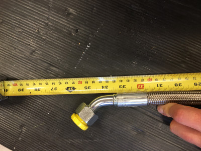

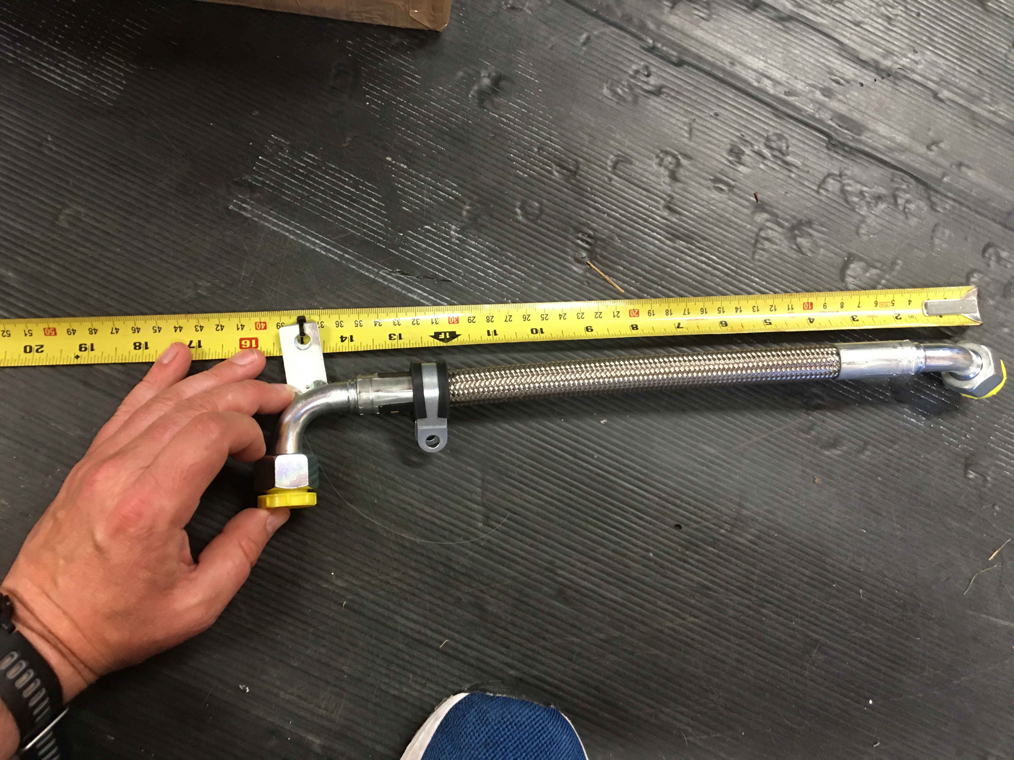

3 hoses for oil cooler lengths. Will add the relevant part numbers to the photos. Just need to double check them. Maybe of some help to someone in the future.

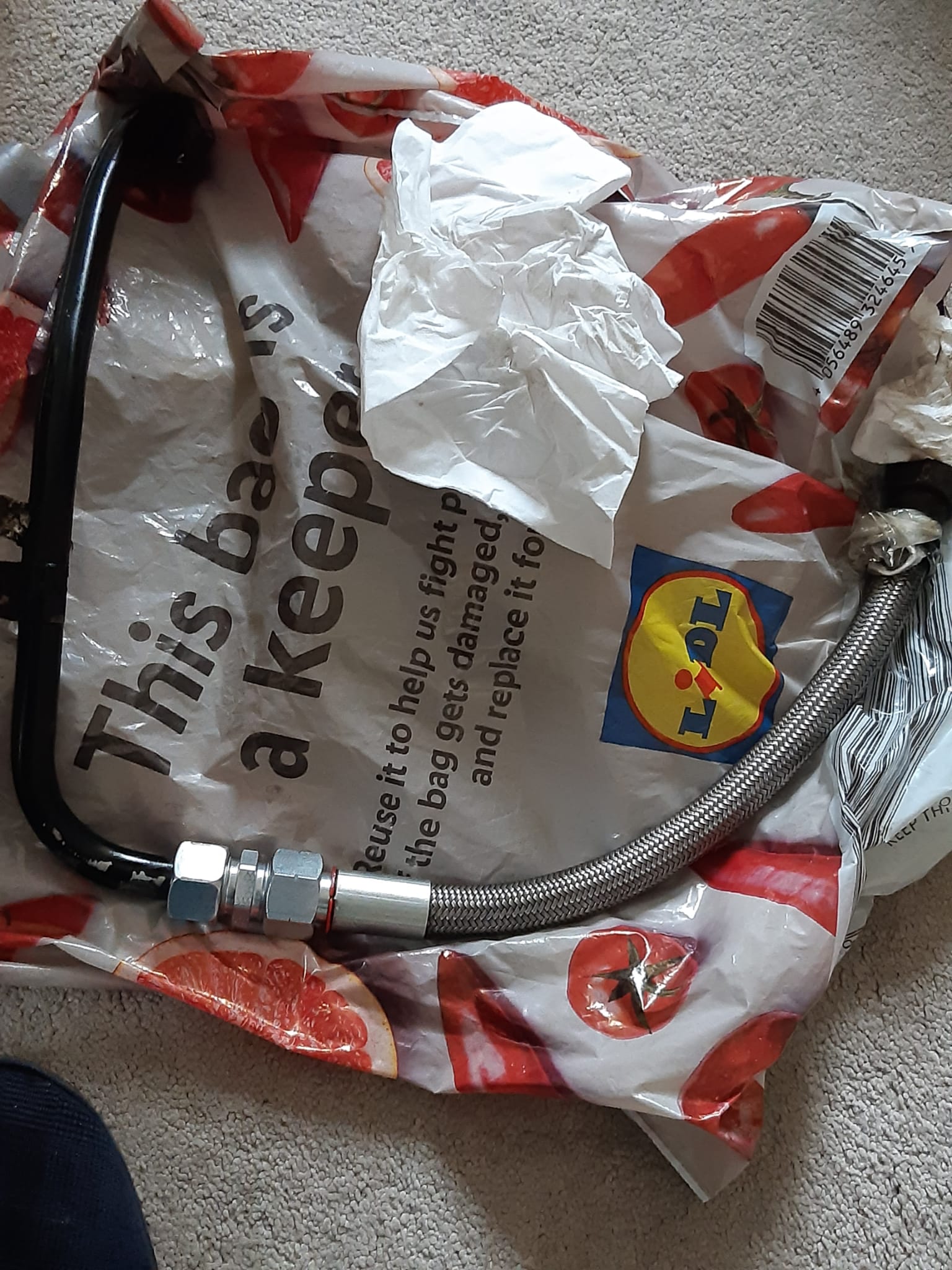

Hello Gents
I have just removed my engine and noticed that the centre connector between the hardline and flexi on the oil filter to oil cooler had pretty much rotted away , took it to Pirteck in liverpool and £30 later they have replaced the centre connector.Both ends were OK, it was just the centre connector that was failing.
Will update as to how it goes back on when engine goes back in.
Pic of repair below
