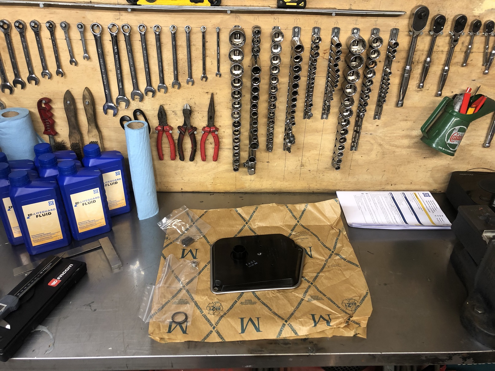

The ZF Kit. Note that you get new magnets and sump plug included.

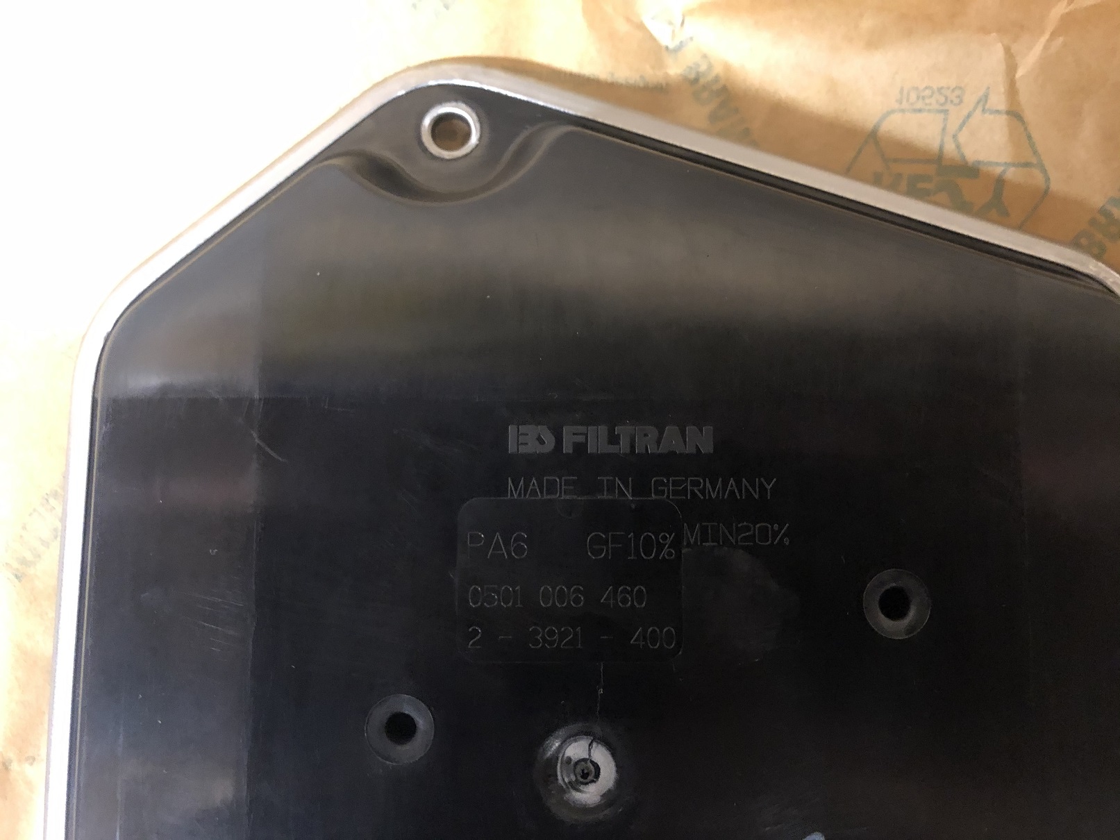

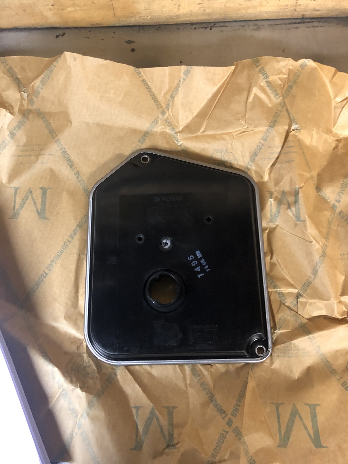

I remember someone asking some time back if Filtran filters are OK. Filtran is the filter that ZF use - must be OK.

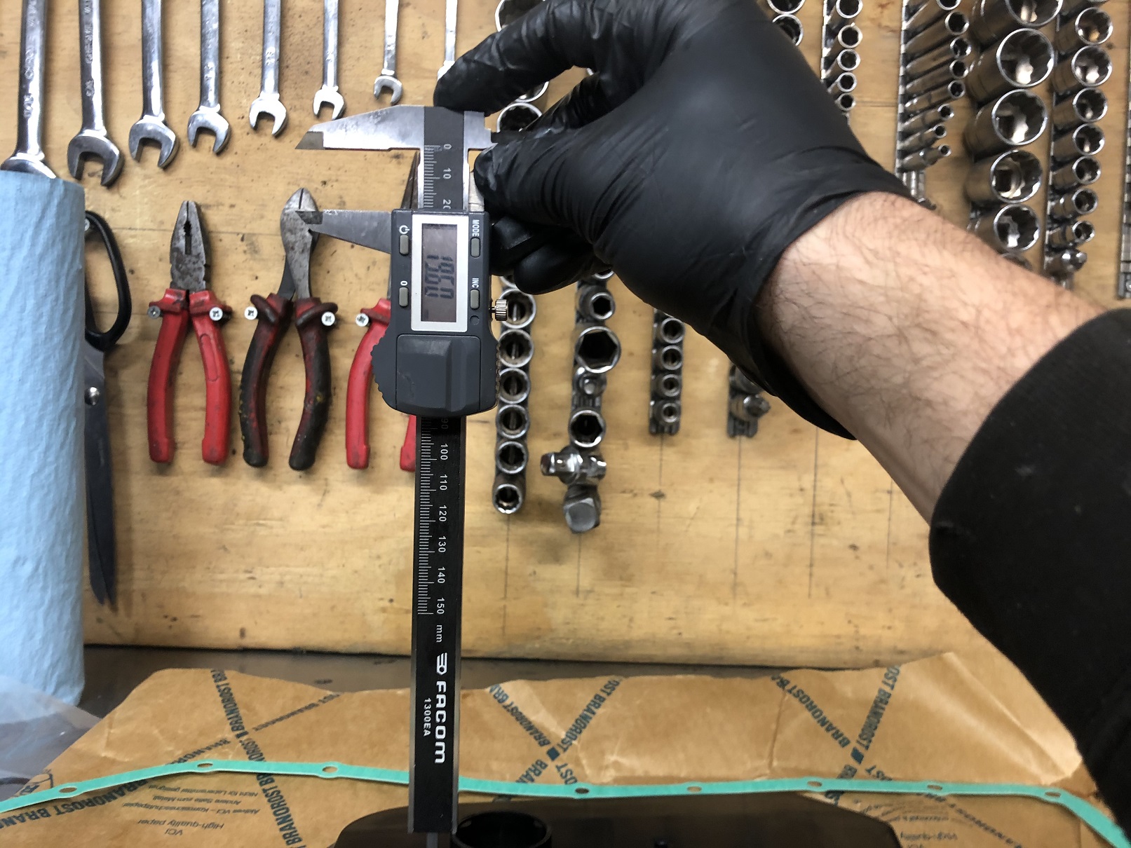

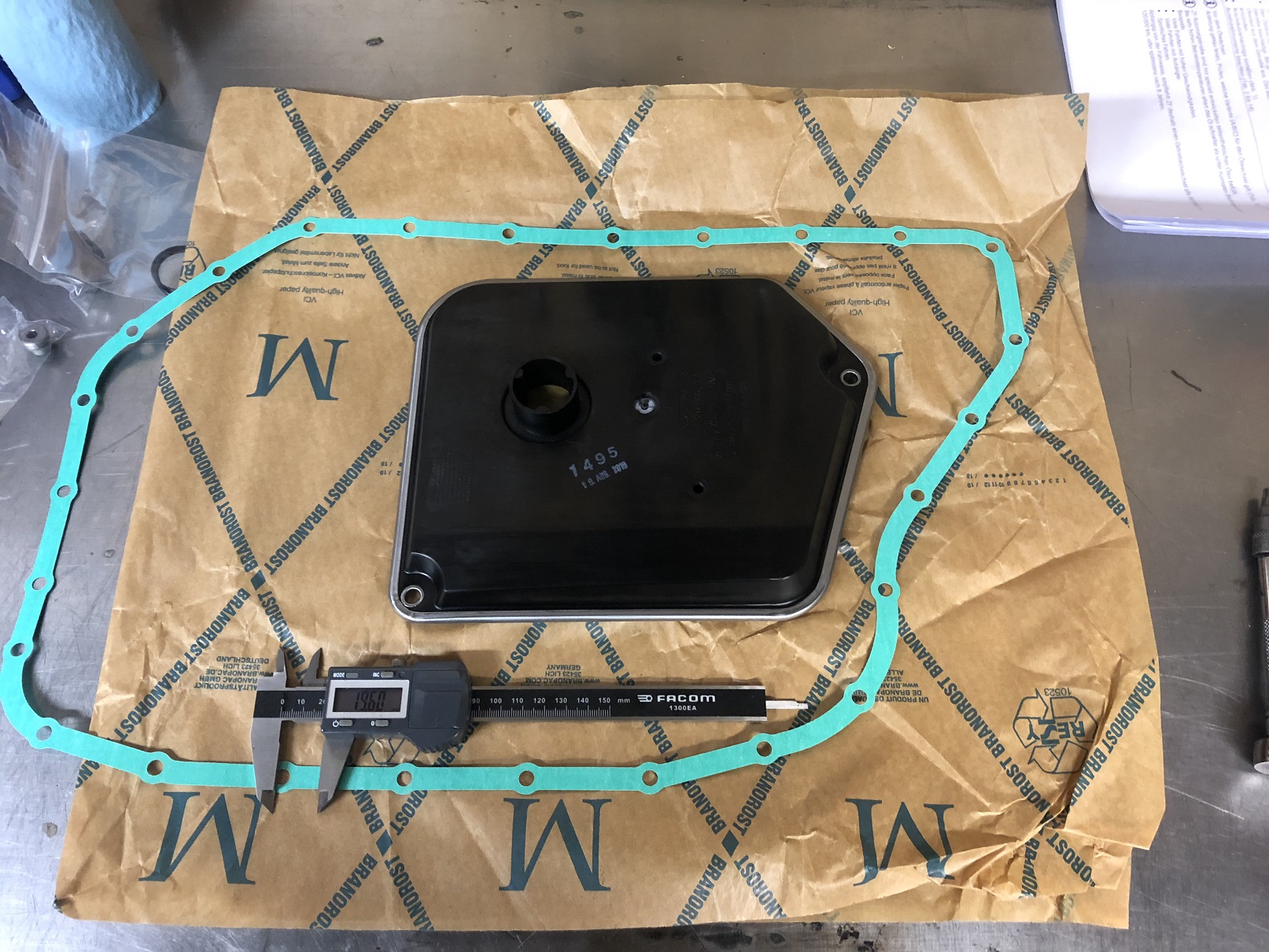

It's well discussed that the 5HP24 A should have the short filter - but I couldn't find any measurement to confirm what the right filter length is.
20mm is the (right) number. 25mm is the wrong (long) number.
The gotcha is that the long filter will just fit in a short sump - but with no clearance. Although I've never actually seen a long filter - do they still even make them?
