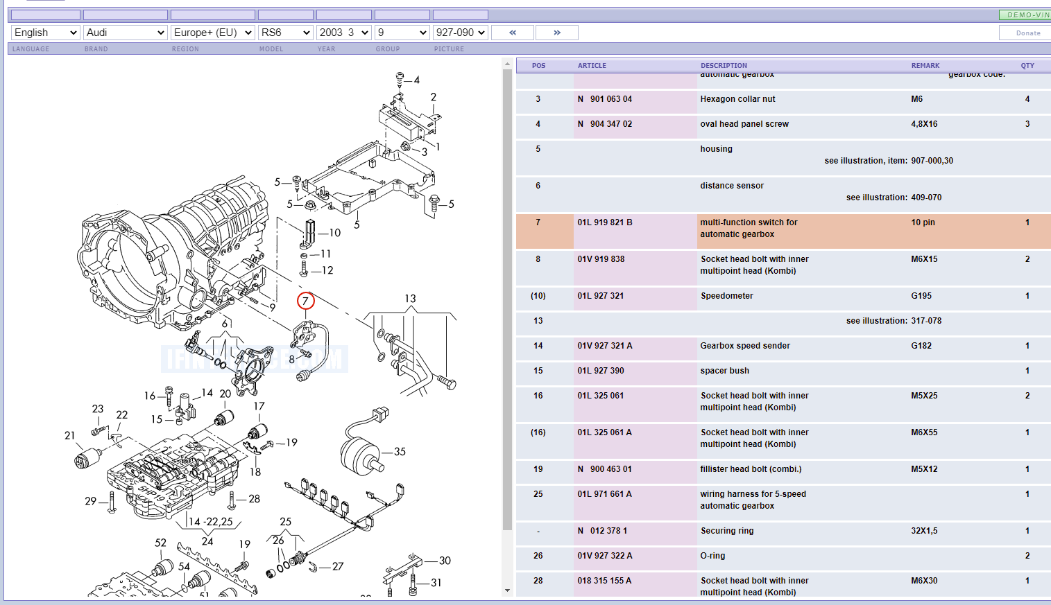

On the F125 switch, reading this forum the part number (seems to be) 01L 919 821 B, when I google it the results come up as 01V 919 821 B
Is that correct?

Post by Mɐʇʇ » Fri Nov 12, 2021 6:09 pm
Looks like there's still stock too, should work out about 180ish quid
Thanks - from Audi?
(Searching reveals two different connector types, one round and one oblong - both seem to have ten pins.
