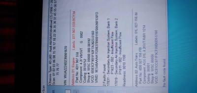

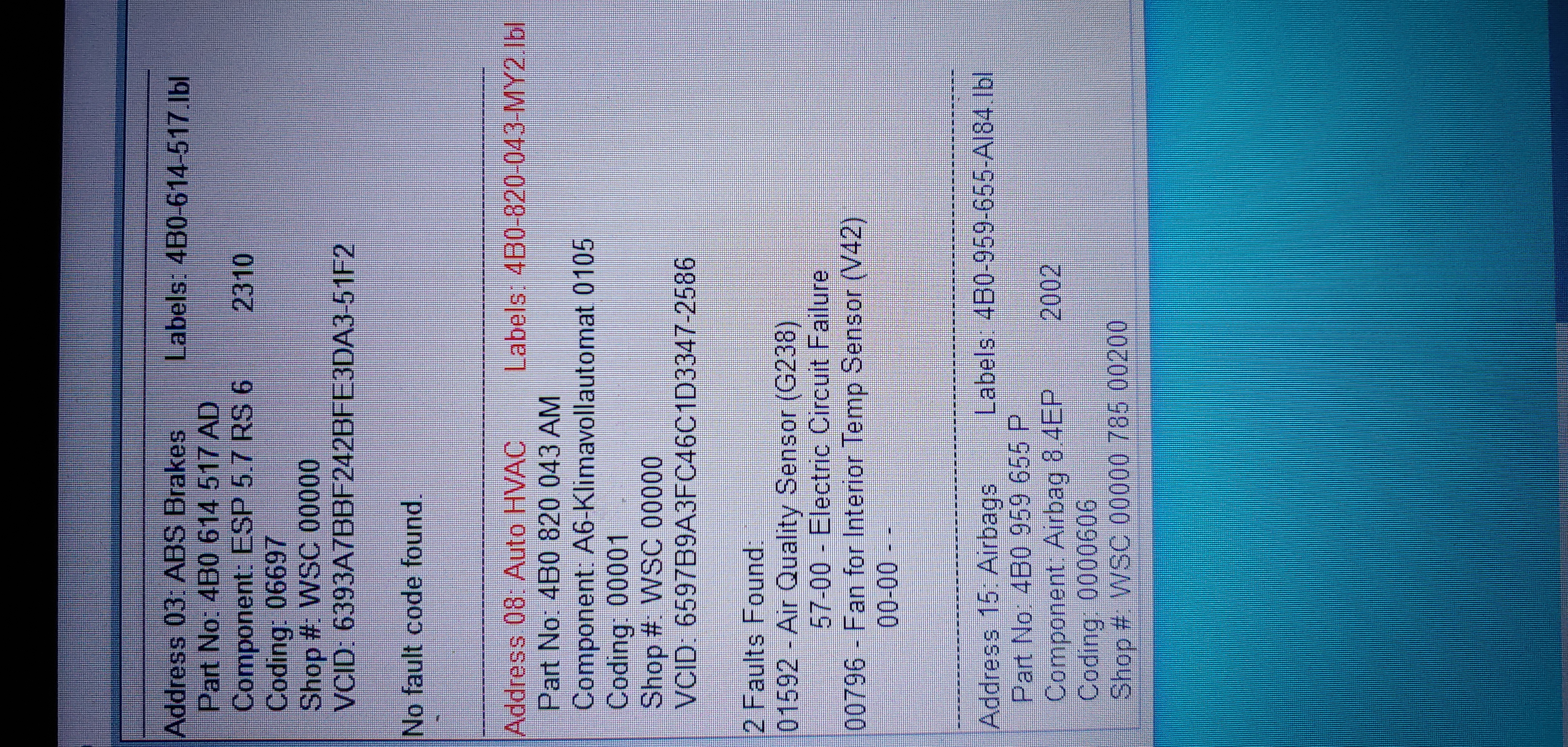

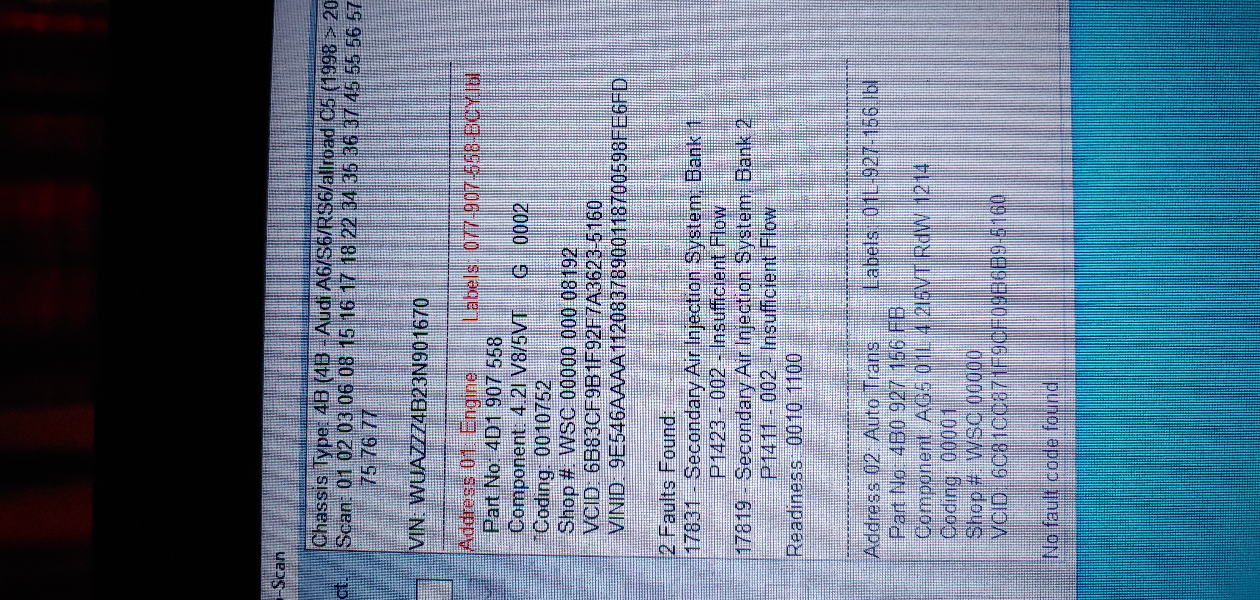

Yeah I was keeping it at a constant 70mph, the average went from 19 to 24.4 mpg. It reckons I was doing 29mpg on the long run.
Just rescanned after the 100 mile trip yesterday.
These faults came up:
Anyone come across these before?
Also does anyone know if it's possible to configure auto locking over a certain speed and also for the footwell lights to stay illuminated when the lights are on?
Thanks in advance :D
Posts: 20315
Re: New RS6 owner!
Post by Shoppinit » Fri Oct 29, 2021 7:03 pm
The air quality sensor sits in the cabin air intake and activates recirculation when it detects elevated levels of fumes. They are very weak and have short lives. You can safely ignore it if you want to.
Your SAI problem is probably the pump that’s failed given that it’s both banks and you don’t have mixture problems (or at least not showing yet). They tend to fill with water and corrode and then seize.
You can easily turn auto lock on with VCDS. It won’t lock if there’s a fault present with any of the door switches.
