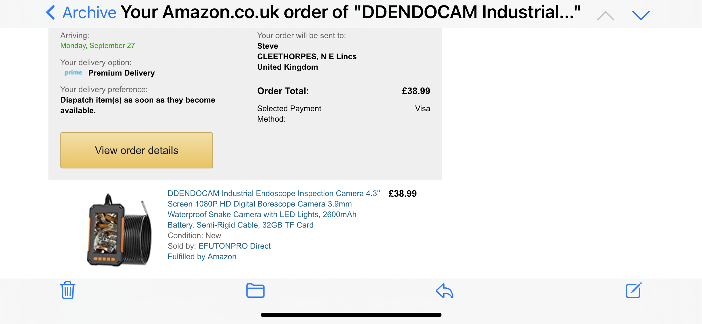

Thank you all for the response. And endoscope on order is the 1080 resolution with hand held screen.
Was only £38:00 worth a try at that price.
Will be glad to get to the bottom of it.
General diagnosis is the turbo oil feed pipe.
But it would be great if we can actually confirm it.

Which one did you get?

Hi Ben. I ordered it before I got your message.

Wow. For £38 quid I am amazed at the picture quality.
I can see me having hours of fun with this under the bonnet.
Thank you All for the heads up. This is a great bit of kit.
Hopefully we can now pinpoint and confirm where the leak is. And then get it sorted.
Took a while to figure out what each button does. And how to use it. But once you know, it is very simple to operate.
The instructions are all in Chinese.
