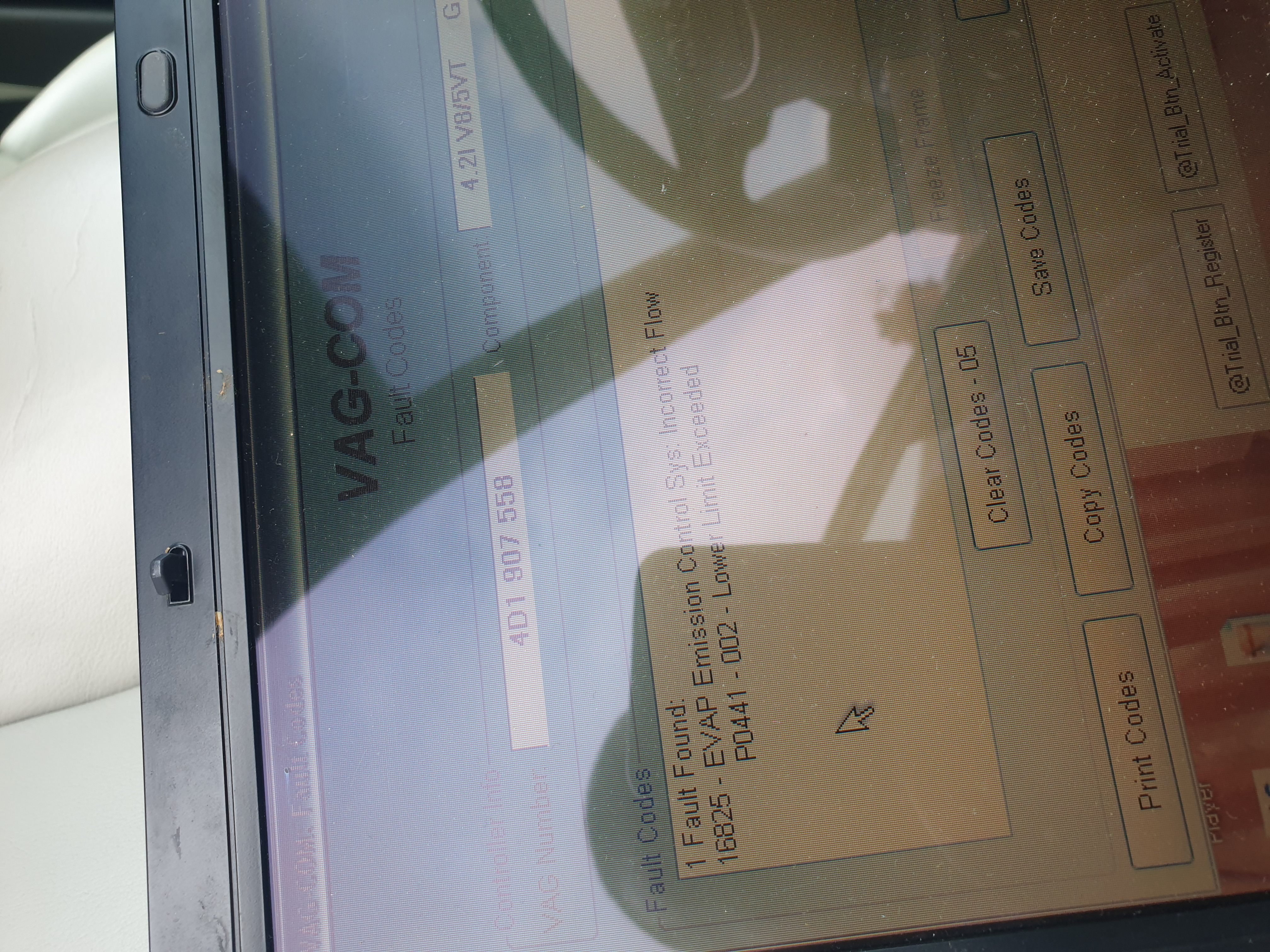

I've had the engine light come on a few times recently and every time it comes up the fault code in the picture. I clear it and its ok for afew weeks then comes back on.
Thinking of changing the N80 valve but does anyone have the part number please.

I think it's 077133517C.
But what makes you think it's the valve? Could be the carbon canister that's blocked. Or you could have a vac leak.
You can test the valve with the Vagcom output tests. I would do that first. At the very least it'll help you locate the valve from the clicking. Assuming it works, of course.

Morning mate,Shoppinit wrote: ↑Sun Jul 04, 2021 6:38 pmI think it's 077133517C.
It just seems the easiest thing to change first
One thing to add after a while of stopping an starting the engine while out driving it will be sluggish to start.

Is it possible to strip the carbon canister an clean it out ?
I ve noticed it only brings the light on once the car has been idling for awhile an also when the weather is red hot like it is now.

Is there measuring blocks I can to help pinpoint the issue ?.
I have had my DIS replaced and I can select groups while driving.
Re: Help needed with fault code
There is some stuff in block 70.
There's a basic setting for that group, too, which will start a test procedure.
Before doing anything, though, I would check that the solenoid is opening and closing (or at least trying to) using the output tests.
How do you perform the output tests ?
