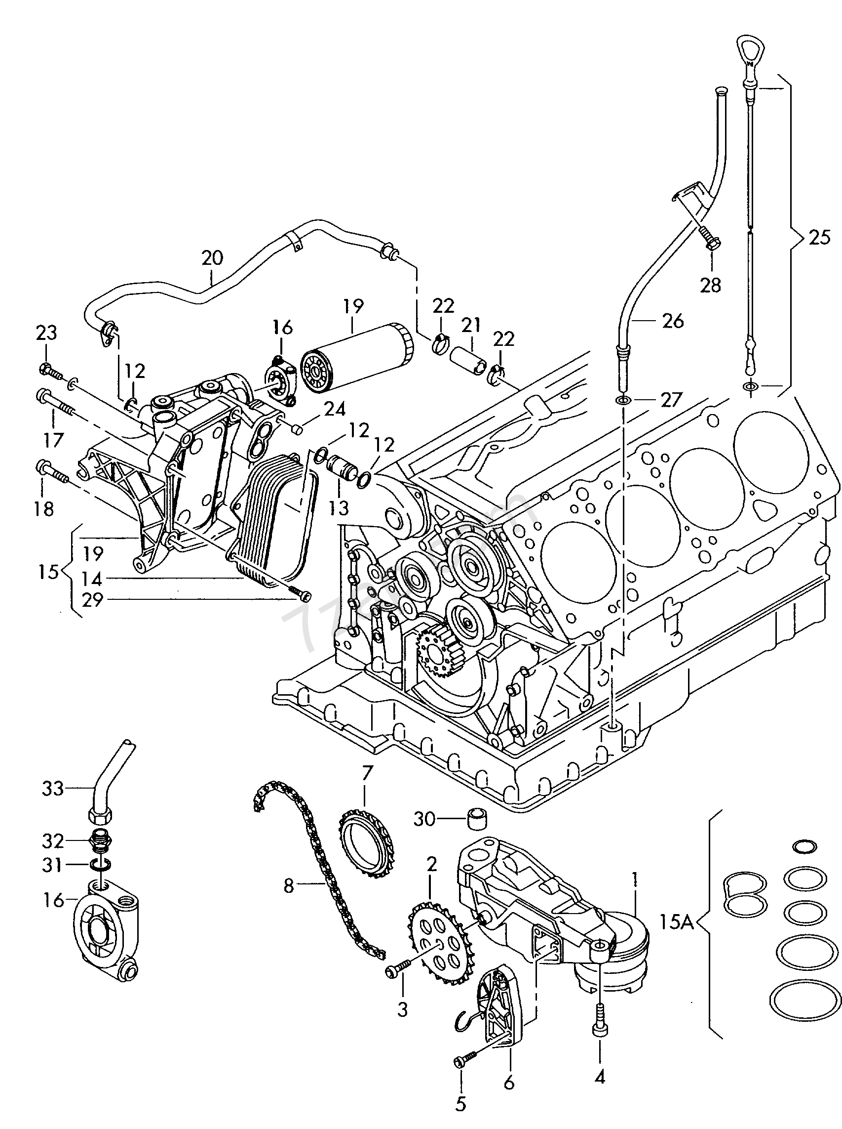

For the nearside front one, check the power steering lines - they run along there from the pump.steve2003rs6 wrote: ↑Fri May 28, 2021 6:44 pmBummer. Moved the car this morning. Two oil leaks.
One is near side just inboard of the front wheel
The second is around offside of centre of the rear axle.
Need to sort this sooner rather than later.
Bit of a pain as the car is driving beautifully.
Offside centre is going to be something in the filter area (its just above the ARB). For me I just needed to nip the oil pressure sensor up and there's a banjo bolt up there with a couple of crush washers.
Is your under engine tray on?

Sorry to hear about your problems Steve.... I'd second Simon's diagnosis : the filter area is a b**** and o-rings there tend to fail more often than not (been through this recently with the same symptoms).
You want to change parts 12 and 15A. Hasn't it been done when you had your bufkin pipe replaced?
