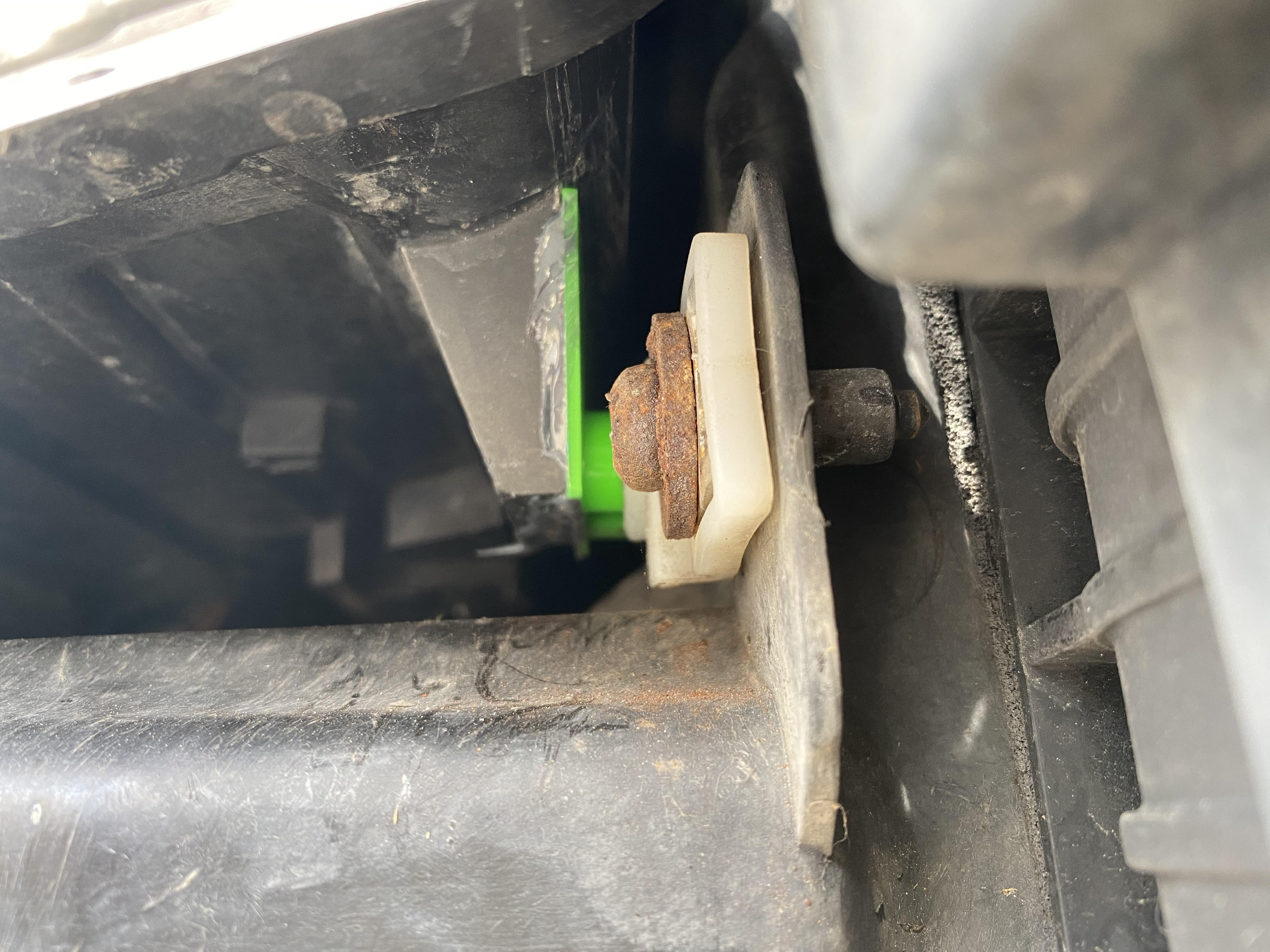

Thanks mark (if message was meant for me). My car is still at local VAG/MOT center after failing on unstable headlight, top fixings are fine but bottom two are broke, the boys at the garage think they can get repair kit but I'm not so sure, I've owned car for three years and only noticed when I replaced intercoolers in first lockdown. Sorry to hyjack thread.
I managed to 3d print a repair kit for the inner lower mounts:
I basically epoxied those on and they seem fine although they haven't clocked up any mileage yet...
I can provide the file if that's any help!

Ooo! This looks brilliant

That may well be a great solution to my problem, I'm waiting to hear from the garage early part of next week, thanks for everyone's help.

The garage has managed to fabricate a bracket for headlight, so has passed mot with no advisories, not ideal but best I can do. Thanks for everyone's help.
