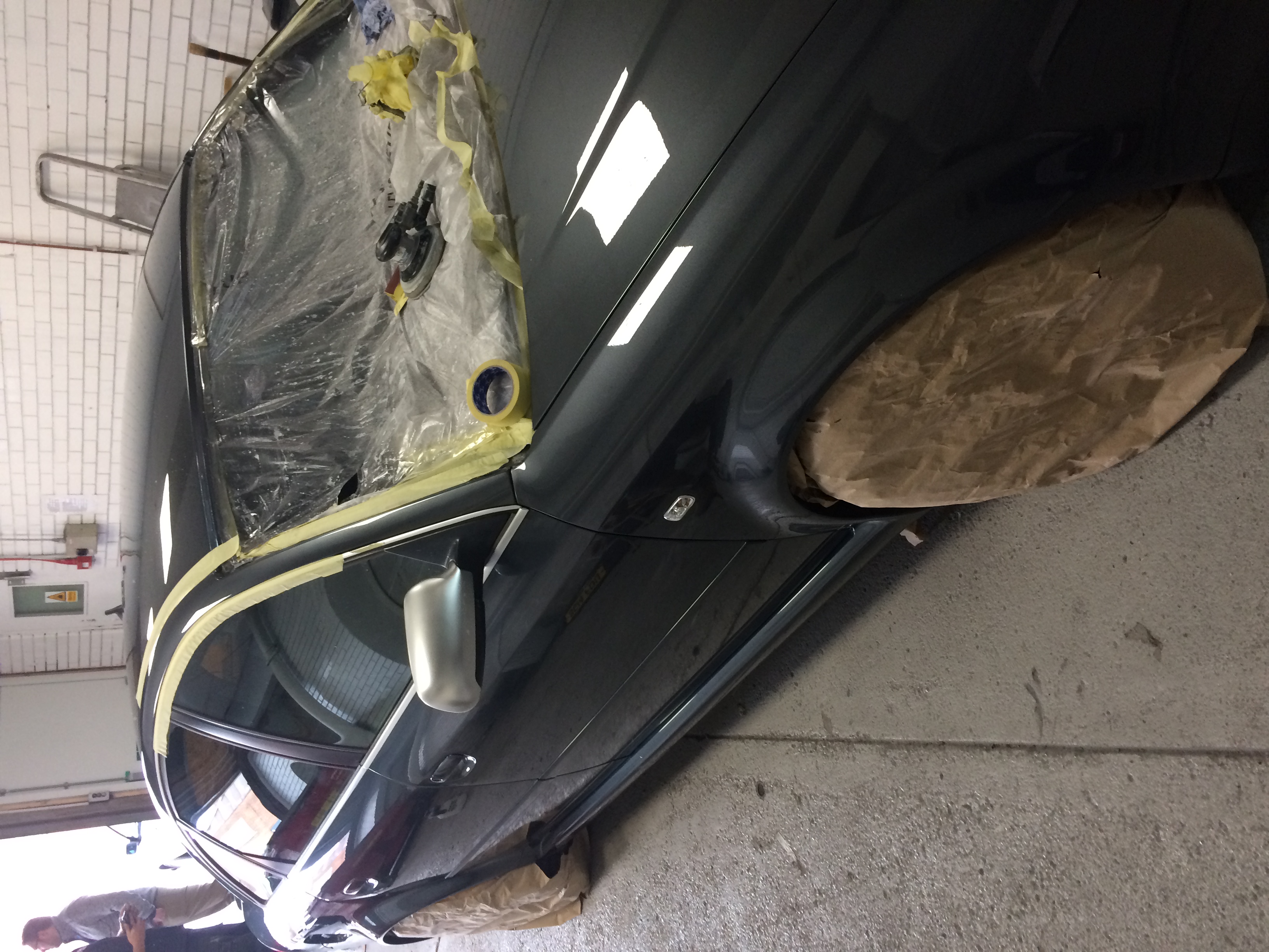

Had both screens removed to have roof rail repairs done and some new paint.
Took the opportunity to renew both screens.
After the new screens had been installed decided to Leave the car overnight to allow bonding to cure.
Next morning went to fill up with petrol and bang. Rear screen shattered and glass everywhere. Yet another screen fitted and should get my pride and joy back tomorrow.

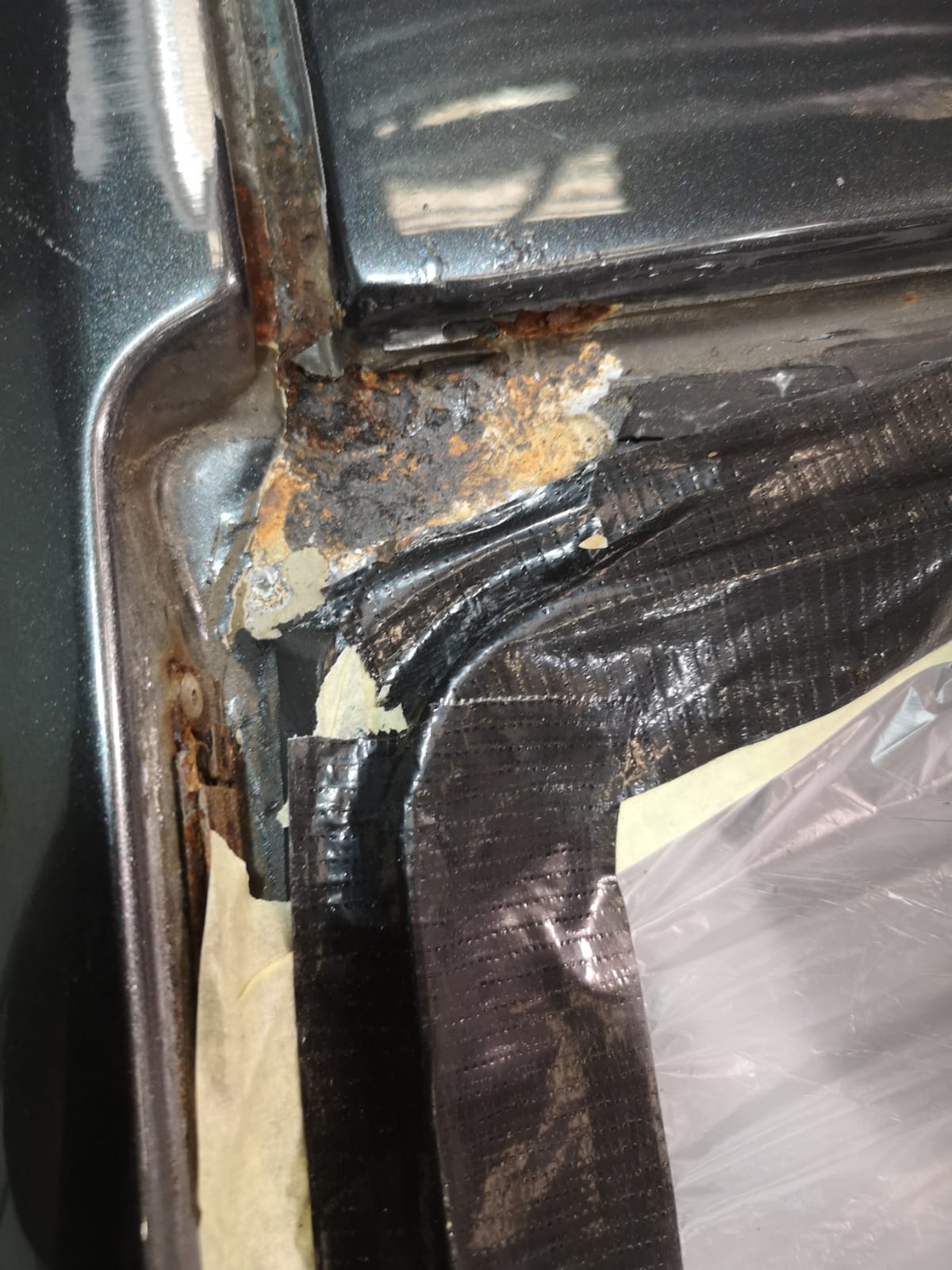

Ps this is why we took the windows out. So pleased we did as we would not have noticed the rust patch on top left corner under the glass.
Apparently just caught it in time for a effective repair to be done.
You can just about see the paint starting to bubble on roof front left edge on the second picture.

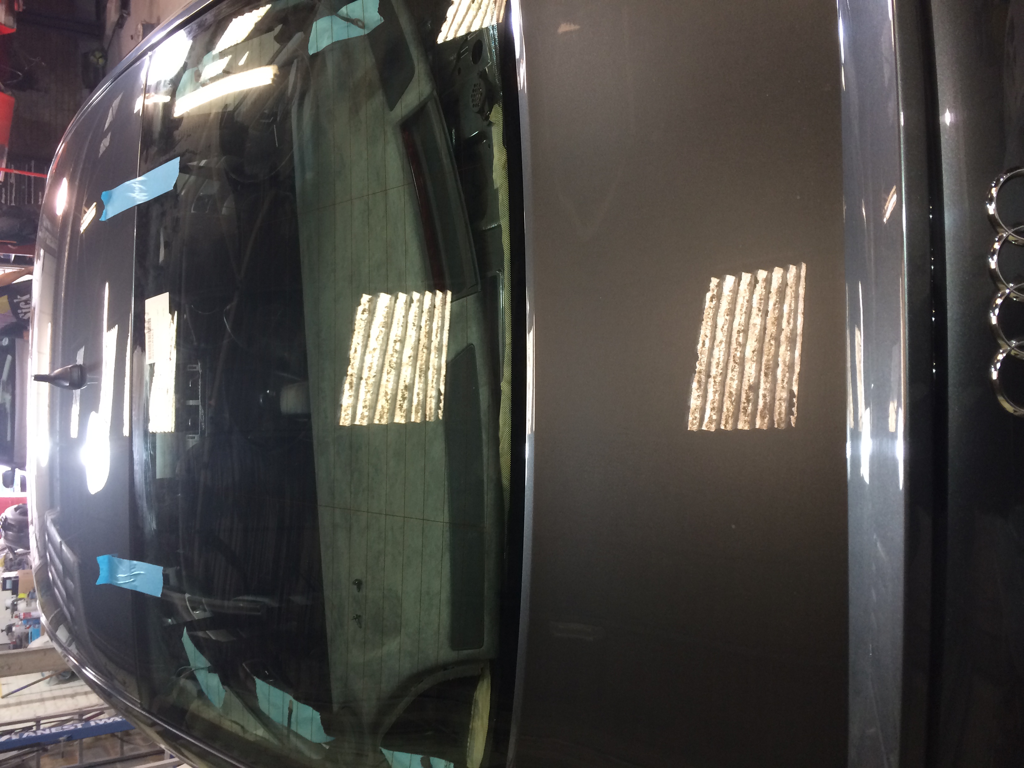

Repaired painted awaiting installation of a new windscreen.
