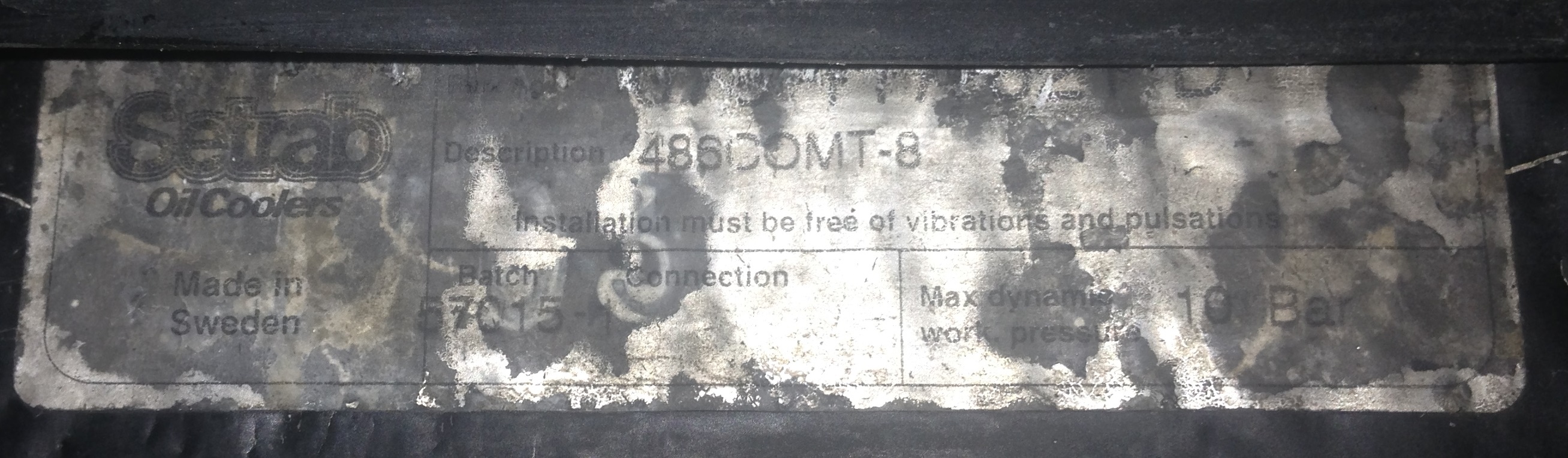

Classik, what makes you think it's Setrab that makes the OE one?

Re: DIY - How to save your oil cooler
In that case, maybe contact their distributor in France?

Edited - found the photo I took of the Sticker in 2014.

Thanks for the suggestions & recommandations folks, I'll try to educate myself on the TIG welding front, but it would probably lead to buying very specialized tools that will be used only once (we've already had this discussion, haven't we?
@Shopp: I just called the French Setrab distributor: nice person, he'll be looking into this for us (I've mentioned others could be interested), but he suspects Setrab keeps these specific coolers for the 'official' Audi OEM distributors. More later.
