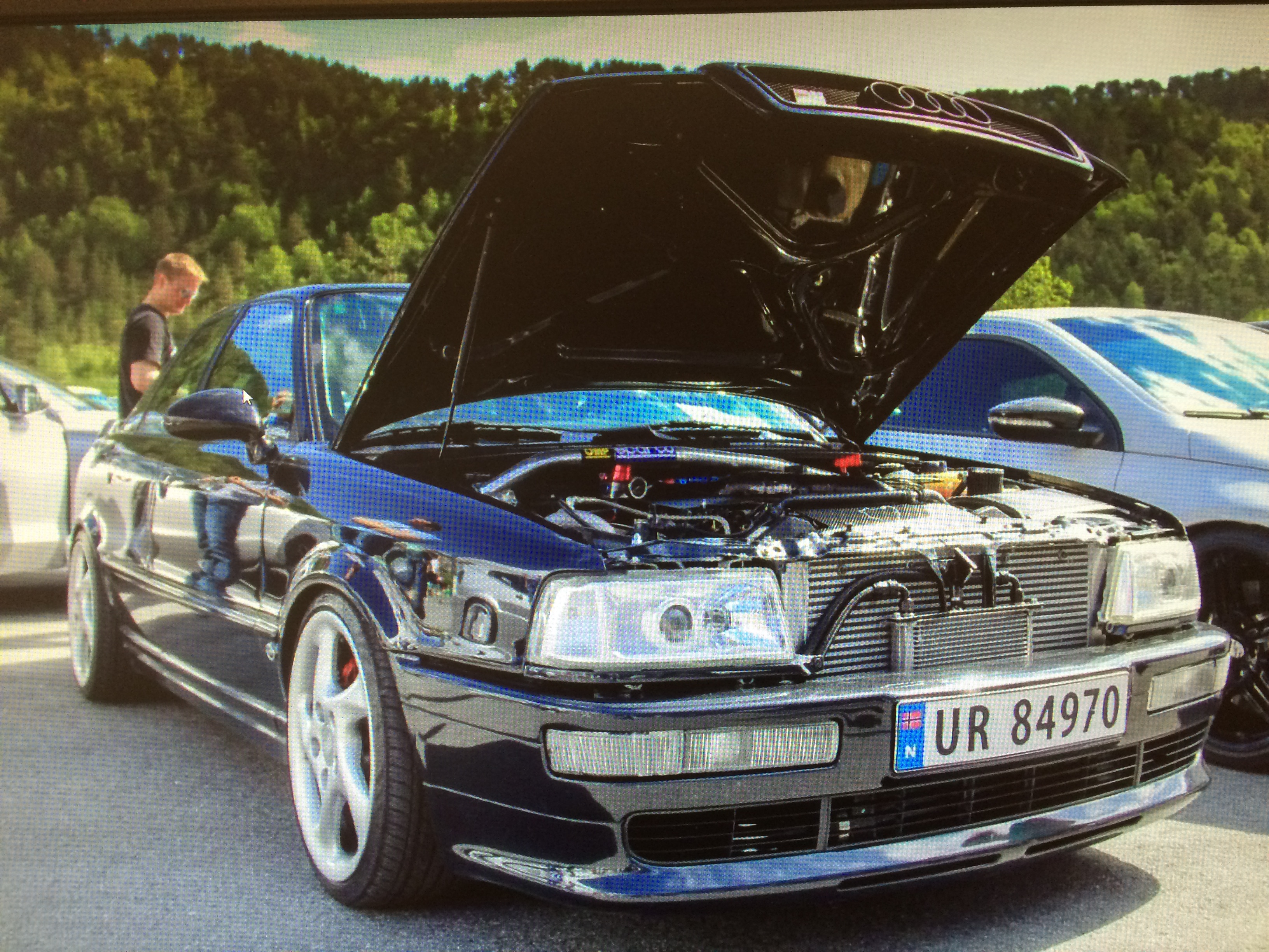

Nice Project!! I put the same gearbox (01e) with the same engine (bcy) in a 94' Audi 80 competition a few years ago. Without damage anything in the engine room. I will follow this Project:)
