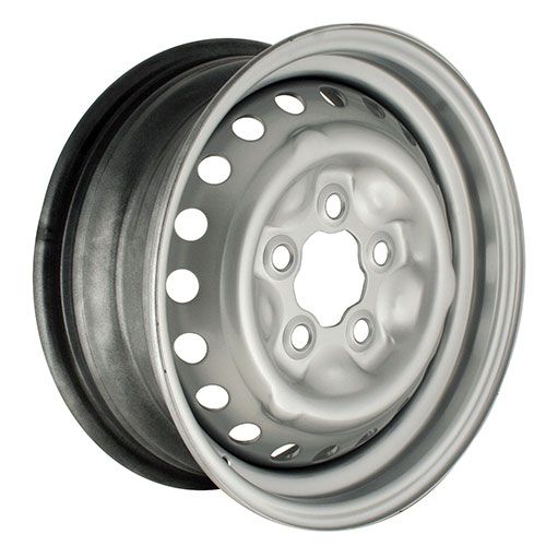

While I agree that it helps... Vital is not the way that I would put it... otherwise OEM manufacturers wouldn't have done this.Shoppinit wrote: ↑Mon Jul 24, 2017 12:33 pmI strongly dispute this.RS2 wrote: ↑Mon Jul 24, 2017 11:29 amSorry to point this out... but... (this is my understanding of it... that's all)
The wheels are centered on the wheel bolt head and recess design in the wheels rather than on the spigot itself.
The spigot is simply there to allow you to line up the wheel bolts easily.
Once you have torqued the wheel bolts up fully, the centering spigot performs no function whatsoever.
Personal experience has also shown me that the spigot is vital in centering.
These are from my 1990 T3 van. There are other vehicles that came without spigot centering and there is usually a mm or so clearance around the spigot. As you've pointed out, once the bolts/nuts are tight the spigot is redundant.
MG
Re: Bolts anyone??
Maybe with the conical bolts the centering is better without a spigot to ensure alignment. Or maybe any application that can use steel wheels doesn't need good centering.
Either way, on the RS6 with OE alloys the spigot is vital for correct wheel centering.
