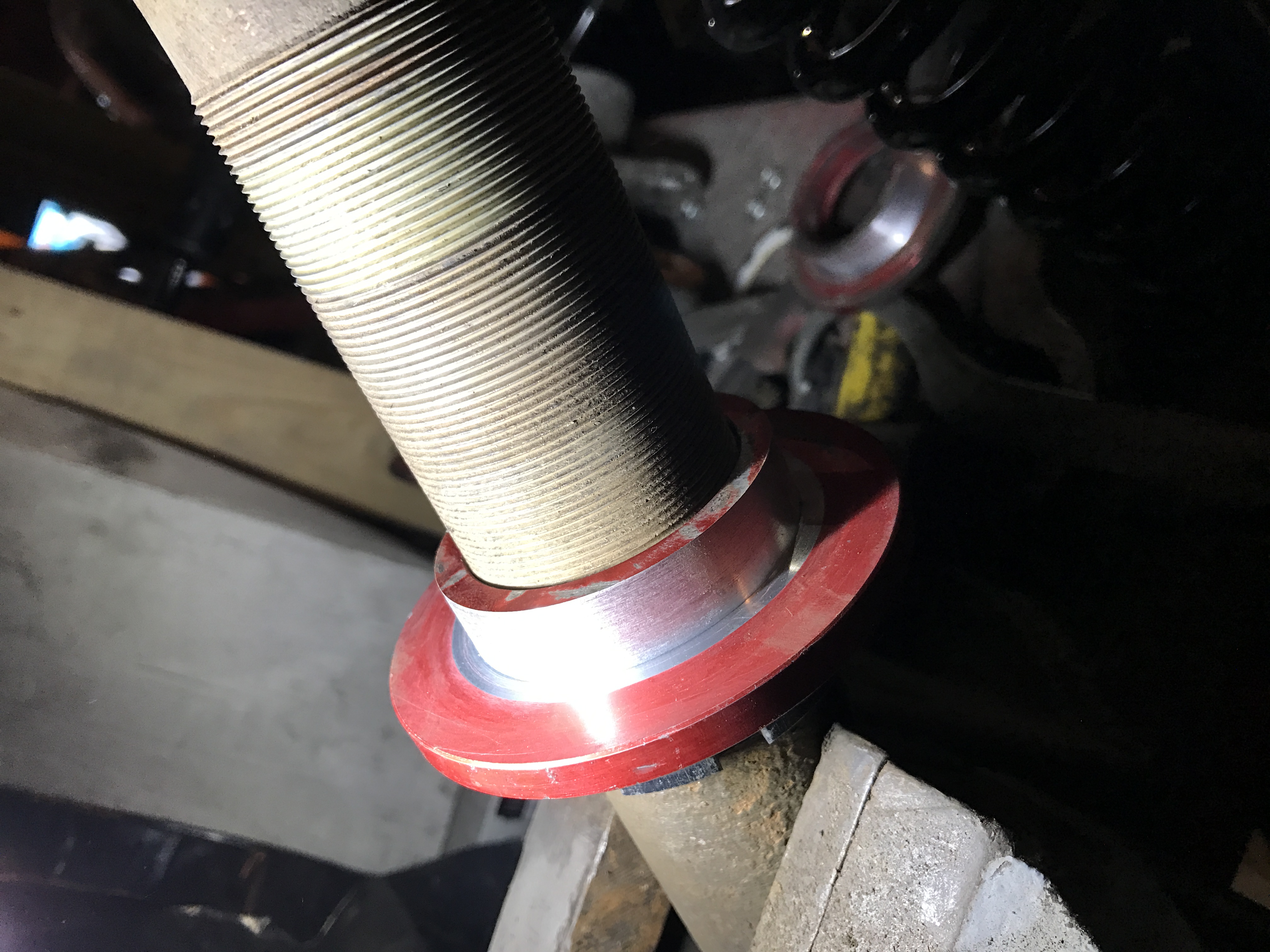

Spring rates based on PSS9's, required some machining of spring perch and had to have some custom top cups made as the H&R shocks are too long in my opinion.

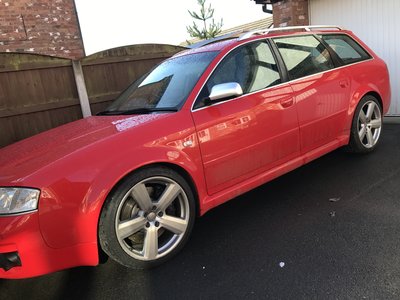

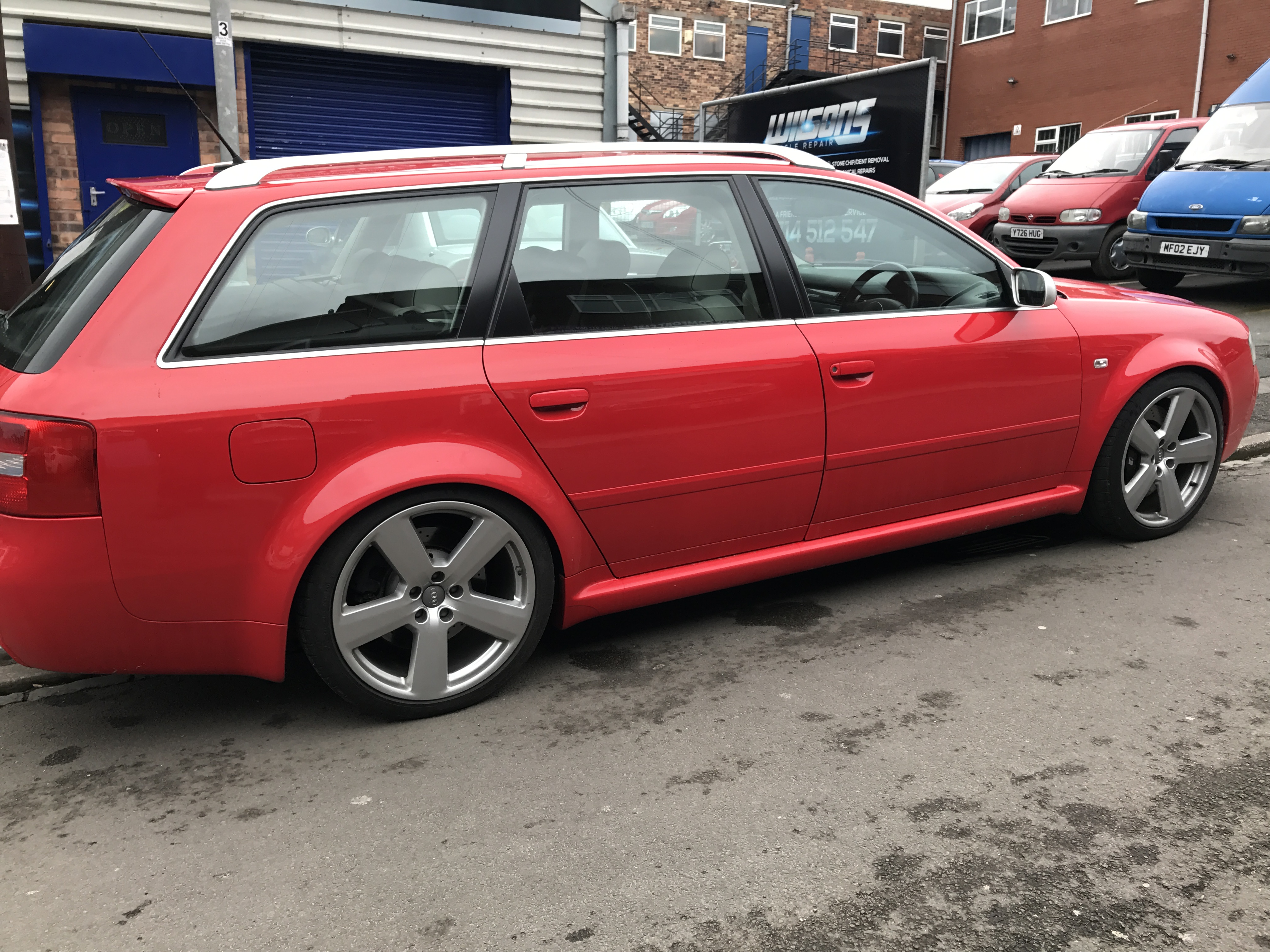

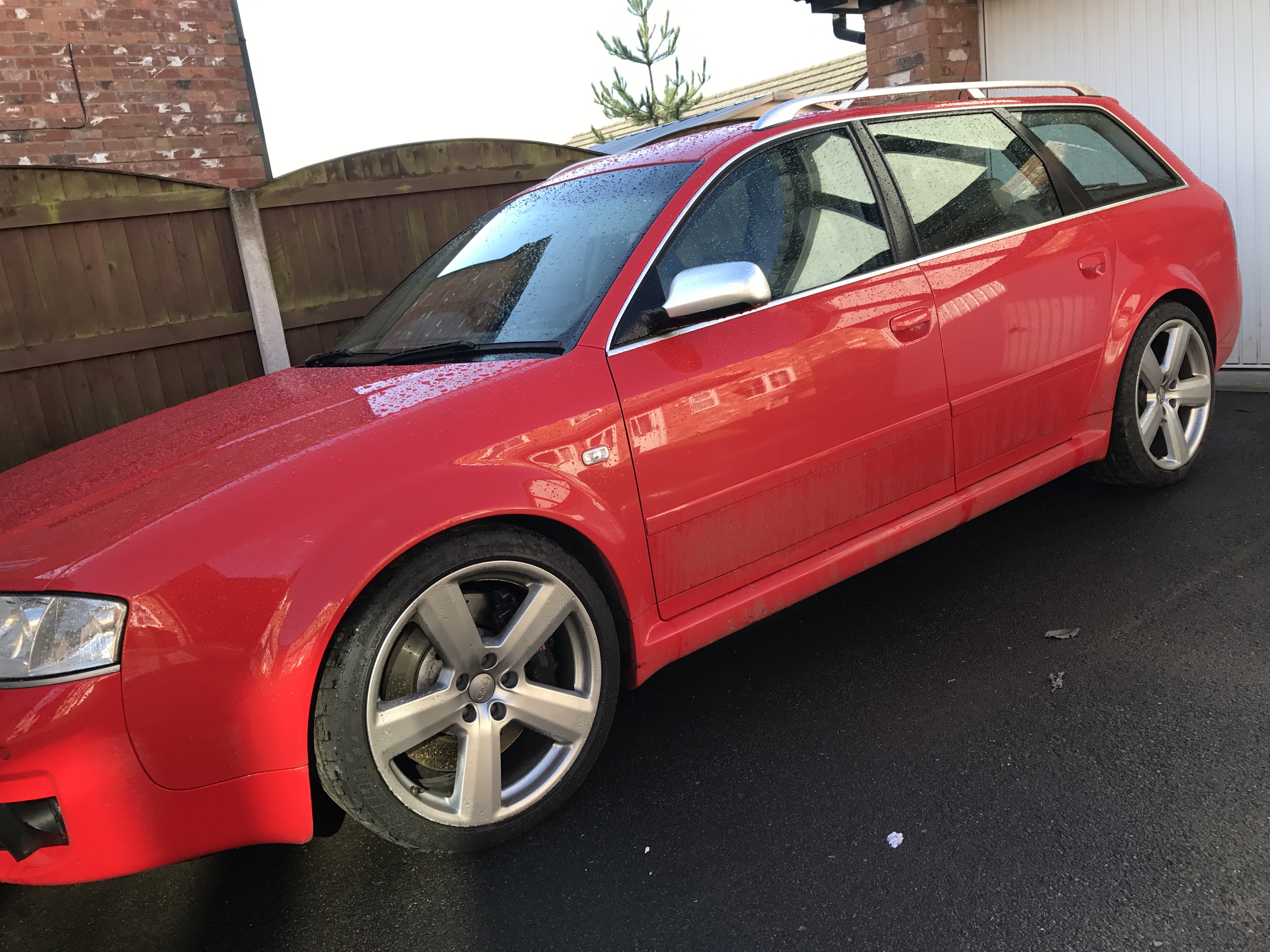

Managed to achieve DRC ride height, comfort is second to none in comparison to the H&R's, handling is vastly improved and you can put 3 20stone body's in the boot and get very minimal sag.

Before
Before
After
After
Perch machining
Perch
