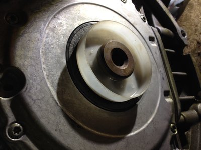

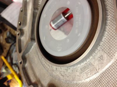

You have to be careful when putting these seals on over the crank shaft, otherwise they can flip in the process. They have an outer seal on them that hides the inner seal, so you can't see if it flips. The Audi rear seal plate comes with a plastic tool for sliding the whole thing smoothly on to the crank shaft.
Plate, seal and plastic tool, viewed from the inside so you can see how the seal is pointing inwards to seal more under pressure. Viewed from the outside with the plate and seal going on.You can see the outer seal which hides the inner lip.
