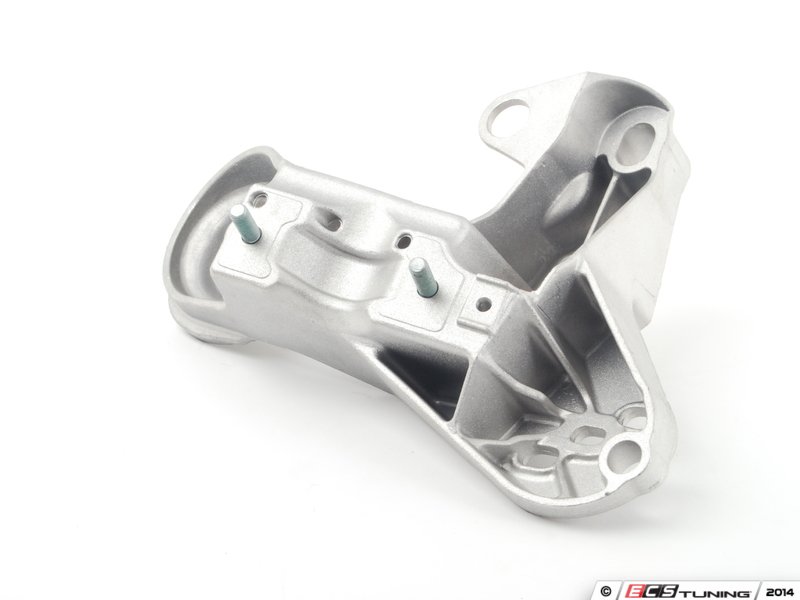

You could either get a new console*:
4B3 199 351C (left) or 4B3 199 352C (right)
Or remove it from the subframe and get it machined with a new stud.
*You'll be pleased to know they are quite cheap but you will probably need to get the geometry done afterwards.
