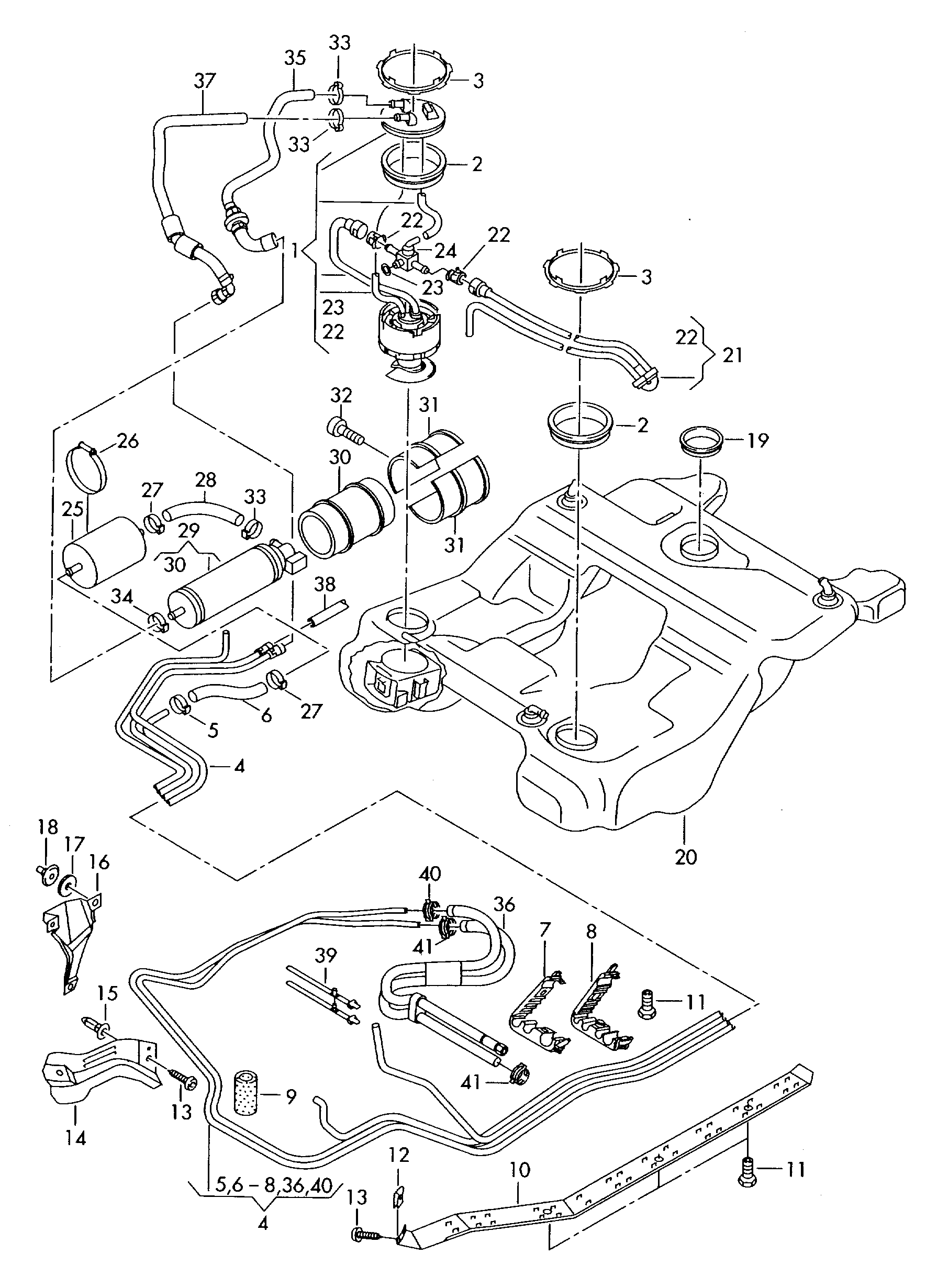

Looks like I got the wrong thing...
What I need is nr29 on the picture http://audi.7zap.com/en/rdw/audi+rs6+rs ... 201050/#29
And that VDO is Nr01 http://audi.7zap.com/en/rdw/audi+rs6+rs ... -201050/#1 So the fuel pump is outside of the fuel tank... Isn't it?
Everyday I learn how RS6 is different from all other cars I had (A6, A6, A8, S8...)
So where do I look for the fuel pump? Is it outside of the car, underneath the floor? where the filter normally is?

The fuel pump is located in the tank (G6). The one on the outside is a transfer pump - G23 (presumably due to the shape of the tank).
Try and get a copy of the study guide which shows how they work - I have one, but you might be able to download one from somewhere.

that means there are 2 pumps? If I have fuel pressure issues, which one do I change?
Ok. found it. Studying...
(If somebody needs a link - http://www.s4-mtm.com/images/RS6-C5StudyGuide.pdf )
