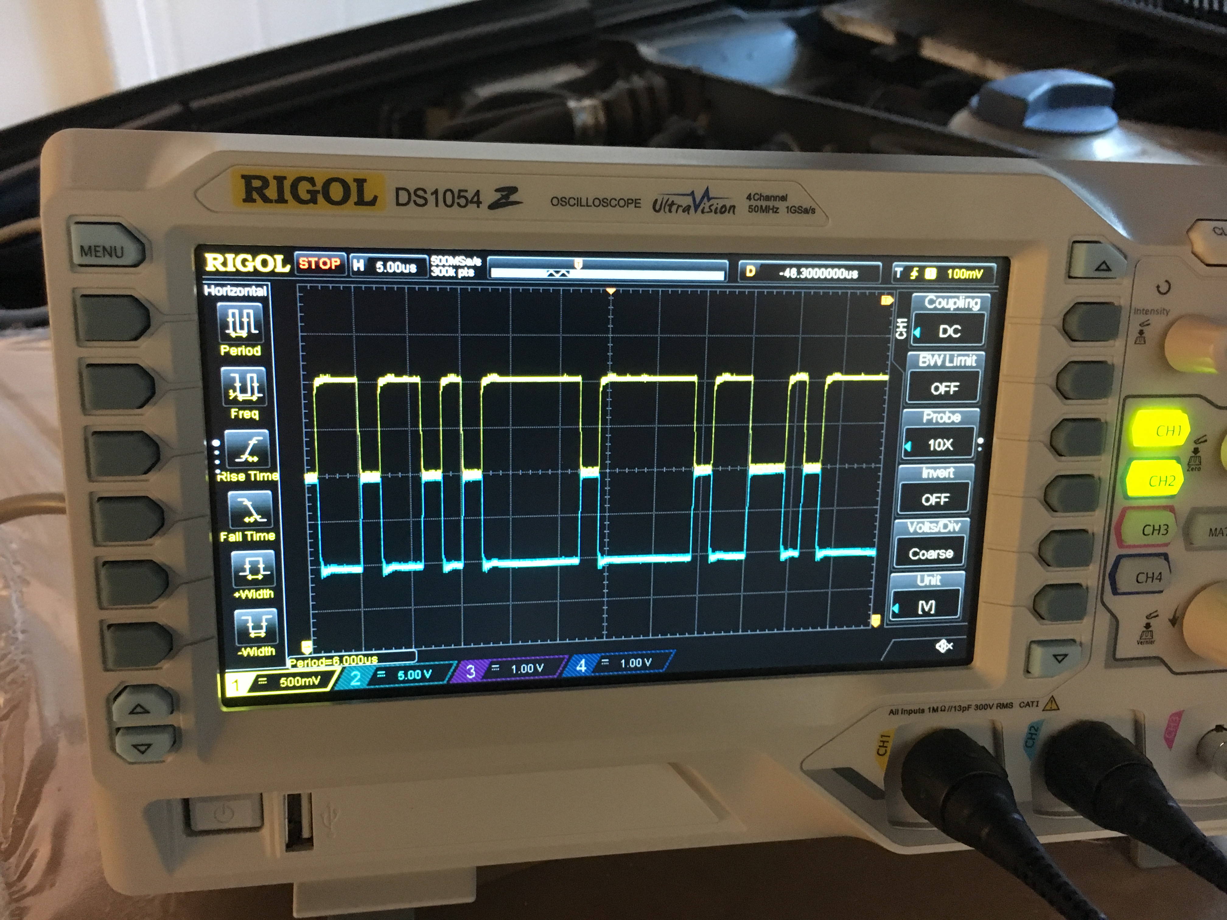

I checked all the basic stuff yes. Just no spark and ignition. All the other things looks fine. Power and grounds all are fine to. Also did a measurement on the cambus as is had a code in the instruments but the signal looks good to me.MadttV8 wrote: My money:
