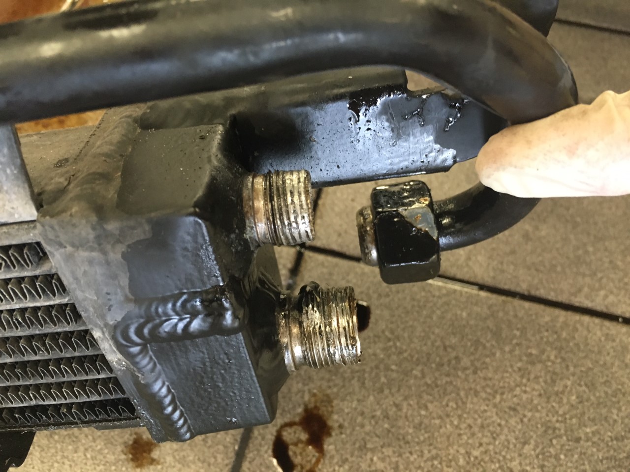

Having my cambelt and a new radiator fitted to my RS6 C5 Plus. Decided to take it to my local Audi dealer rather than indies. MRC were out if it due to busted radiator and distance so I went for thee next best option.
Cambelt done, no problem but the oil cooler pipeworks so corroded not able to refit ( alu on alu fittings don't work and i'm not an engineer)
Anyway Audi parts are £1950 and with the other costs I need to remorgage.
Question is, has anyone sourced cheaper parts or had a local enginee fabricate the parts cheaper than the costly Audi ones?
Have to say the Audi garage have been terrific and are sending photos of the parts and part nos which i will add later.
Any suggestions much appreciated.
Now have these images

Looking at the pics above, a bit of careful use with a needle file (with the end's plugged with some blue Shop towel - not a rag) wouldn't go amiss.
Also looks like you may need to replace the hard line with a hose too - shouldn't be too much of a big deal though.
Re: oil Cooler pipework
Looks like the top thread is mostly stripped. Maybe damaged inside the nut, too. That's probably why Audi don't want to fit it.
Sounds like they're charging you full retail for parts. Maybe try negotiating the price down a bit?
Or you could try recutting the threads but I bet Audi won't want to do that.
I wonder why they removed it. Don't think it has to come off for either cambelt or rad but haven't checked the procedures so could be wrong about the rad (but not the cambelt, definitely).

You should be able to have the oil cooler reworked by someone with a little welding talent - cut the old ends off the cooler and fab some new ones.

"Reworking" - yes, technically possible. I know a man who is an awesome fabricator & tig welder. But I figured, to cut the end off would be with a hacksaw, which'll create lots of debris, some of which you won't be able to avoid getting inside the cooler. And debris in the the cooler is a bad thing.
