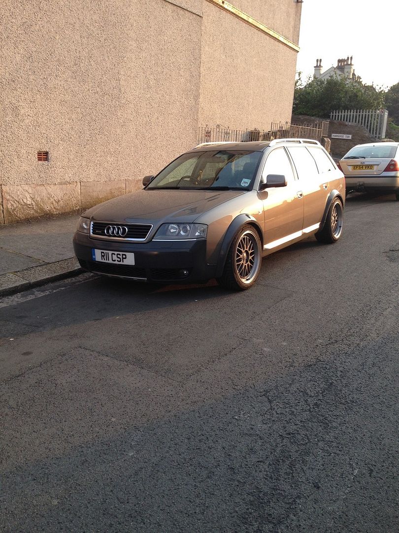

Hi all just looking for some information on rear lower wishbones, basically I have an Allroad which uses the same lower wishbones as the RS6 but they have slightly different part numbers-the rs6 has an extra letter at the end.
I'm hoping that the shock mounting point on the rs6 ones is lower than those as standard on the Allroad but I can't find any information on this.
I'm trying to achieve a higher Spring (airbag) rate whilst running at the same height I want to lower the shock body as its very boaty when lowered because the computer runs the bags at a lower pressure to bring it down. By lowering the shock body I can increase the damper and airbag pressure and when combined with the RS6 arb's I've just bought hopefully it will be a lot better. I know it's not a performance car or anywhere near the standard of all yours but it suits my needs and I do like it. Image

Can't really help with the wishbones question, but that looks like a very clean example you've got there!

Thanks! That was before the wife used it for 9 months when we had our son before I bought her her own one! Needless to say need the wheels refurbished again lol!
Can't wait to get your arb's and exhaust on. Also have a big brake conversion to do this weekend from a 6.0 A8. It should stop now!!
Just working on custom shocks to update the ride.
