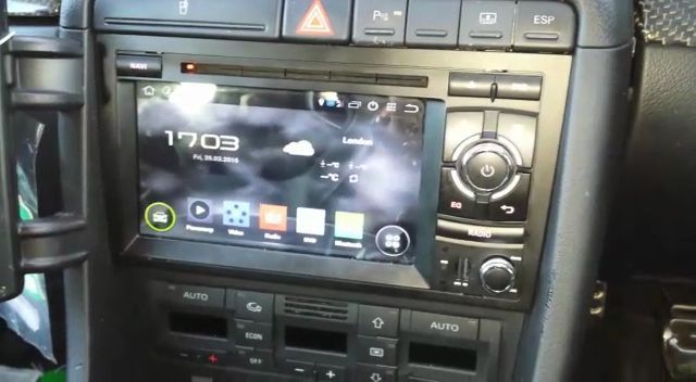

I have an android in my RS4 got sick of the RNS-E
I have not made a great video but heres it working and no you don't need a keyboard at all
Something like this will do and you can update the firmware
http://www.ebay.co.uk/itm/AUTORADIO-DVD ... Swo6lWOg45

How do you find the DAB broadcast quality? I've heard that even with an auxiliary aerial the signal drops out more often than in comparison to a factory fitted DAB aerial which might be meshed into the windscreen for example.
